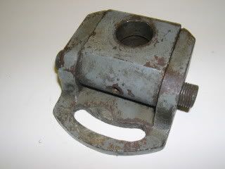

    Shown is the clapper from a just-acquired early model Atlas 7" shaper. I'm taking everything apart for cleaning, and this has brought me up short. The clapper is held in the swivel by what appear to be two 5/8-18 studs. My only idea is to double-nut them and then unscrew them. Before I bugger up anything, though, I wanted to get a reality check from anyone who might be familiar with this machine. Any ideas? Thanks in advance.
    It's non-standard, and anything may be there.
    It SHOULD be a tapered pin, with threads at ONE end.

      I was going to say the same thing about the tapered pin. I'd say thread the nut on and tap with a soft mallet and see it it moves.
        I didn't take that all the way apart, But it does develope more play if you move the bolt in one direction and snugs up going the other way, so it behaves as though it's tapered.
          Well, maybe you meant 5/16-18? Dunno about the OTHER end, but one end SHOULD have a 5/16-18 thread and nuts on it, although yours does look bigger in the picture.

            I believe that is the shaper I gave to Kendall. It is a very early Atlas, different in several respects to the later Atlas shapers most are familiar with. There were several different castings as well as the clapper being different.
            I can offer no clues as to how it comes apart, but I would suspect that it is one piece.

              JCHannum-- It is indeed the same machine. It was more complete than I expected, and I hope to have it running in the not too distant future. Will post pics when I have something to show.
