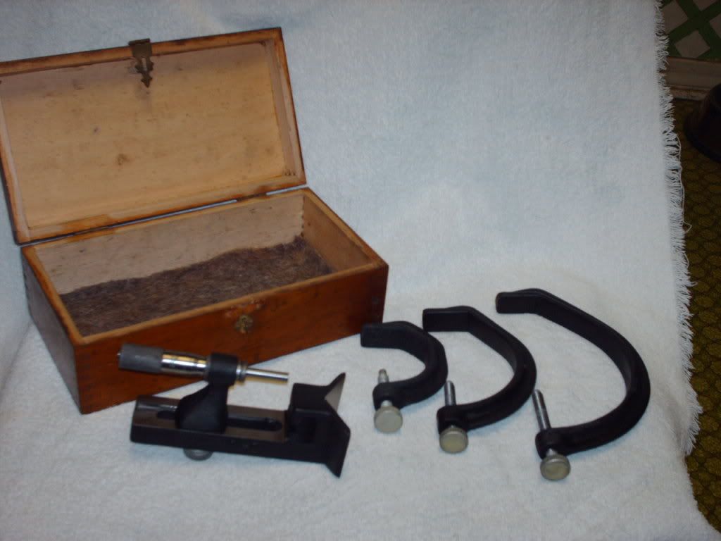

    I picked this up at the flea market in Clearwater a couple weeks ago for $5 and saw one similar to it in a thread on this forum last week. JC Hannum posted a picture of his so, since I have now gotten the hang of photobucket I thought I'd put it up for you all to see. I think that this tool will come in handy for shaft work and possibly side flanges on pipes. For the price I could not turn it down.

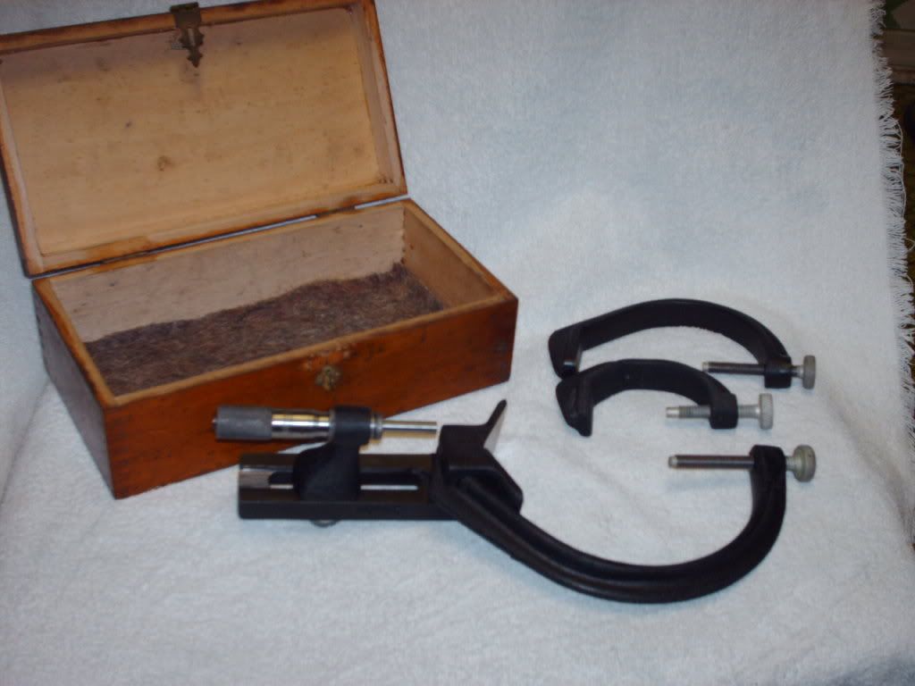

    And here it is assembled with the clamp, which fits into a tee slot on the back

    Looks ideal for setting the tool on a between centres boring bar.

      It doesn't look like it needs turning down, or would help w/ that process, but boring things out - that's another matter :-).

        Nice find. Up until now, the only one I had seen was mine, which was a shop fabricated item. The commercial unit is slicker and the clamps add to it's usefulness. Is there any hint of a manufacturer's name or identification?
        I don't know the use for sure, but mine gets used for setting cutter protrusion, and works very nicely for that purpose.

          There is no name on the casting but there is a number. On the side of the Vee block unit there is a D-101 cast in and on the micrometer head, a Starrett, is the number 263. I don't know if the Starrett number referrs to the micrometer head or the whole tool, however.

            I believe the tool that you have is part of a boring tool used to enlarge the cylinder bore of engines. Thus you can rightfully and the popular word "vintage" to the name. (Proper name I'm not sure) A long time ago (I'm certainly dating myself!) you could get someone to come to your driveway and bore your engine cylinders out to the next size. A house call machinist, as it were! This tool was used to set/advance the cutting tip on the boring bar used in this boring machine. If you only had the rest of the kit, you'd be equipped to bore holes in things too large to get set up in your mill or lathe!
