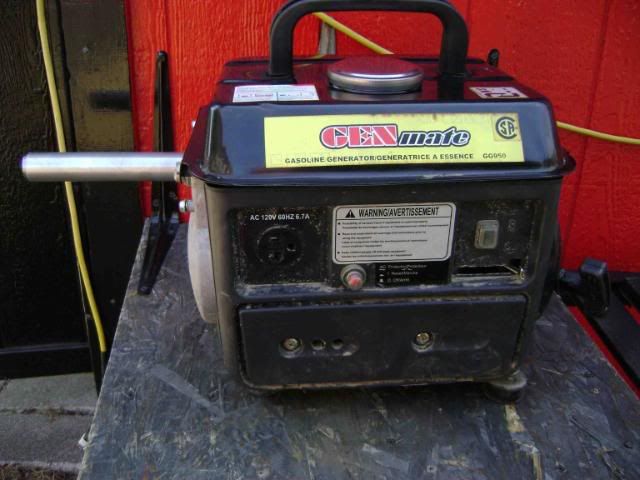

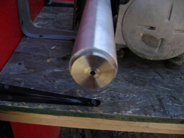

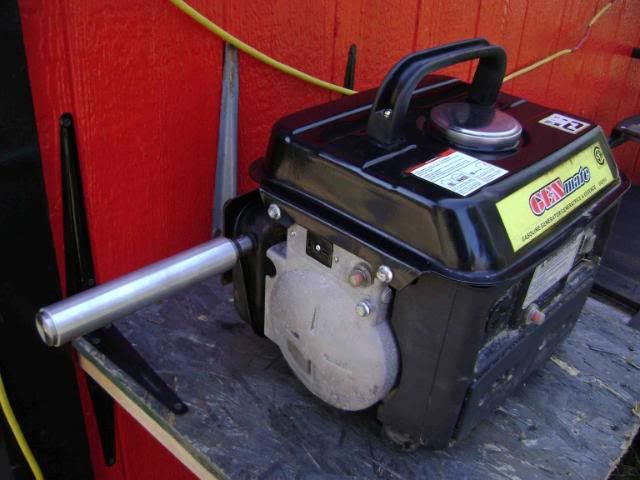

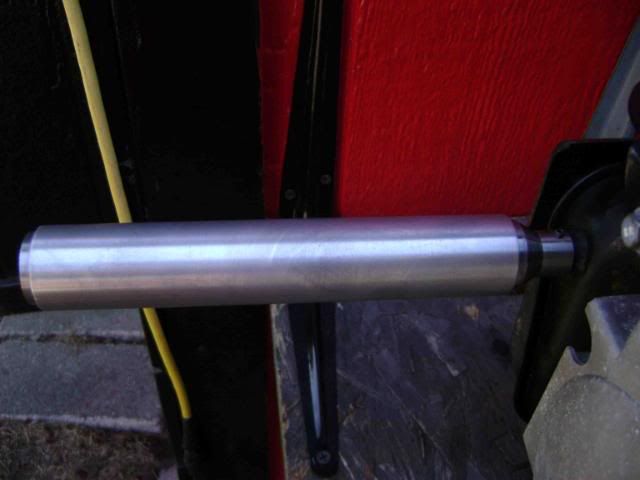

    ok well i like htis geeny bought it used for 20 bucks and its only a year old.. and works perfect, anyhow it is very quiet as it is and iam using it to power my shop lights and a few other things all same time.so any how, i made this little rig from some hollow aluim and stainless steel caps fornt and back and made the hole at 9/64, now its even quieter and works really slick i should be able to work in the shop at night now and not distrube my neibours you can hardely hear it at all now..
    the main reason i got the genny was to lighen the load on my hydro bill i can run for 12 hours on a tank of gas which is not bad for a 2 stroke motor..and iam never out there that long at a time anymore so it should pay for it self pretty fast id think.. I should metion as well that the orgianl hole out of the exaust pip was 12 Mm so its is a substantional reduction ..
    That's a nice little generator. I have one just like it. They are well made. It's not a good idea to restrict the exhaust that much on a 2 stroke, it will cause overheating and can cause the engine to sieze from lack of lubrication because the oil is carried in with the fuel. Not enough fuel means not enough oil.

                  the restrixtion of the exaust is not an issue with the device i made it does not creat more pressire nor does is restrict the air flow the muffler still does the job its supposed to ,, this thing just makes the sucker run a hell of alot quieter,, 2 stroke or 4 stroke wont make a difference in the lubracation the motor is getting.. its get al the same lube as it did before i installed the extention to the muffler ..
                  Restricting the exhaust restricts the amount of fuel it is able to pull in since it DOES increase the back pressure. Try breathing through a soda straw which is about the same size.
                  Restricting the amount of fuel restricts the amount of oil and WILL cause damage even if it doesn't sieze the engine.
                  It makes a big difference if it is a 2 stroke cycle as opposed to a 4 stroke cycle since a 4 stroke has an independent supply of oil that is pumped and splashed on the moving parts. The only way a two stroke engine of that type gets any oil is via the fuel.
                  It would be a shame to ruin your genset because of something so simple to change. It's a nice little generator and worth much more than $20 if it is running well. They sell new for around $150.

                            If that tiny little hole is all there is for the exhaust to escape then there definitly IS a lot of restriction, a LOT of restriction! Two stroke engines are very finicky about the exhaust design and restricting it will have adverse effects even if they are not apparent right now, and yes it will affect lubrication (among other things) for the reasons already stated. That exhaust set-up may seem like a good idea right now due to the noise reduction but in a short time it will get even quieter, in fact it is going to get VERY quiet indeed!
                            Also there is no way, no POSSIBLE way, that thing can produce power cheaper than the grid and you are kidding yourself if you think so!
