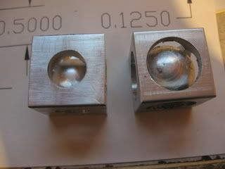

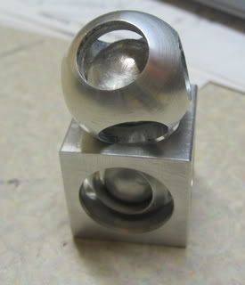

    This is pics of a ball in a ball and a ball within a ball within a cube. Made on my Logan. With radius form tools I hand made. I turned the od of the one inch ball with a 7/8 ball inside with 3/4 entry bore with my homemade ball turner.
