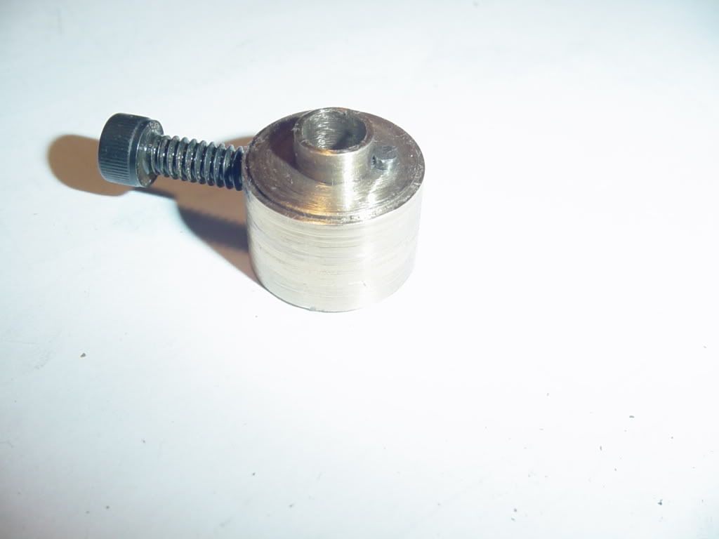

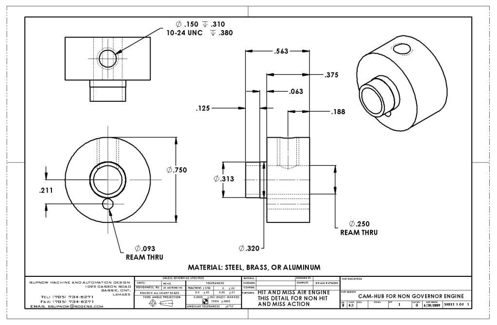

    I have had numerous people emailing me and asking about the flywheels, and if they can build the engine as a conventional engine without the hit and miss function and the governors. The answer is---#1--The flywheels CAN be made from aluminum, and they CAN be made to 1/2" thick. ---and the non governor flywheel does NOT have to have the long extended hub as shown on my drawing.---I only made the extended hub that long so that both flywheels would be spaced out the same distance from the crankcase, and I wanted the extended hub to drive an o-ring drive pulley to power some secondary equipment.

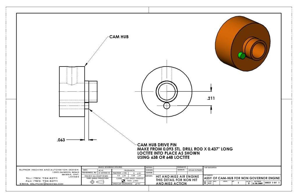

    ----#2-You can build the engine with 2 identical flywheels and skip the governors. You will need to build a cam-hub similar to the one in the attached picture.--Please note that I built this from a "scrap" peice of brass and 3/32" steel rod---there is a bit of machining at the extreme outer diameter of the peice in the picture which serves no purpose and doesn't have to be there----And the one in the drawing will not be as thick as the one I show in the picture.
