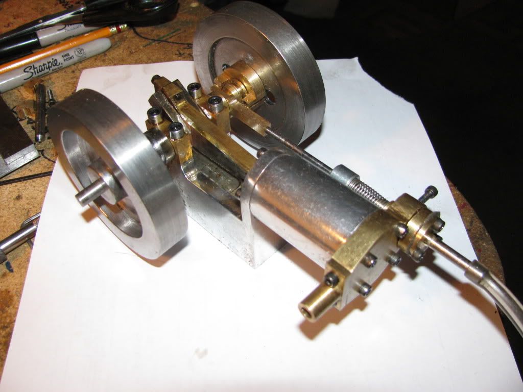

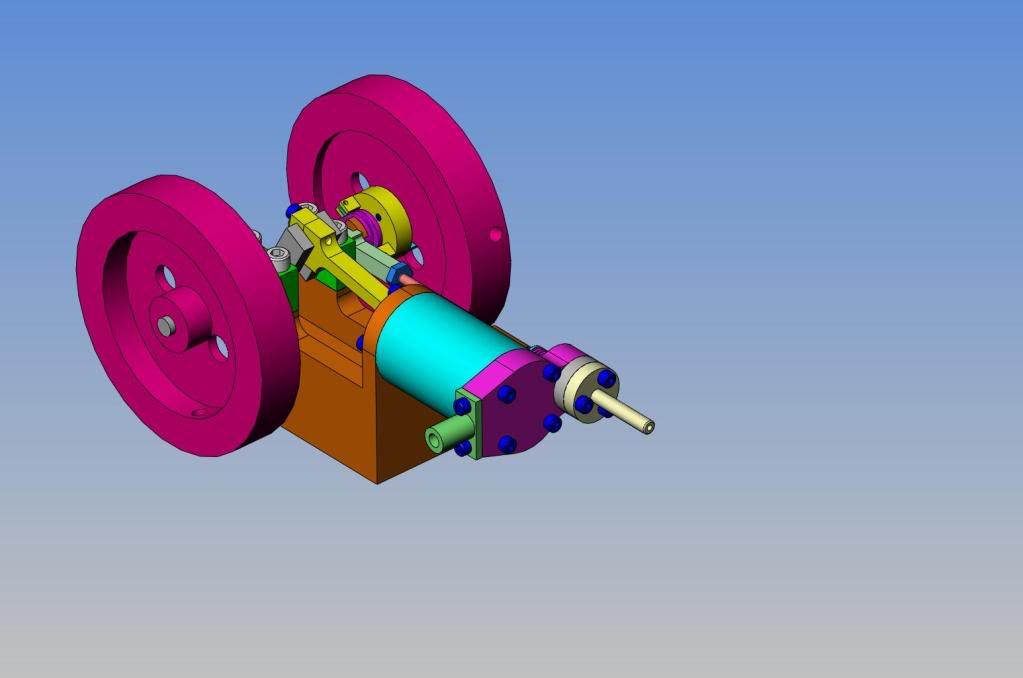

    I just finished a very quick build of another small steam engine. This engine was originally designed by a clever man named Chuck Fellows over on "Home Model Engine Machinist" website. I modelled it in 3D Solidworks and then created a full set of detail drawings. Of course, I couldn't leave well enough alone, so then I had to build it. It will eventually be built as a "hit and miss" version, with a set of flywheel mounted governors which control the steam inlet valve. The exhaust valve is a slave mechanism, that is actually operated by the incoming steam when the inlet valve opens. When the inlet valve is closed, the exhaust port is open to atmosphere, allowing the engine to freewheel with no backpressure in the cylinder. This valve set-up also gives the engine a very distinctive "popping" sound as it fires. If anyone is interested, I will provide a link to a download site so you can use my plans to build your own.---Brian

      Very nice looking and running engine. JIM

        Brian do you have the flow simulation software for solidworks? If so have you ever used it to check the efficeny of a steam engine and its operation. I am thinking of purchasing it for testing my own steam models before I build them. I would like some feed back as to how well it actually works.
          Cool engine!
          The problem w/ that sort of valve is that you don't get any benefit from the expansive power of the steam - a lot like a duplex pump. This is why you get that "pop"....
              I do not have that add on package.--sorry!!
                Neat engine and sound. Can't wait to hear what it sounds like once you get it to "hit and miss". That will be different for sure.

                  I'm speechless! Great job, thanks for sharing!
