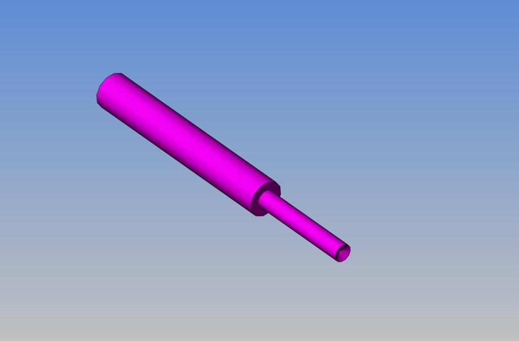

    Last week when I was making the two part valve housing for the hit and miss air/steam engine, I found that I had a terrible air leak between the upper and lower half of the valve housing. I had some gasket material left over from a carburetor rebuild, but the question came up---How the heck do I put in 1/8" diameter holes for the three #5-40 screws that hold the valve body together. I took a peice of 1/4" mild steel rod and chucked it up in my lathe, then used a 5/16" drill bit in the tailstock mounted chuck to drill a "cone" into the end of the rod. Then I turned that same end down to 1/8" diameter. Then I layed the gasket material on my mini anvil and positioned the punch over the area where I had marked the holes. One whack with the hammer and it cut a perfect 1/8" circle out of the gasket material. then I used the sharp end of my scribing tool to dig the peice of gasket out of the end of the punch (It comes out very easy) and finished the other holes. A very cheap and effective way to punch perfect holes.----Brian

    Brian, It's amazing what useful tools wad punches are, especially when it comes to making gaskets. This afternoon I had to make up an aluminium head gasket for a 2stroke trials bike. The gasket is just a simple ring but at locations 90* apart on the periphery are scalloped cut outs to allow th gasket to clear the locating dowels on the head. With a thicker flat sheet of ally as my anvil and the correct punch size job was done in 2 minutes.

          On a job i have been engaged on for a couple of months now, I have had to turn out a number of gaskets, made of card, and fairly thick brown paper, I have had a good deal of success, by setting up a portion of silver steel (drill rod) in the three jaw, face end, and use the appropriate size of centre drill to form the end, on the various sizes of punches.
          When punching out my gaskets, i find that by using some pieces of hard nylon rod, which i recieved as scrap, i can place the little covers on top of the nylon with the gasket material underneath, and punch through,
          By using the nylon it saves my punches from getting burred over, and also, if my cover has a spigot underneath (Say a cylinder cover) then a matching recess can be cut out in the nylon to accomodate, And later on machined away in readiness for the next task.

                I have several lead disk 5" dia X 1" thick I use to lay gasket material on.
                Really saves the cutting edge.
