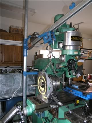

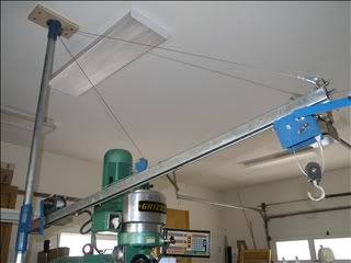

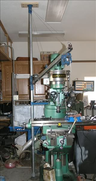

    I needed a small jib crane to move the rotary table, vice, chucks, and projects on and off my mill table and lathe. Heaviest item would be less than 200lbs. The pole is 1 ½ x 10 feet pipe tied to the floor with a ½ inch pin 1 inch in the concrete. The collar at the top is tied to the ceiling joists. The center is braced off the mill. The jib is 1 ½ x 5 foot unistrut. I made two winches. The one on top of the jib raises and lowers the jib. The cable goes from the winch through a pulley center top of the jib then to a pulley at the ceiling collar and back to the end of the jib. The one on the bottom raises and lowers the load. The load winch is moved in and out on the bottom of the jib with a 3/8ths all thread rod. The jib and upper pulley also pivots on the pole.
    The winches use 3/32 cable. 12 feet for the load winch and 25 feet for the jib winch. The drums and integral gears were made from 4140 H T. The pulleys and swivel load hook were made from the same material. It takes about 5 - 6lbs pressure on the end of the 6 inch handles to raise the load.

            My heavy load would be less than 200lbs. The weak point if I did my calculations right is the pinon gears on the jib crane. More than 1,000lbs before failure. By using the pulleys to spread and even the load on the jib I feel safe at rating it at 200lbs. The pole and jib show no bending at 200 lbs, but I would make them larger for any heavier load.The load winch has heavier gears and starts to fail at 1800 lbs, but the 3/32 cable is only rated at 1200 lbs break strain. That means safe load single line is no more than 240lbs. Both my winches are using double line. Off winch around pulley and back. The winch drums were sized for 3/32 cable and if you used a larger cable you would need to make the drums larger, which would make the winches become larger also.

                    This is page out of my old strut book. P1000 is the standard 1 5/8ths strut. My jib is supported every 30 inches which according to the chart gives me a safe loading of 625lbs.

                            I made mine to reach the mill or lathe. The 3/8x16 rod that moves the load winch is slow even with the electric ratchet wrench, but it does give fine adjustment. The jib winch will move the jib from floor to ceiling. The brace off the mill is important as it greatly resists pole buckling. If you can't get a near center support you may need to go to 2 inch depending on load.
