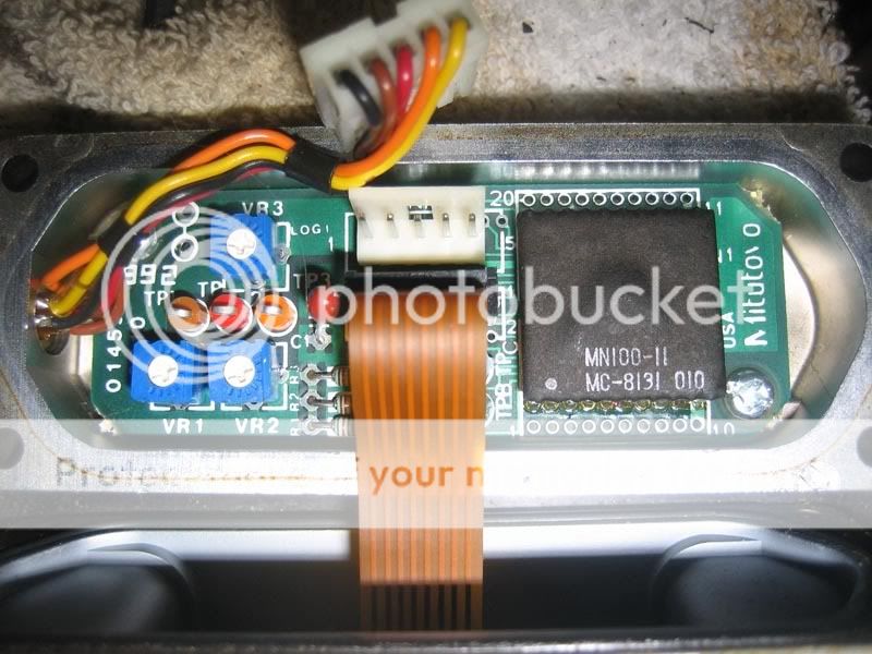

    I hope someone in the group has some experience with the mitutoyo glass scales. I have acquired a mill that came with a mitutoyo DRO, but one of the scales is missing the cable. Rather than spend the $125 on a replacement cable, I'm going to fab one. The only problem, I don't know the pinout on the scale itself. I have taken a pic of the guts of the unit, there's 5 wires: Black, Brown, Red, Orange and Yellow. I know these translate to +5vdc, A phase, B phase, ABS and 0v. I just don't know which wire corresponds to which signal. Anyone know, or have a method to find out that won't risk harming the scale?
    TIA,
    Ryan

          Can't you use the other scale as a model?
            That's a good idea, the problem I think I may run into is the other longer scale is not the same model. I know for sure it does not have the same style connector on the scale, I think it's hard wired. I'll open it up tonight and have a look.
            I'll post back my findings.
            Ryan

              Yes Mitutoyo keeps the wiring same from the display connector to the encoder connector. I think that the connector has the numbers on it so your drawing of the 0.005 is the correct drawing.

                Thanks everyone for the ideas and confirmation that the wires run 1 to 1.
                The longer scale was not the same, so this info pertains only to the AT2 series.
                For the AT2-N300 the wires on the inside of the reader box are
                Black = 0V
                Yellow = ABS
                Orange = B
                Red = A
                Brown = +5V
                I got it wired up tonight and everything works as it should.
                Hope this may help someone in the future.
                R

                  I have a similar problem with my AT2-N1200 Mitutoyo scale. The cable was torn out of the detector box on the scale.
                  Can anyone send me a picture of how the colors of the cable fit to the small circuit board in the detector box?
