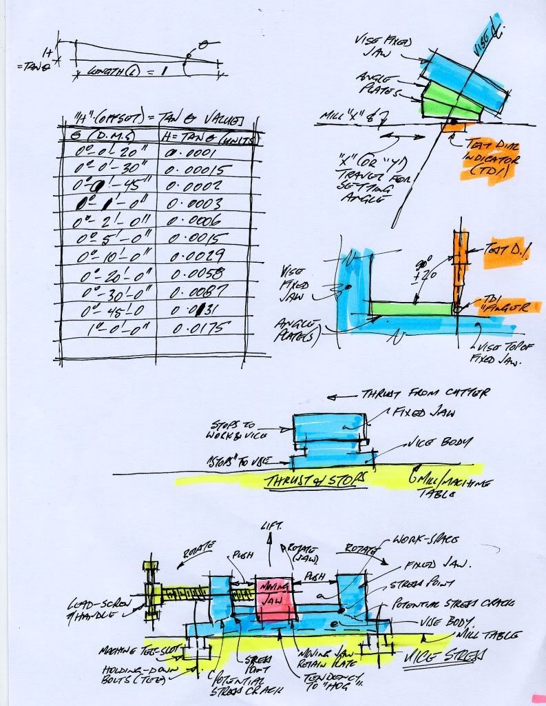

    Use angle blocks to set the angle to a very high order of accuracy. Search item is angle blocks 35116 - US$22.
    Suggested principles of use of angle blocks (top only):
