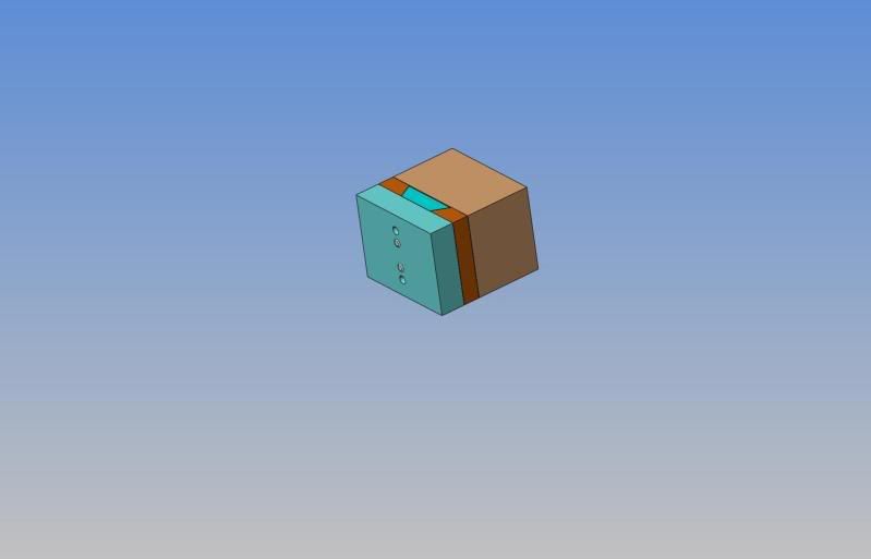

    I have been thinking about making a quick change toolpost for my lathe. This of course requires a dovetail milling cutter. I just priced a dove tail milling cutter yesterday, and it would cost $70. Last night, as I lay in bed fighting my chronic insomnia, I got thinking about alternate ways to come up with a dovetail. I want the end result to look like this,

      And---having far more time than money these days, I thought---Why couldn't I make it out of individual peices as shown, and use dowel pins and 1/4" SHCS to assemble the peices.

        I think it would certainly work at the expense of some rigidity.
        Monarch 10EE 1942
          I don't think it would hurt ridgity all that much. I think with dowels and good fasteners it will be plenty stout.
          Many guys also just make a dovetail cutting tool from scratch and use a single carbide insert.

              Nice design Brian,
              Looks like something a fella could knock out in a hurry if he needed a special kind of tool holder.

                      Your design will work fine, Brian. A friend of mine came up with the same rough idea, and I cranked it out for the toolholder. Didn't have any flat head Allens on hand, so I used what I had with a dose of 271 Loctite on the screws as well as the back of the dovetail. No chatter. Works great.

                            If you want to make it stronger, forget the pins and use shoulder screws instead at all four positions on each piece.
