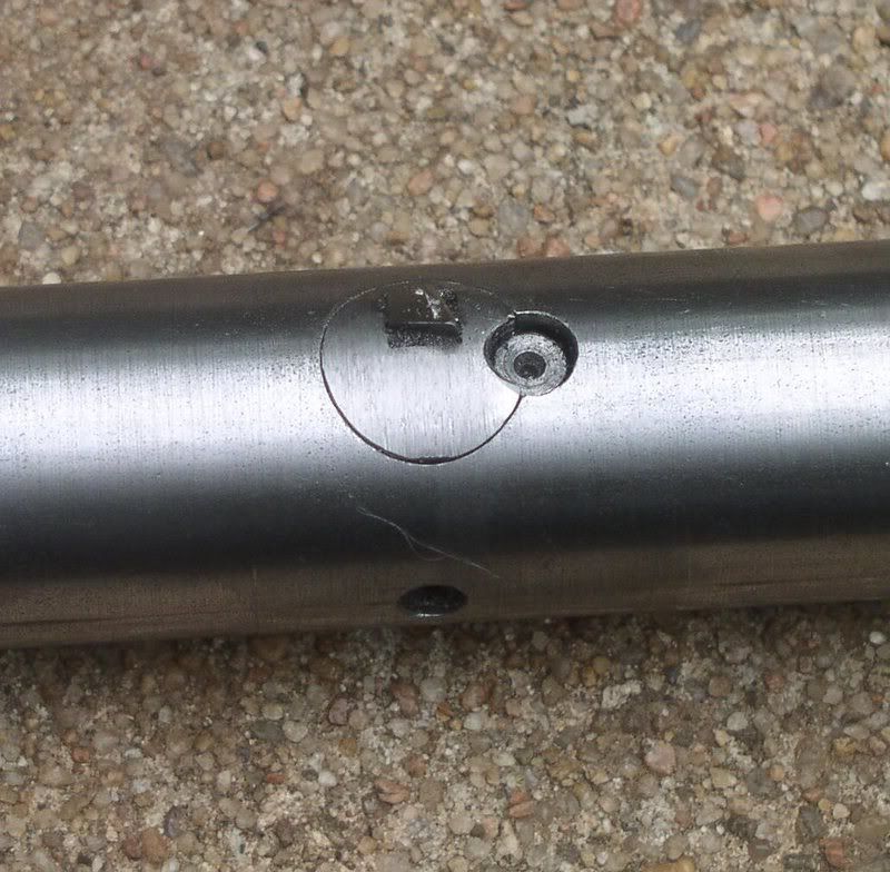

              MEW a while back had a nice design with a screw adjustable cartridge that held a square toolbit. I made one for a job and it worked nicely.
              Working side and adjusting side below.

                I had exactly the same problem a few months ago and this is exactly what I did. It is a bit hard to see here, but the top of the boring bar is flat by the tool bit.
                Here's a shot of the flat being milled on the lathe.
                I found it quite easy to adjust the bit with a depth mike and a donut shaped spacer that sat on the flat. The spacer was a piece of 1" diameter stock with the ends turned parallel and a 1/2" hole drilled down the middle. It kept the mike perpendicular to the flat and parallel to the tool bit. It would take different lengths of tool bits and spacers depending on the diameter. I was boring aluminum so I choose a borken milling cutter for the bit and ground a proper tip on it for boring.
                Of course, it took three hands to position everything and tighten the set screw, but I learned that trick many years ago. I could easily set it to a half thousanth.
