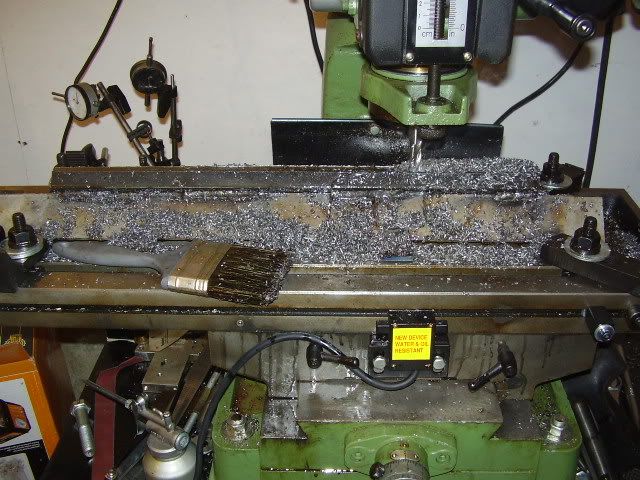

                      I'll show you what I did in a minnite if'n all goes well with the pic postin'
                        rough, but tough enuff
                        I took a piece of scrap 2 x 2 x 1/4" angle and welded 1 1/4" x 1/4" strap iron lugs across the open side of the angle to create an inverted Vee. with sides inclined at 45 degrees.
                        Then I took the 1" x 3" punch stock and laid it along the vee tipped over to just over 45 degrees then skip welded the punch blank to the jig.
                        took all over to the milldrill and clamped the whole shebang onto the table and clamped it down with 4 clamps.
                        Back inna minnit with a pic or two ( I hope)
                        It kinda worked. Just had to cut the welds off with a cutter disc and touch up with the angle grinder.
                        To do the other side I'll have to shim the punch and set it up on the jig and possibly bolt it on so I can move it to indicate it in for setup. I took advantage of the solid set-up to remove most of the material on the other side of the vee by plunging the end mill. The working edge is presently a 90 degree edge tilted off axis.
                        Best of all, no trip to town for 1" keystock or additional tooling...
