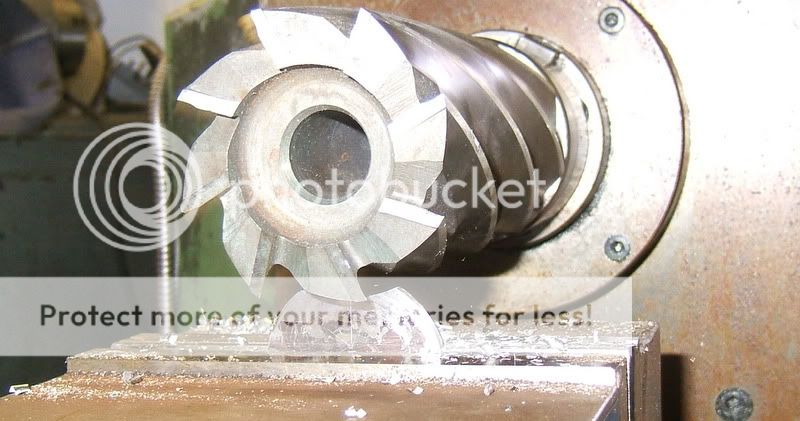

    I got this cutter among a box of 'Dedlock' cutters a few years ago, & wondered why anyone would need one like it. Finally found a use for it today:-
    The cutter is 6" long, 3" dia. 'Dedlock' is a Clarkson system for shell mills which have internal threads, the big brother of the Autolock endmill chuck system.
    More or less defunct now, but I think you can still find new cutters if you look hard enough and have deep enough pockets.
    I just needed radiused cutouts for water passages in a part for a marine thermostat. A 1/8" thick slice of 2" dia 316, with a 6-32 thread in the centre to hold the Waxstat element. The big cutter was about the right diameter and long enough to reach across the end of the vice.

    Wow. Can't exactly use the rotable on a horizontal! Good idea if you got the cutter.
      Whydithav'tbecurved ?
      2flatsdo?
        2flatsdo?

              Didn't need to be, probably. The original was missing, described in the parts book as a 'plate' so I assume a disc with holes. I wanted to be sure it stayed flat, while allowing plenty of water through. Could have attacked it with a hacksaw or angle grinder, would have worked just as well!
                  Tim
                  Yea, it probably could have been a straight cut or perhaps a Vee and worked just as well. But if you have a nice, BIG, 10,000,000 percent overkill cutter just sitting around, you just h-a-v-e to use it.
                  Somehow, I completely understand.
