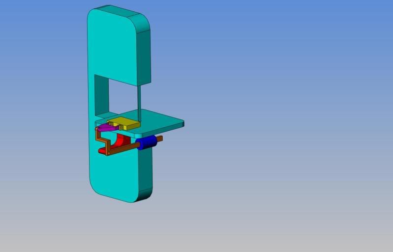

    Last week when I was cutting some stock on my vertical bandsaw, I was thinking---"Gee---I wish I could just leave this and come back when its finished cutting, like I can my power hacksaw!!!"----This got me thinking---How hard would it be to rig a bandsaw autofeed. Hey--I do this kind of stuff for a living!!! So---Last night as I lay in bed, struggling with my insomnia. this is what I dreamed up. Very simple, but rather elegant. An arm, an adjustable position weight, and a couple of pivot points, I've shown a 1" thick x 3" wide x 6" long plate as the "Pusher" plate. One hardstop would be factored in to keep the pusher plate from cutting itself in half on the saw blade.---Brian

      Duffy---that design is just like pantyhose--"one size fits all!!!" My bandsaw is an old "Jet" that I bought from a retired carpenter.
        Looks to be even more simplistic then Grob's solution of wire, pully, and weights.
        How ever as the weight nears the bottom of the swing it will have less horizontal force to apply to the work piece. Perhaps a small automotive presurized gas shock simular to the ones they outfit on the hood or trunk lid of newer cars. The pivot point could slide on the arm just as your weight does to adjust the amount of force applied

          Joe--with the limited amount of travel that the pusher bar makes, the horizontal weight arm never gets any farther from horizontal than what you see in the picture, even at a full depth cut.

            Check out the chain and cable system as used on the old DoAll band saws. Your system does not provide a constant pressure on the blade. Hoe do you lift the weight to start a cut?
            JRW
              Brian,
              Am I missing something ? How do you factor in different lengths of cut ? say you have a 6" deep cut to do in a plate and it overhangs the bed in the start position.
                Yep - I based my assumptions off my experiences with a Grob 36" vertical saw. Not all saws are quite that large.
                Are you going to incorporate a fence in the design ?
                  Guys--I'm probably not even going to build it. It was just an idea that I had. Sometimes a good visual representation of an idea will spur others into the knowledge that "Hey--Thats pretty simple--I could build something like that!!!".

                      Redesign time---I didn't like the way things stuck way out past the front of the saw table.--This tucks it in a lot tighter, and the "weight-arm" is on one side of the bandsaw only---still thinking---

                          Still very limited on the size of material that can be fitted inbetween the blade and the pusher when it's right back.

                            I think Bryan's idea would work well on small length cuts ie. bar stock, angle ect. An addition would be a clamping system for cutting round bar.
