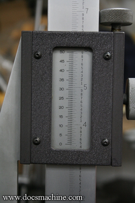

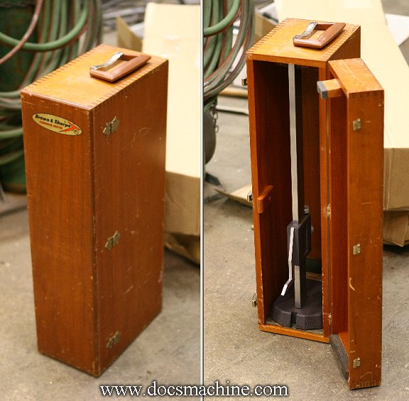

    Anyway, he very graciously, without being asked, offered and sent along this 21" Brown & Sharpe vernier height gage in it's wooden storage case.
    It is in absolutely perfect condition. The box, as shown, has a few nicks and scrapes, but is completely sound. The gage itself doesn't even have so much as a fingerprint.
    The vernier is a style I hadn't seen before, with the scale etched on a clear (glass?) window. That gives it a nice, large, easy-to-read .001" resolution.
    On the (slight) downside, the pointer is neither carbide-tipped nor replaceable (as per the Fowler on the right) but with care that should never be a problem.
    I'm also not yet sure what the three knobs do- the larger one on the back seems to lock the sliding element, but the top one doesn't appear to fine-adjust the measurement as one would expect with a vernier.
    I'm loathe to crank on any of them "til something happens" so if anyone can clue me in on those, I'd be much appreciative.
    Doc.
    i have one that is similar and the back knob locks it to the bar and the side one locks the fine adjust and the top is the fine adjust. not a guarantee that yours is the same mine is very old and has no name.
