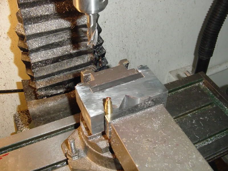

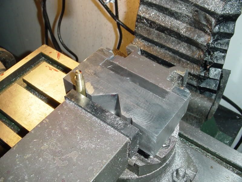

    Every once in a (rare) while, I have to stand a round part on end in my mill and do "something" to the end of it.---And up untill today, I didn't have any real good way of holding onto a round part standing on end. I am still waiting for some "real work" to come into my engineering office, so today I decided to make a V-block that would fit into my Tilt-A-Whirl vice. I hate to admit it, but it took me the entire day to make this, and fortunately I had a peice of 2" thick scrap aluminum plate around. I designed the 3 V's to accomodate any diameter rod from 1/8" up to 1 1/4" diameter. I stuck a peice of 5/16" round brass in the fixture, just for "show and tell". The fixture is a "good fit" over the fixed jaw in my vice, and can be lifted off without having to tighten or loosen the bolts holding the rear clamp bars in place.
    That looks like the business thanks for showing.I like the way you made several v's.Wow well done could you show how you cut them ?Alistair
      Alistair---I stood the part in my vice at 45 degrees and milled the notches with a 1" diameter end mill. I laid out lines on the piece of aluminum and milled to the lines.

              Nice work, but a few words of caution.. loading the 'side' of your vise like that is bad for it, it puts stress on whatever alignment methods it has if not directly on the screw. allways try and center your work with the screw.
              Second I think its best to have your work located agaist the fixed jaw, and your jig against the movable jaw.
              90 degrees is a good angle for its ability to also hold square peices diagionaly, but other angles can be used as well, ie 60 degrees, holds bigger round peices without having such a deep cut or wraping around smaller peices so much.

                    I like it, Brian. Nice and simple. I also wondered about the off center loading and was reminded of a device I saw in a very old book on Google. It is a thick piece of steel, about jaw height and width, flat on one side, slight convex curve on the other, horizontally and vertically. The convex side goes against the moving jaw and pivots as needed. It holds the work and also the other side of the softjaw and evens the forces across the vice.

                            I have a whole bunch of round parts that need a set of holes on a
                            bolt circle. A "V" block like this will make it possible to repeat the
                            location of the parts so the hole pattern will be identical without
                            re-zeroing the DRO each time. I'm in the process of making one
                            right now. We have at least 4 sizes of V blocks but this still a very
                            worth while addition. I am going to put a clamping screw on one
                            end of it to firmly locate it since the jaws of the Kurt don't extend
                            enough to grab the thickness like the "original". :-)
                            ...lew...
                              Lew,
                              Use soft vise jaws (aluminum) and bore them to accept the parts. Can't get much better as far as locating and holding securely.
