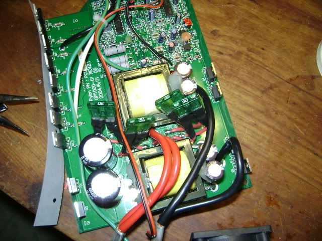

    this is a xantrex 1000 watt invreter from ctire, anyhow i got it from my buddy the other day , was not sure what was wronge fiquired it was a fuse , well these things are not made very friendly when it comes to replacing them , dule layer soldered board an how turnned out all 4 were fried so i tred to unsolder did not work so i took out the trusty needle nose pliers and wiggled them till the left their stems behined , this owuld give me both lawyers and i can solder some wires on and so on , any how i can now just change the fuse 1 ata time by just pulling of the lead connectors , ,now had they built this thing right they would have used sockets and then the user could just changes the fuses as needed , so now its proper and perfect , tomorros test will be to see if all this work is going to pay off,
    How are the output transistors on that thing- good or fried?

        it is a little difficult to understand exactly what you did. Do I gather you replaced the fuses? or the outputs?
        Usually, fuses in those blow because of a "real" problem. Once every few years maybe the fuses will be the only bad thing. Who knows? you might get lucky, but usually, no.
        In most cases, the semiconductors in those inverters are sized and set up to just do what is required, no more. When a fuse in a "minimum standards" unit like that blows, it is usually not a good sign, 98% of time there is a dead output, or several.
        I see several 30A car fuses. Definitely not a good sign if all of them were blown.
        Generally those inverters have two stages. The first is a "DC to DC" stage which converts 12V battery voltage to a high voltage DC. The second stage produces output AC from that high voltage DC.
        The transformers visible in the bottom of the picture are probably in the DC to DC stage.
        Faults may occur in either stage, and such faults may blow the fuses (and some semiconductors) whether they are in the high voltage or the low voltage section.
        Usually, fixing requires access to suitable replacement parts, and some shrewd guesses about the circuit.
        But, you might get lucky....... don't count on it.....

          for the under educated here, fueses will also blow when you try and push these units as well , 2 out lets for AC means 500 watts max per out let if you are trying to use up all the watts on one outlet you frie the fuses, i did some research on these units and others and they are all set up the same the watttage is split to each out let so its alot fo false advertizing as to the wattage in my books, If you are going to make say a 3000 watt unit make it put out that wattage even the running amps woujld be nice if it was say 2800 then you get what you paid for, the way they are making them and splitting up the wattage you are buying 2 small inverters in one case, for the cost go buy a genney and get it all out of one plug even if there is others its usualy not split like these invereters are, , i have a 300 watt inverter as well its is got 280 watts runing and one outlet for ac so i got what i paid for there,

                    1) I happen to actually design inverters, boosters, and related controls. Generally bigger ones with transistors the size of paperback books, but I have designed, made, or repaired a number of those little ones also. That doesn't make my comments perfect, but a lecture I don't need.
                    2) I have yet to see anyone successfully fix an inverter of that sort without any schematics etc, who was not already quite familiar with their operation and typical designs. I have seen several folks try, and have completed the job for some of them.
                    3) Yes, it is possible to overload the unit and blow fuses. But since those are primary-side fuses, in the high current area, blowing them means that very high stresses were already put on other parts of the unit, since most units have rather effective protection and current limiting that typically is set below the fuse rating. if the fuse blows, in a properly designed unit, there is generally a problem. As I said, you might get lucky.

                            ok drum rool please , well ok we hooked up the battery to the inverter and I never even gota chance to turn on the power switch and all 4 new fuses also blew , so i guess she is shot to hell and not going to bother with it,
                            oh well it was worth a try but i guess its got more issues then just fuses , and i dont have the time to find out what else is shot in it, but at lease the mod for reaplceing the fuses was a good idea, just to bad its compplety shot would have been great for powering my shop lights and my mill..
