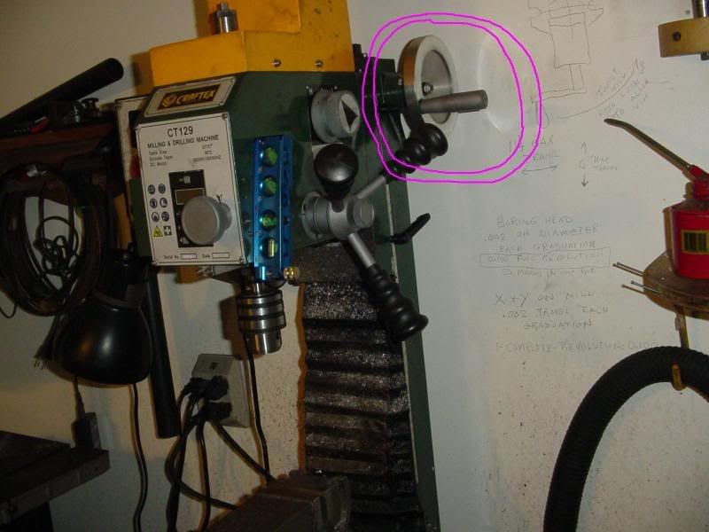

    I have a CT129 Craftex mill from Busy Bee and the handwheel that I have to turn (in pink circle) to adjust the height of the head is high up at the rear of the mill. This happens to be right in the quadrant of movement that really bothers an old tendon injury in my right shoulder. Last night I was thinking of adding a power adjustment to the head. What immediately came to mind is the motor and gearset off an old barbeque rotisserie.---Trouble with that is that I doubt the motor is reverseable. Has anybody made a modification like that to their mill?----Brian

      I don't really have room to use an electric drill, although the thought did cross my mind. I was also thinking of a 12V power window motor. The trouble with an electric drill is that it puts your hand in a really awkward position to use the trigger. Its almost got to be something where I can wire the switch remotely---like a rocker switch mounted out near the front of the machine.

        A friend once made a power feed for his mill using a windsheild wiper motor. there reversible and have lots of torque. A 12Vpower supply should not be to difficult to make.
        Terry
          Windshield wiper motor.I've made several things out of Ford Ranger wiper motors.The shafts on those can be pressed out of the worm gear and replaced with a straight keyed one.
          Maybe a chain and sproket or gear reduction if you need more torque.
            Have you considered an cordless angle drill? it would take up less space and have the trigger at a better position.

                  Okay Terry---educate me a bit. How would I go about reversing a windshield wiper motor with a switch? Since it is D.C. logic tells me I should be able to do it by supplying positive current to the case and grounding the feed wire, but I'm not 100% certain of that---and can I buy a rocker switch and wire it up to do that?
                    All wiper motors that I have seen are permanent magnet type so reversing the polarity will reverse the motor.You should be able to do it with a double pole double throw switch or DPDT.

                            Something like this--Remove top handwheel, put sprocket in its place, mount smaller sprocket on output shaft of some kind of gearmotor--connect with roller chain. My model shows gearmotor mounted on wall behind mill---in actuality I would probably build up support brackets off mill column.
