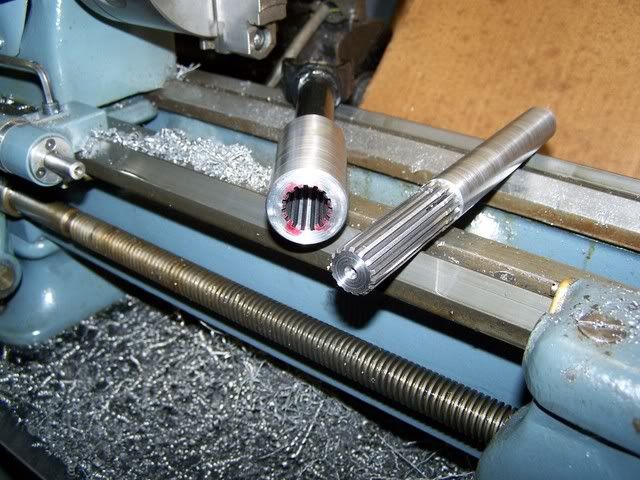

    A friend of mine had his Kubota PTO shaft on his lawnmower crap out. The splined shaft sheared off in the coupling. Kubota wanted $833 plus tax. I made him a new shaft and (2) coupling for $260. I have about 14 hours in all the pieces. I will weld the couplings back to the shafts tomorrow at work.
    These were 100% made on my South Bend 9" lathe, splines and all. I broached the splines using my carriage with a tool in my QCTP. The fit came out very good, still gotta put zerk fittings back in them.

    Can you post a photo of your spline cutting setup?
    Also I was wondering how you indexed the chuck for the spline.
      I use this to index the spindle:
      As far as the cutter I have a couple of boring bars that I made that hold square toolbits. I grind them to the form and then use the carriage handwheel to shave off about .002 per pass.

            What material did you use and did you harden them?
            The old ones were most likely hard, and they broke, so chances are they need to be as strong or better.

                The old ones were not hard at all. They weren't even as hard as the 1020 steel I used. The welds on them were even junk. This was on a 3 1/2 year old commerical Kubota mower.
                He did not grease them as the leaf vaccum setup was installed by the dealer and he was told it was a permantely greased assembly from the factory, and there was no mention of it in his service manual. When the splines sheared on the shaft he removed the covers for the shaft an pulley and found 2 zerk fittings (at that point he was a little peeved). The splines on the old shaft sheared from the rust that had setup in the coupler until there was no material left to catch the splines. When I pulled the shafts apart all that came out was rust, about 4 tablespoons full. You have to realize this shaft is small (19mm OD), in fact the u-joint on the other end is the smallest I have ever seen. The main thing was to make these last another 3-4 years, as by that time he will have worn the mower out. He mows about 60-100 acres a week with this mower, mainly rich doctors and CEO types. The vacuum system is already obsolete and unavailable from Kubota, the shaft assembly was the only part left available from Kubota, or at least thats what he was told. He said they quit building the unit around 2 1/2 years ago.
