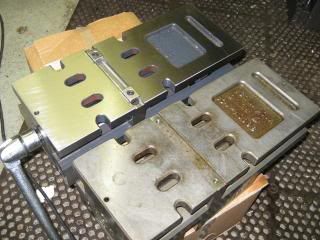

    There's been some buzz about the new Glacern Vises and I have purchased one so I thought I would post my opinion about the vise.
    I called Sol at Glacern and ordered one of the GSV-615R Reversed-Jaw Premium Vise's ( http://www.glacern.com/gpv_615r ). This vise is similar to a Kurt vise except the fixed jaw is on the operator side, which allows you to have positive positioning in the Y axis when using the fixed jaw as a work offset. It is also nice on a VMC as you don't have to reach in the machine so far to put parts in the vise. One thing I should mention here is this vise is not the best choice for a Bridgeport style mill. The vise hangs off the back of the table too far and can hit the column, a better choice for a BP mill is the GPV-615 Premium Vise or GSV-690 Standard. I purchased this vise for use on a Fadal Machining center with a 16" wide table so it works well on that machine.
    The vise was ordered and a few days latter it arrived, which means it was shipped the same day it was ordered. The packaging was very good with the vise in a box that was inside of another box surrounded by packaging peanuts. This is good because it allowed for damage free shipping even using UPS, Enco will only ship Kurt vises by truck because they had too many problems with UPS which makes shipping cost very high. Here is the package,
    I opened the box and found some nice items that weren't expected. The vise included four hold down clamps with bolts and T-nuts, Keys in the bottom and two T-bolts with nuts. Here are the hold down clamps,
    I own five Kurt vises, two 3600V's, two D675's and one D688 so I was able to compare the Glacern vise side by side with the Kurt vises. The fit and finish on the Glacern vise was very good and comparable to the Kurt's. The vise worked very smoothly and seems comparable to the Kurt's. The screw was well made and had a nice seal to keep the chips out, on some of the Chinese vises I have seen the screw was very poorly made. Here is a picture of the vise next to a Kurt D688,
    As you can see this vise works in reverse to a normal Kurt.
    Here is a picture of the bottom of the vise next to a Kurt 3600V,
    You can see the included keys mounted in the bottom of the vise, which were quickly removed as nothing screams rookie machinist like keys in a vise.
    A couple more nice features on the Glacern GSV-615R vise are a groove in the fixed jaw for a stop, and holes through the bed to allow bolting down from the top of the vise. The vise did not include the stop but they are available from sources such as Enco, http://www.use-enco.com/CGI/INSRIT?P...PMAKA=712-0149 .

    Here are pictures of the fixed jaw,
    I don't have a good picture of the top side bolt holes but the holes can be partially seen next to the keys in the picture showing the bottom. The top side of the holes are in the bed and have counter bores and covers so a socket head cap screw can be used but no fill up with chips.
    Here is a final picture of the Glacern vise next to a Kurt D688 and 3600V,
    I have been using the vise now for a couple of weeks and think it is great value for the cost and I plan on ordering more.

              A shortened 4" version of that would net a customer in me. On smaller mills the opening width is of secondary importance, but being able to get the fixed jaw near the middle of the table crosswise without a lot of overhang would be a good thing.
                After looking at your pictures again (oh, I need one of those vises... ) it's worth noting that both Kurt and Glacern, as well as all the import rip-offs, take the time to mill the grooves, drill and tap the holes, and provide a set of screws and keys.
                While the import clones can be written off as copying, I note that both your old Kurt and new Glacern are milled for key slots. Seems odd to do so if no one but "rookies" used them.
