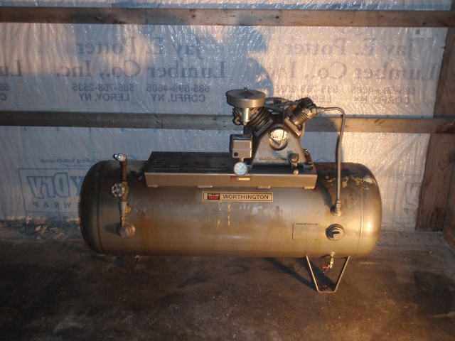

    I just won a bid on a Worthington compressor model 3CH8. It has a two stage compressor run by a 3 hp 3 phase 220 volt motor. It was manufactured around 1967 and it is in very good shape. It spent its life in the basement of our Village Hall and was used to air the firetruck brake systems while they were parked and also to sound the annunciator that identified the zone where the fire was. It was well maintained by a fastidious fellow, so I am confident in its condition.

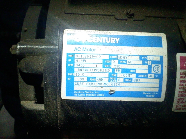

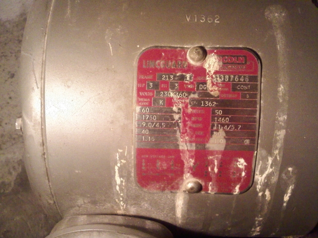

    What I need to do is replace the 3 phase motor with a single phase one. I wanted to use the 220 volt 4 hp motor from my rusted out compressor but it runs at twice the rpm as the stock motor. I'm trying to figure out if I can get away with just putting a smaller pulley on the single phase motor or what. Any ideas on what running the compressor too fast would do, aside from generate a lot more heat...
    Here's the data plate of the original:
    Here's the data plate of the one I want to use:
    Here's the compressor:

                  Bogus HP on that new motor..
                  See the Spl ? That stands for special HP rating (otherwise known as BS...)
                  15 amp Single phase 220 is probably really closer to 3 hp...
                  Sell it and put a VFD (which will do the 3 phase conversion) on...
                  Notice the 3 phase draws 11 amps for 3 hp it is a more efficient motor..

                            What I am going to try first, for the buy-in of less than $20, is putting the 1 Phase motor on and seeing what it will do. If it really is a 3hp motor(4. SPL), I would think it would work, since it is replacing a 3hp motor... I can get the pulley I need from Tractor Supply Co. and I have everything else here.
                            If the 1 phase isn't up to the job, I will look hard at converters, but I have a hard time with the idea that running 2 of three phases can be good or efficient for the old 3 phase motor. Because that is what a solid state converter does after it gets the motor going. The cost of a rotary converter would argue for scrapping the compressor and buying new... And, I question whether the losses of converting 1 phase to 3 phase really can give me an efficiency gain compared to just running a 1 phase motor. TANSTAAFL, after all...

                              you need to calculate the speed the compressor pump runs on the existing motor. im guessing around 900 rpm. you probably cannot alter the pulley arrangment using the 3450 rpm motor to achieve the design rpm.
                              a new motor, 1750 rpm, at northern tool is about $250. the 1750 rpm is what makes it more expensive. . . . . but thats what you need. i am currently replacing one for a customer as we speak.
                              a phase converter, unless its a very expensive one, will not start a 3 phase motor as used on a compressor, possibly not even an expensive one would work. compressor motors are just that, compressor motors.
