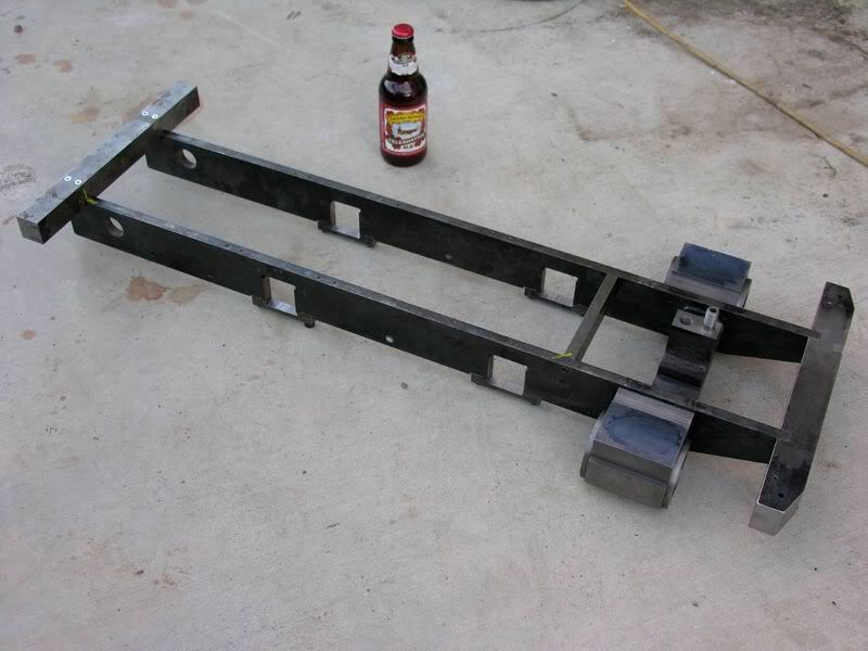

    Here is my current project, a Kozo A3 switcher steam locomotive in 1.5" scale (7.5" gauge). The frame and cylinder assembly. Beer bottle for scale... :-)
