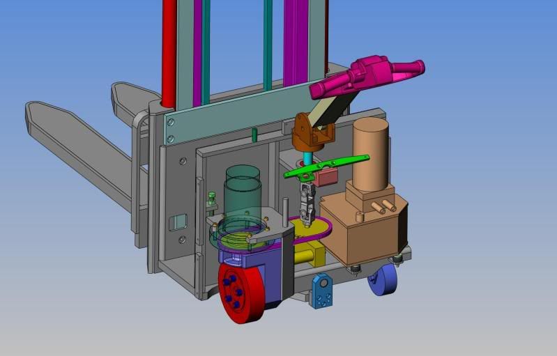

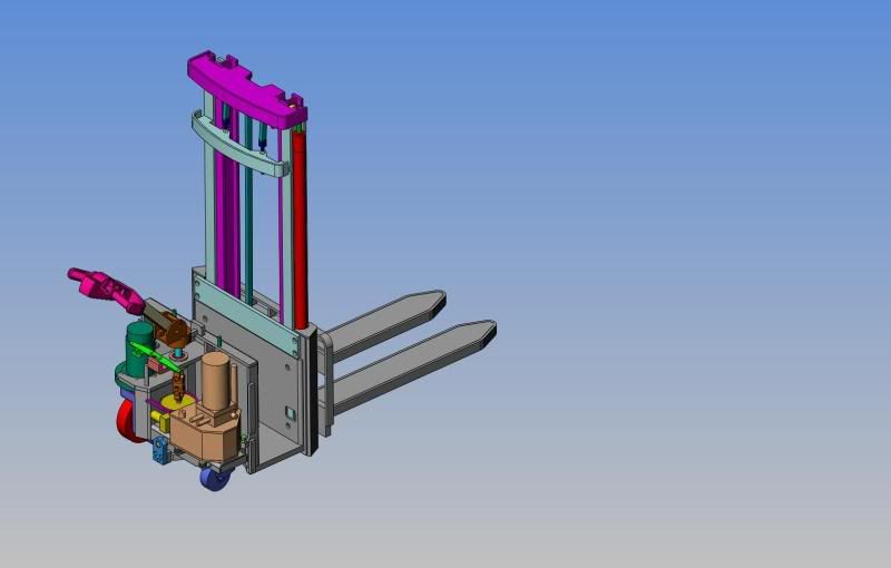

    What a fork truck looked like with its dress off??? I picked up a contract on Tuesday---Went down to London and picked up a fork truck, brought it home in pieces, and reverse engineered it this week.--Which is to say, I disassembled it all, measured all the pieces, and created "To Scale" 3D solid models of it. What you see here is 3 eight hour days and one "travel day". On Monday, I will begin to design a "New Improved" version, re-using some of the existing drive parts, with a completely new chassis. I love this stuff!!! After spending most of the past year reading fiction novels and creating "Make work" projects, damn, its nice to be doing some real work!!!

        So here we are at 72 hours and counting---Another 8 hours and all the detail drawings will be done and sent to the fabricator to start building.
          Hmm, I like that as I always wondered what kept that type from tipping over with a load on the forks. I see you have added ballast, I guess it's ballast.

            Carl--Yes, the red you see is 2000 pounds of steel plate to act as a counterweight. The yellow rectangle in the center is the battery pack. Between the battery pack and the front of the chassis is basically dead space. By making the chassis as long as possible, the weight of the counterweight can be reduced.
                Brian, how much mor capacity did You add and how much manuverability did You loose?

                  Doctor Demo---Those are difficult questions. In terms of capacity, a 2.5" bore cylinder with a 3000 psi. pump is capable of 14,700 pounds of thrust. On a single stage mast, there is a 1:2 mechanical disadvantage, so the lifting capacity will be cut in half to 7,350 pounds of theoretical lift. (Since there is an inverse ratio between lift capability and stroke, a 24" stroke cylinder will lift a single stage mast and forks 48".) On a 2 stage mast, there is a 1:4 mechanical disadvantage, so that same cylinder will lift only 14700 divided by 4 =3675 pounds, however the forks will lift 96" with the 24" stroke cylinder. Yes, manouverability is cut down when the truck body gets longer, but you need much less counterweight to counterbalance the load. As the lever arm (distance between the pivot of the front wheels and center of the counterweight" gets longer, the counterweight can become lighter to have the same net effect. Most of the design parameters are outlined by the end customer, in terms of how much weight must be lifted, how high, and how long a truck body the customer can live with. The reality of this situation is that I designed an entire new mast and chassis, and only used the drive package and steering from the unit that I reverse engineered.
