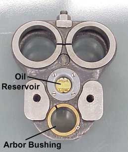

    I ran across these pics during my Sat morning coffee/web perusal and wondered if this adj. bushing setup from a horizontal mill might help snug up a worn tailstock quill. Pretty neat deal regardless.
    edit: Ahh, it just dawned on me; you'd have to rig up some way to push the bushing into it's tapered bore rather than pull like I 1st envisioned.

    Something like a taperlock ?
      That sort of thing occurred to me also. Nobody has EVER done it on any commercial lathe, as far as I know, although it makes a lot of sense if you are going to use (and wear out) the tailstock. Not even the very best makers I know of.
      That's a little odd, as it is the ONLY item which is both very hard to fix, and has no adjustment capability whatsoever.
      Possibly that is because the most usual means would put the 'works" up front right where you do NOT want the barrel to be thick and clumsy. So it was just deemed impractical.
      More likely, since it would be possible to reverse the system and have a narrow nose, it is because the makers figured that if you wore out the tailstock, you could just get another one from them , or alternately, that if you wore out the tailstock, the ways were probably down to a nubbin.
      Leblond had replaceable ways on at least one model, but I wonder if anyone ever did that, or if they instead just surplused/scrapped the machine when worn too far. Probably the latter. Tailstock ram could at least be locked, and most likely got moved a whole lot less.

        Yup! I just Googled "Taperlock"...very interesting stuff. Geez, the more I think I've learned, the more I realize I have left to learn.

          Gee, I mentioned this many threads ago, using a 5C as an example
          Lets reinvent the wheel....
          I have run a few horizontals that use that system for outer end of arbor...
          A tailstock with a wheel ( in center section of tailstock) to tighten up a pair of opposing collets, is just too simple of an idea to concentricly align a tailstock spindle/ram. Another wheel/ handle for tailstock feed....
          Would involve grinding both collet seats in, and would allow precision = to concentricity of collets and tail stock ram collet tapers/seats...
          Worn ram/spindle, just pop a new one in, let collets adjust for center... Test bar for scraping in, would just be simple OD ground round stock..
          Would be perfect for CNC, release collets, use ballscrew for ram/spindle/quill feed, lock collets.....
          Could even allow for larger than spindle hole diameter bar feed, from tailstock end...

            Quite some time ago I was putting new quick-connectors on the garden hoses. Those connectors - which have been around for years - are split/sawn radially in several places and have an end taper like an ER collet.
            The closing nut is similar to an ER collet nut as well. The nut it tightened to close the "collet" onto the hose. It grips pretty well.
            It struck me that the radially-slit tapered-nosed "split collet" and the male screw for the "collet nut" could be machined onto the nose end of the tail-stock. The pseudo "ER nut" could be made of any material, that is to hand that suits.
              Every one fixates on one end of tailstock.. Both ends need to be constrained.
              Headstock side will wear more, but if both ends are centered by collets, end of problem...
