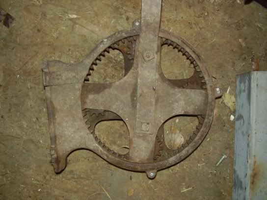

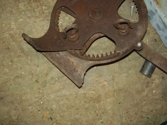

    At one time, cattle feed was put up in square bales, and grain was cut and tied in bundles. Both balers and binders used twine. Natural fibre twine was the only alternative, but didn`t keep well from season to season. Rope was always handy to have, so many farmers made their own rope from ball ends using assorted rope twisting devices. Eventually, they became commercially avaliable. Here`s one. All cast. There are inherent weaknesses in the frame and they are often broken. The broken part is missing. I need suggestions on a means of repair...

    Do you have the broken peice to put it back on? Do you wish to reenforce it?
    With a mill, Or possabley just an O/A cutting torch and drill, you should be able to recreate that part from a plate and some other bits of scrap.
      I'd probably just make an entirely new side plate out of steel, or even aluminum, but if you used aluminum you might need steel bushings for the hooks. If I'm interpreting the pictures correctly, there isn't anything complicated about the side plate.
      If you want to preserve as much as possible and repair what is there...you better get suggestions from somebody else. Brazing or welding thin-section cast iron like that is going to be tricky.
        First question: Do you want to REPAIR it or RESTORE it? If repair, it doesnt much matter what it looks like as long as it works. If restore, then you pretty much have to find the missing part and either braze or weld it and "make the seam disappear," and replace the missing fasteners with slot-head stove bolts and square nuts. It looks like it consists of a "handed" pair of castings that contains the planetary gears. There should be three planet gears, each driving a twine hook and, possibly, a central hook driven from the sun gear. If the castings are REALLY identical, then perhaps you could get a replacement cast in aluminum using the good one as a patern. Then flat black rattle can and only you and your hairdresser will know! Duffy

          Sorry, miss-counted the planet gears, and it is not a pair of castings. Almost looks like the carrier is fine, but the main casting is a replacement job. Duffy

                Getting the hooks out of the planetary gears will be a b*&%h because they`ve rusted solid after 7 or 8 decades of exposure to the elements. Still, casting a new side plate could prove very lucrative. One unbroken, but siezed solid sold at a farm auction recently for $250
                I have stick and OA available in my own shop, and have access to MIG. I may be able to do my own castings in Al too, if I get done some other projects and set up my backyard foundry again.
                  You may be able to find an artisan iron caster in your area. You make the pattern, they cast it.
