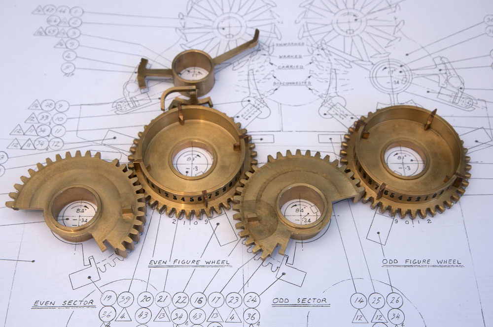

              I read the book and found the history of this interesting. Babbage can be given credit for pushing machines and machinists for more accurate and precise parts for his time. He needed gears that matched each other very closely and he struggled to find shops and people that could do this.
              I was lucky enough to have seen the machine that was built in the museum in London and also the starts for the second machine. The info at the museum noted that the second machine was to be sent to the US. They gave the impression that the machine would tour US museums before being on permanent display on the west coast somewhere.

                There was an excellent Scientific American article about the London Science Museum's construction of the Analytical Engine back in early 2000. They noted that the British government pulled funding for the Difference Engine No. 1, partly because it was very prone to jamming. Gears were hand-cut back then, so getting long chains to inter-mesh was hopeless.
                IIRC, the London Museum's gears are CNC cut?
                Thanks for the book citation Rock -- I remember that from the last time we discussed Babbage's machines. I'll have to get a copy.
                  I dont believe so, the book states otherwise. But I didnt see them being cut either.
                  The book does parallel the building of the machine in London with Babbages challenges. So looking at a time line the reader jumps back and forth as the chapters change. The writing is god enough that you know where you are on the time line. But, they do note that the funding required that the machine be built by a specific date and it must be built using processes of the time. They did allow current manual lathes and manual mills to be used. But there was so much hand fitting.
                  It was finished only hours (or a day or so) before the unveiling and when Doron tried to turn the handle the first time it froze up a bit. After a little checking they realized that it took just a bit more force than he was applying. After the first turn or so things set in and it was reported to turn fairly easily.
