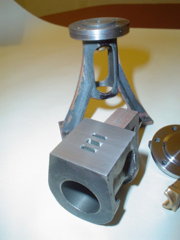

    Hi guys, Iam still practicing how to send these illustrations of my engine
    Once i master this lark L.O.L. You will have no peace (This shows port face of engine cylinder

      The engine is a Stuart Turner No 10v, i have had the castings lying by me for some time, &started building about 6 months ago, but time has been scarce, The cylinder port face, is the finish straight of the shaper,using a broad tool, The shaper used was a little Adept No 2, Which some time ago, was illustrated on the site for me, by the late Jay Hahn, which was i thought at the time a most kind obligement, I wish he could have managed over to the U.K. as he was most keen to meet me
      Back to the cylinder block,-- Before i start the fitting i will scrape in the port face, The finish at the moment is good, But i believe in finishing these faces by scraping, as one gets a nicer running engine.
      The crankshaft is5/16" dia, i have milled a keyway for the flywheel, and will later mill one on the other side for the eccentric,

        Is it possibel to include something as a scale
        of size...just a referance?
        Perhaps a quarter, dime or many be a small
        machinists 6" ruler.

              I built a Stuart 10H about 40 years ago, which is the horizontal version of this engine. From memory, it's 3/4" bore and stroke, which'll give you an idea of the overall size.
              I remember wrecking the crankshaft forging when machining the crankpin, and then making a new one out of a Morris Minor halfshaft.
