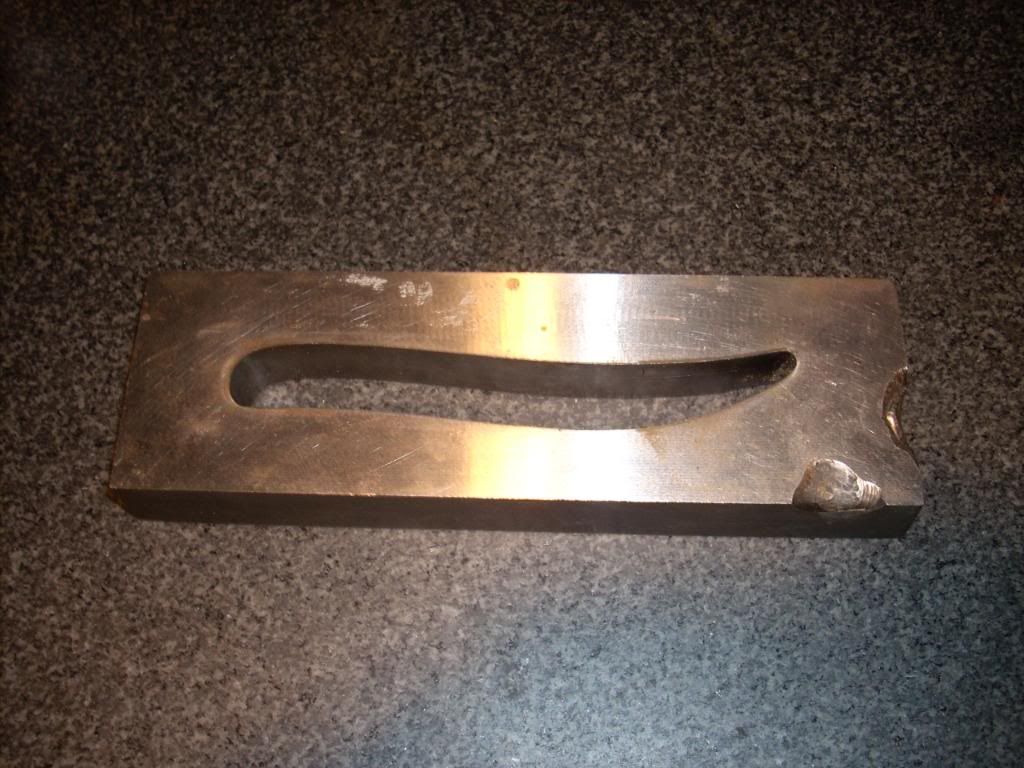

    I figure I would share project that took up 5 days to do. You'll understand why it took so long to do after all the pics and the way I had to do it.
    I had to replace a die section for an old trim die that was back in 1919.

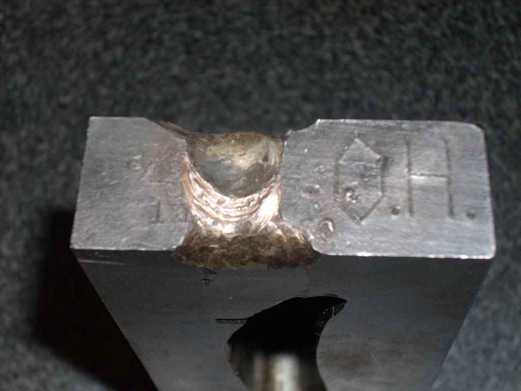

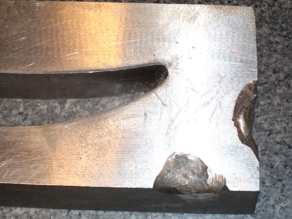

    The die section has been welded a couple of times and breaking through the weld again
    Here is a pic of the end of the other die showing it's age
    Another of the nasty welded job done on it
    One of the things that made this project a little tricky was the fact that the punch is tapered bigger towards the punch holder.
    Because of this I had to open the clearance up on the die section to specific point on the punch.
    Normal our die are made out of house, but this time they wanted to save money and had me make it. A lot of this project was done by hand. So it is a little tricky getting it to where you want. Our dies for this for this process are made with 0.0005" to 0.0015" per side of clearance with 1 degree of taper in the opening to allow the part to fall out.
