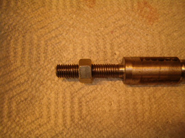

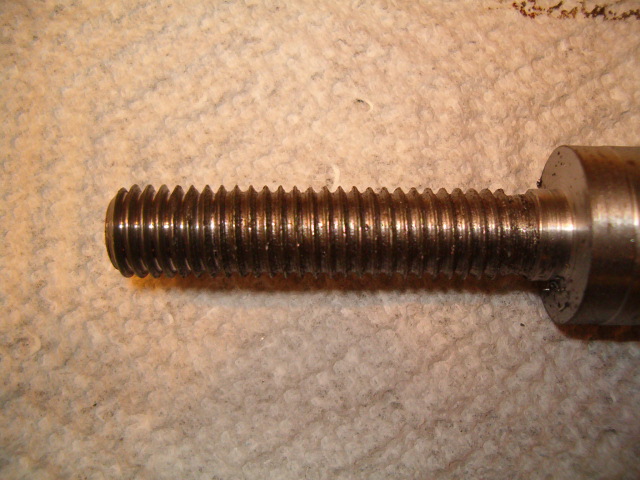

    I finally decided it was teach myself how to single point threads. I ordered a little center/threading gauge and read up on the operation and decided to give it a stab.
    The thread I cut is 1/2-13, all went fairly well, but here are the questions:
    1) How do you know how deep to cut the threads? I just kept test fitting a nut (which didn't fit, more on that later)
    2) Do you feed with the cross slide, or compound? I had the compound set at 29.5°, but the way I see it, if I feed in with the compound, then my cutter will not be in the same position as when originally synced up with the lead screw/thread dial. I fed with the cross slide, maybe that's why it didn't come out perfect.
    3)I kept test fitting the nut, I got to a point where it would thread on 2-3 threads and bind. I finally decided I was doing something wrong, and in an experiment, removed the piece from the lathe and threaded on a 1/2-13 die. My thought was that I would see where that cut, and be able to determine if it was a pitch error, or depth or what. I ran the die down the first inch or so, and it cut a little, but not much, the pitch was right. I tried to thread the nut on, and it threaded on all the way, past the part I cut with the die, and down to the single point part. It was actually a bit loose on the lathe cut threads, but it did not bind at all. I'm guessing that the unsupported end of the work was deflecting enough in the first inch that I never got the root of the thread deep enough. Does that make sense?
    Here are some pictures, you can see the difference in the die and lathe threads in the second picture.

    Looks to me like you don't have a sharp enough point on your threading bit. The bottom of the threads look a little rounded and shallow but they still come to a point at the top of the thread.
    From what I have read on most threading topics is it is a good idea to use a livecenter on the tailstock when threading anything longer than 1.5" or so.

        You can look up the minor diameter and cut to that but I just do what you did. Have a nut handy and start trying it when the thread looks like it's getting close.
        Everybody says feed with the compound set as you described. The thread stays in sync, you just end up cutting with only one side of the tool instead of the whole edge which tends to chatter. Some say cut the last cuts with the cross slide but very small cuts.
        I get that too and think you are right. The threads are usually looser near the chuck.
        I couldn't see your pics. 1/2-13 is a pretty solid workpiece, I did one in brass but haven't tried steel.

            A big problem with test fiting is burrs, if you get a burr rolled up at the start, a nut may bind on the burr, when infact its clears the threads fine and you just needed to remove the burr.
            Deflection is another problem, but it can be minimized by taking several 'spring' passes along the work (Usally just for the final passes), that means taking a few passes and not moving the tool in any, as then the 'sprung' areas at the end get recut as they are pressing against the tool, but the supported areas near the chuck do not because they where cut to the proper depth the first time.
            You can find some cheap 'thread pitch' micrometers on ebay ($30~ each, covers 1 inch range per micrometer) that will let you messure the thread height/depth
            Or you can grind some cheap metal calipers (the manual spring kind used to transfer messurements to a ruler or a digital caliper) to have a sharp profile to fit into threads.
            Test fiting with a nut is quick and easy and works well for loose fit, but nuts vary (You might be using a loose nut, and the rest of your nuts are tighter), burrs are annoying, And messurements never lie (they just get done wrong sometimes!)
            PS: your thread finish looks very good for a first time in mild steel, My first few threads finish was so rough it looked like some kinda file, I was impaitent and expected my giant lathe to be able to move lots of metal in each pass.
            Yea, it did allright, but the metal that remained did not enjoy the process. :P
