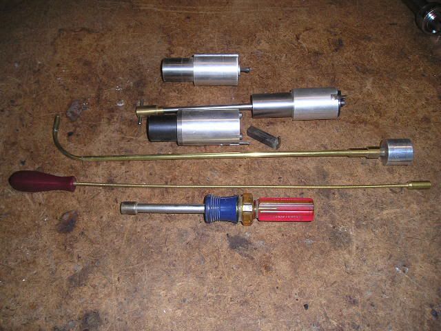

                  • I used to bore and sleeve Amal carbs. At the top is the fixture for turning the sleeve down to size after installing it on the slide. Then two boring heads to bore the body out. The long brass thing is a tool for adjusting the idle mix screws on a Gold Wing. Next is a flex tool to get at the mixture screws on a GM carb. The bottom one is a tool to adjust the slides on Keihn carbs. A hollow nut driver with the handle cut off and a thin screwdriver down the center.

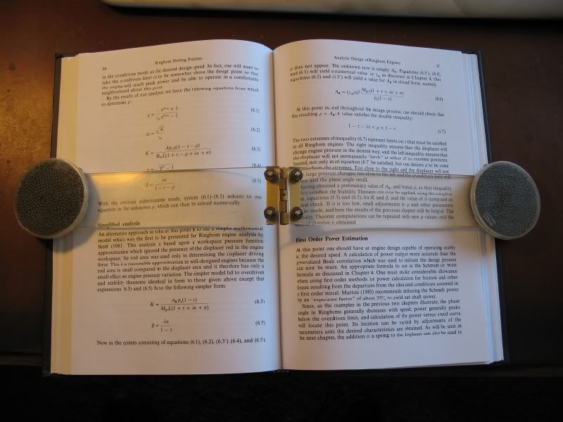

                    • A device to keep books open on the workbench. Made of clear plastic so you can read through it.

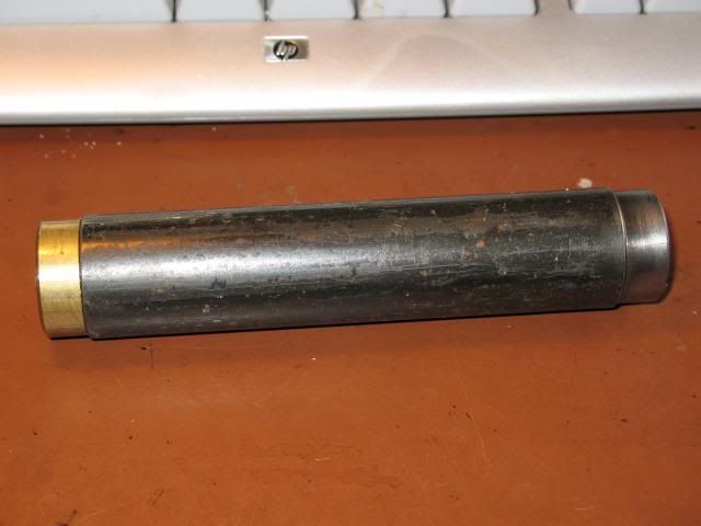

                      • A hand hammer for working in confined spaces. It's a length of black gas pipe with one steel and one brass face. Fill 2/3 with lead bird shot before attaching faces.

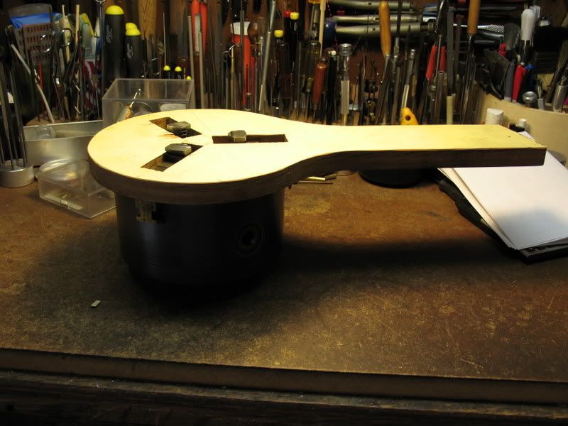

                        • A plywood "banjo" wrench to remove stuck 3jaws. The design provides high leverage and distributes the load unto all three jaws to avoid damage.

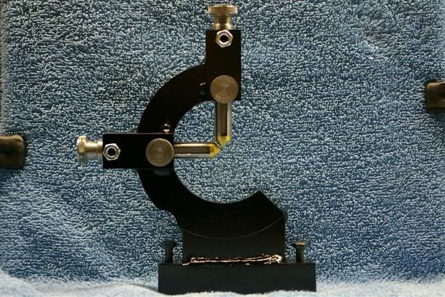

                          A low profile marking gage that can get down to less than 1/4" above the surface plate.
                          Adjustment is accomplished by rotating the cylinder that carries the marking point.

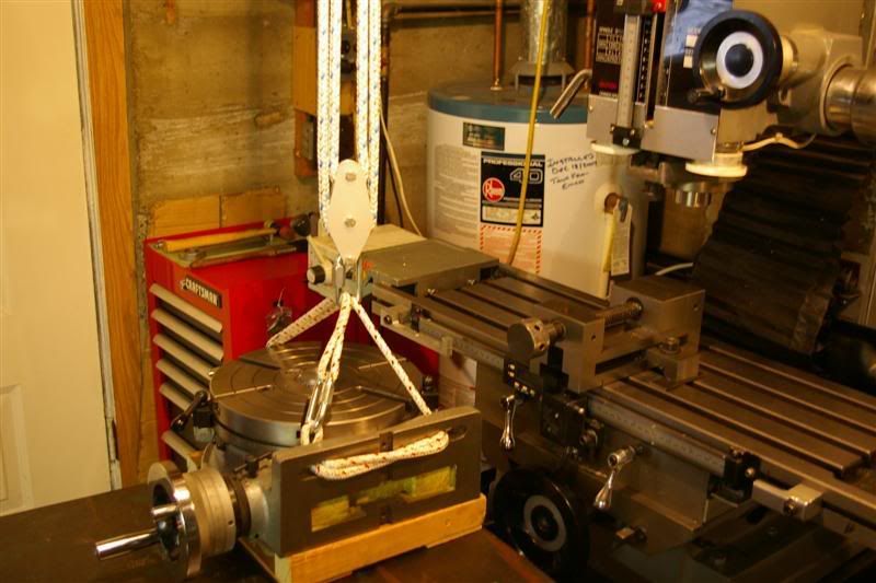

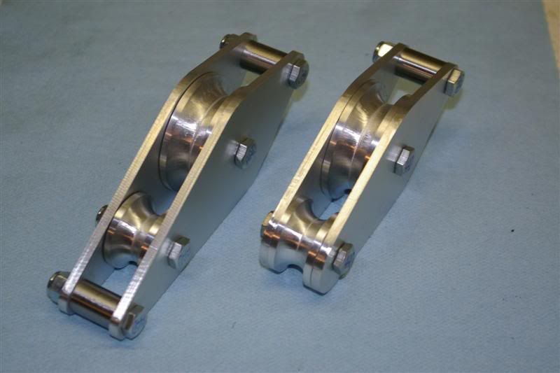

                            And a block and tackle system for lifting my rotab onto the mill and back off

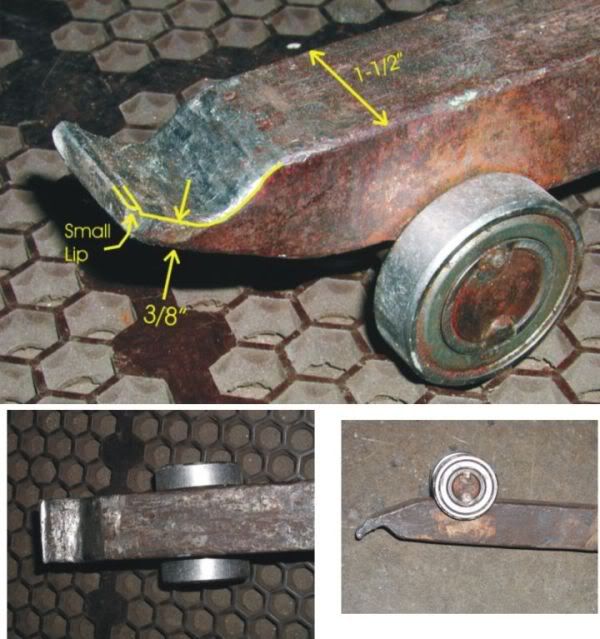

                            • Electric motor shops generally replace bearings on motors and good chance they will give you some. You would think a arc weld on a bearing would ruin it, and sure it would for high speed use. Never have had a problem with low speed use such as making wheels out of them. Pry bar with 3 or 4 foot handle will lift a heavy machine and when up pivoting the handle to right or left will move machine an inch or so for getting into or out of tight spots.
