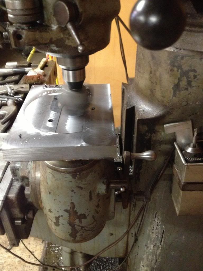

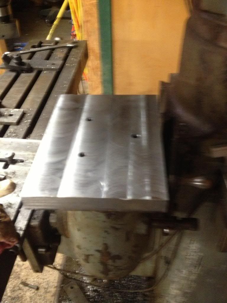

    face milling table
    Table milled...Still need to add a couple of t slots and a few tapped holes
    The head is trammed by screwing in 2 adjuster screws you can see on the vertical plate....The pins have .005" clearance to make them slide in easily,so I drilled the holes with the plates .010" out of square so when they are brought to square during tramming,the pins are bound making for a solid mount...The dividing head rotates,so it is trammed in the outher direction by swiveling it....
    So there it is....$30 worth of hot rolled steel plate,a couple of nights work,and I have a vertical rotary table with excellent dividing capabilities!!!!

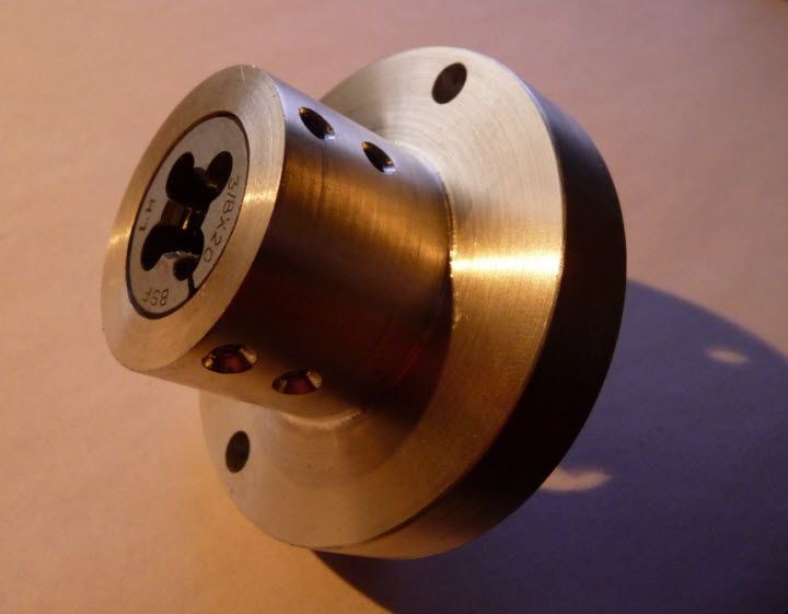

    • Dieholder for long stock on the Mini Lathe
      When I decided to buy a milling attachment for my 7x16 Microlux Mini Lathe I came to realize how short the cross travel was and also how limited the use of a milling attachment was. I decided to extend the cross travel with 1" before the centerline and 1" beyond the centerline, which meant that the cross feed screw had to be extended by 2". Since I am still a novice machinist I decided to fabricate 2 extended cross feed screws, one by threading with a die and one by threading with the lathe. In the end I was going to choose the screw that fitted the nut the best.
      Threading a A2 tool steel rod on the lathe was quite a challenge but also a great learning experience especially since the thread was left hand. Due to the length and the springiness of the 3/8" drill rod I was threading I had to use both tailstock and the follow rest in order to get a decent thread and consistent major diameter of the thread. Without the follow rest the diameter would be smaller in the middle of the screw due to the rod's springiness. In the end, and after several attempts, I ended up with a new cross feed screw that did fit the nut smoothly and with no noticeable backlash.
      For my second attempt I did eventually find a 3/8" - 20 TPI LH Die overseas. I could of course not use my tailstock mounted die holder since it limited the thread length to a few inches only. Nor did I want to thread by hand for such a length using a die stock. Eventually I came up with the idea to make a sliding die holder that would guarantee that the die was perpendicular to the rod, both horizontally and vertically at all times. I used the steady rest, stripped from the finger assemblies and the bottom locking nut, into which I inserted a home made die holder that screws on to the steady rest. With a hand crank in the spindle I can now thread the rod and the freely sliding steady rest keeps the die absolutely perpendicular to the rod at all times.
      I made the die holder out of 2 3/4 round aluminum that could fit 1 1/2", 1" and 13/16" dies. The holder was fitted to the steady rest from the back by 3 M6 screws. The mounting surface on the steady rest was slightly ground in order to make it perpendicular to the center line. Then 3 M6 holes were drilled and tapped in the steady rest.
      The threading operation with the die was a breeze compared to machine threading. After a few passes and adjusting the die I finally achieved what I consider to be class 3 fit with the cross slide nut, much better than the original screw and nut. Now as an extra benefit to having an extended range for the cross slide any trace of backlash has disappeared.

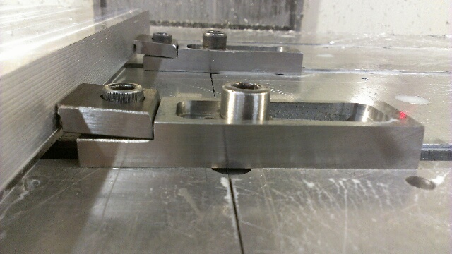

        • I have it posted on my blog at http://zero-divide.net/?page=FrontPa...rticle_id=4297
          Basically these are toe push clamps made out of D2 plate.
          There is a tapered slot for 1/2-13 screw.
          the front is tapped 3/8-16.
          I get huge clamping force with those.
          Total manual machine time for 4 pcs- 2 hours.
          Sure beats buying mitee-bitees for 175$ a pop

            Zero, is there a specific angle that the front plate ends are machined at? I would like to build a set of them for several upcoming projects.
            Dan.
            Lu47Dan
            • Originally posted by Lu47Dan View Post
              Zero, is there a specific angle that the front plate ends are machined at? I would like to build a set of them for an upcoming projects.
              Dan.
              Not really.
              Conunterbore is drilled and machined flat to the top and bottom faces.
              Back angle was ground by hand (Yuck) on a disk sander until slosing action felt right it ended up being a lil less than 15 Degree.
              That shoulder with 3/8-16 hole is 1" long. and 0.3" tall (in my case). Hole was drilled undersized to 0.298" instead of 0.312" and tapped 3/8-16 very carefully to not snap it by hand- i wanted as much as possible engagement with the screw.
              Tapped Hole is 0.5" away from the corner.
              Same with the counterbore on the jaw, its 0.5" away from the back face.....
              On the "business" end of the jaw i very crudely cut out a relief in the bottom- this way it is only clamping with top 1/8 of the jaw- smaller point of contact allows clamps to bite in deeper into aluminum (primary use in my case)....
              I used a 5/8" d2 plate because that's what i had.
              I wanted/should have used (and advise you too) to use 1" or eatleast a 3/4" thick bar , 1-1/2" wide
              As you can see i have some bend in my clamps when they are fully tightened. One might suggest that's alot of force to lift those ends like that!
              But D2 is tough enough to return to flat once the load is removed.
              Also make sure you make an effort and make that slot for 1/2-13" screw tapered- this will prevent your assembly from sliding under load.
              Also if you go that way turn your self some 0.25" thick washers from O1 or D2 round stock- those will protect slot and screw from being damaged.
              Its easy to make those clamps and honestly i don't see a reason to actually buy any brand-name push clamps anymore.
              You could buy some pre-made pre-hardened strap clamps and save your the trouble or removing alot of material - just mill a shoulder, drill and threadmill thread, and add tapered face to a slot
              Good luck.
