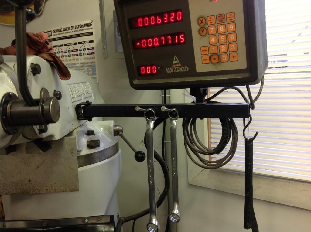

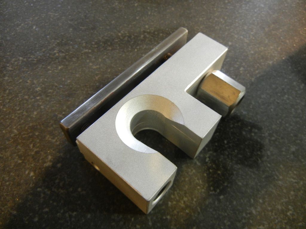

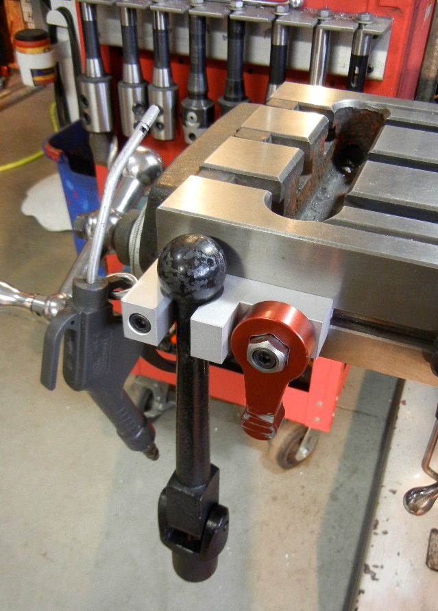

      • A quicky Milling Machine Accessory. Got tired of clunking around with that vice handle.
        • Excellent idea, Hammerfest.
          That may be reason enough not to occupy the table front-edge slot with a DRO scale!
          • And I'm going to use that R8 tooling rack in the background as well!!

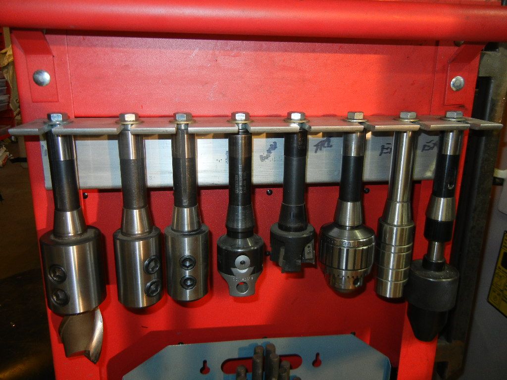

              • Originally posted by Wheels17 View Post
                Looking at that.
                Do you have to screw / unscrew those studs in the tail every time you change a holder ?
                • They are simply 7/16-20 bolts that I hand tighten, nothing fancy here just a plain old piece of aluminum angle 3x3 and about 20 minutes and your done. Keeps stuff from getting banged up in a drawer.
                  • Sorry that would drive me mad having to keep screwing these in and out.

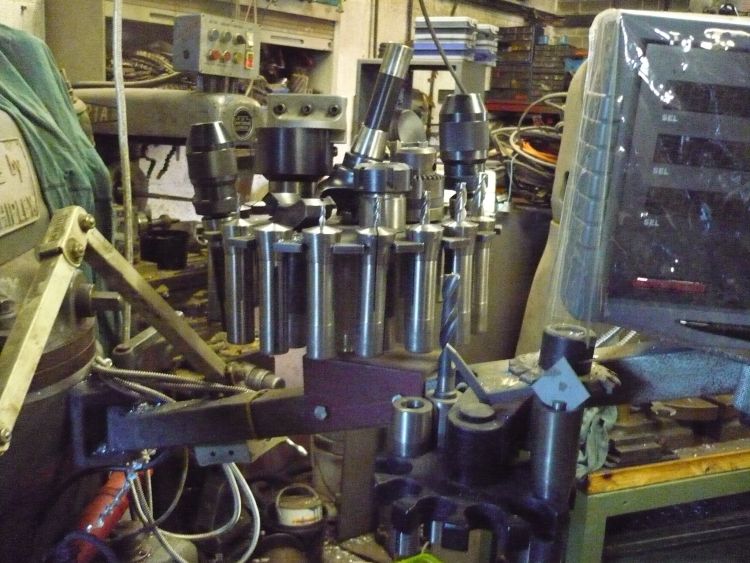

                    Here's mine.
                    The bottom one is a plastic commercial one from J&L which works OK for empty collets but not full ones or tall ones or it doesn't rotate because it hanging off the pivot bolt.
                    So I made the upper one out of 6mm laser cut steel and held it from below. Open keyhole slot round the outside so you just have to lift the collet up to the waisted section and it then pulls out. Because the weight of the collet is enough you can leave cutters in without them sliding back thru so all the popular sizes are already racked up to save many minutes over a week on jobbing work.
                    Bigger heads sit in holes around the centre.
