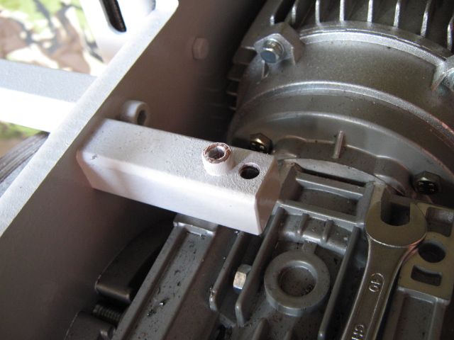

        • This is my little bandsaw recently made. I had it apart for painting after some testing and use so it is looking its best today.
          It takes the same blades as the 4 x 6 bandsaw that we all have and love and is slow running for cutting steel. 9 1/2" (240mm) throat.
          The main plate, legs, table and wheels are laser cut. then ~8 hours machining, assembly and fine tuning.
          There are more pictures if wanted and an untidy cad file too. Anyway, the pics.

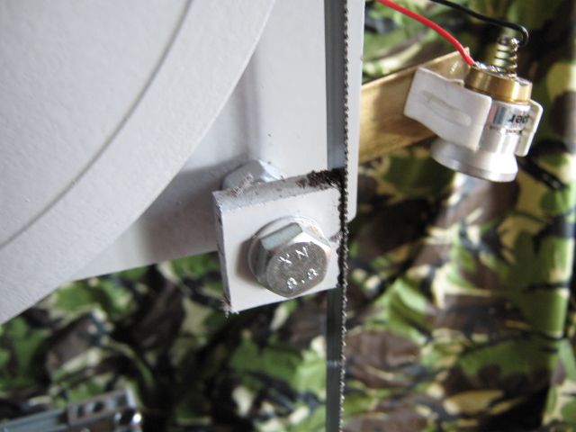

            Very nice. Well wear! Is that mobile-phone transformer powering a laser diode to show the cutting line?
            • Originally posted by Euph0ny View Post
              ...not so exotic. just an LED flashlight module

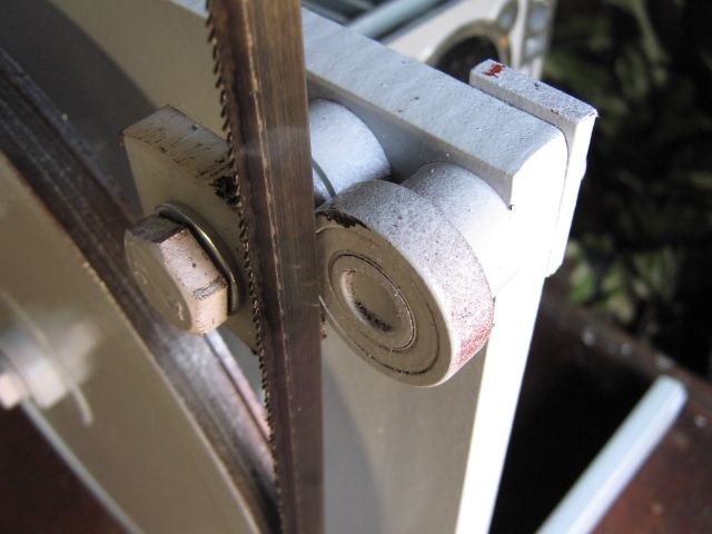

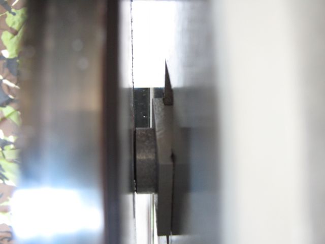

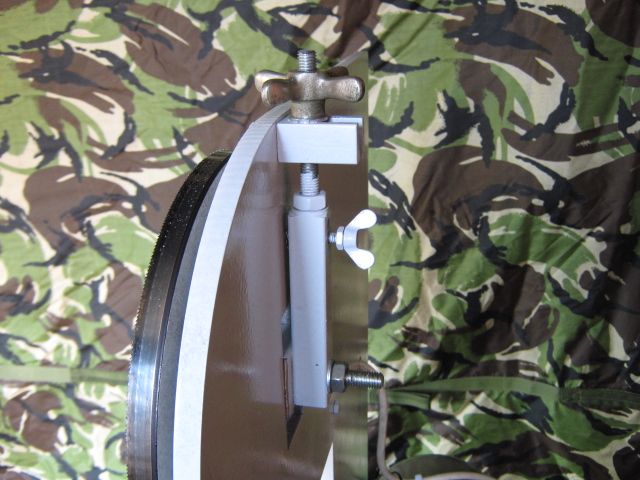

              • Very interesting design, looks to be quite substantialy built. The last pic of the upper guide, am i missing something there, doesn't seem complete w/no outer support?
                • Originally posted by sasquatch View Post
                  No outer slider. The square block is nylon and applies ~2mm preload so it runs tight. I havn't added a thrust bearing to the top either as I see most of the work being done at the bottom 10mm. It is a slow runner and the blade is well controlled with these guides.
                  I had fitted bearings initially in place of the sliders but the noise of them rumbling would put your head away.
                  Yes, maybe too substantialy built. This is a bit heavy. Next time the wheels will get spokes, table thinner and the frame lightening holes.

                  • Dave, what Rpm is it running?
                    • 1400rpm > 20:1 reduction > 250mm dia wheel > 55 M/MIN......~180 feet / min

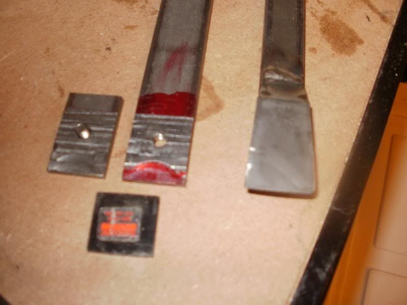

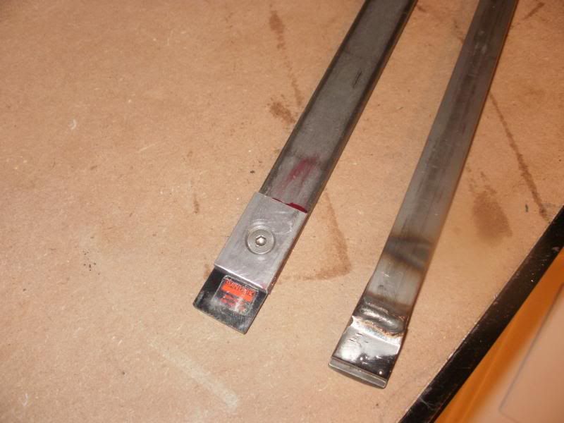

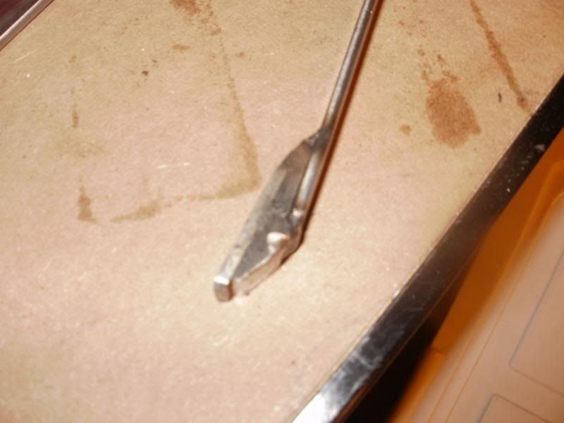

                          • Quick and Dirty Scrapers
                            Knocked these out after work the other day. As I have some of Sandvik's 630-2525 scraper blades and I didn't want to pay the going rate for a Sandvick or Dapra handle I ran up a quick one. Nothing fancy, didn't even do any chamfers on the edges. Pretty can wait. In the commercial handles the blade actually bears against two points on the outer edge of the pocket. Blade and Clamp both milled 1/2 the thickness of the blade with the clamp being milled .02 to leave a high point at the end away from the blade. Secured with a M6x1x10 Flathead Cap Screw. The other is made using a tungsten carbide tile from a decanting centrifuge. These tiles are made by VR Wesson and others to provide wear resistant surfaces on the internal conveyors. Near as I can determine the grade carbide used in these is very close to the C5 grade for cast iron. It needs to be honed some more but even roughing out on a green wheel it cuts fairly decently. We have a lot of these tiles that have been removed from machines in the course of repairs and I have had the idea kicking around for awhile
                            Spin Doctor
