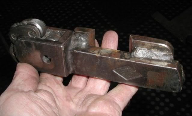

    I made this indicator holder,
    Hello everyone. First time poster here. Awesome forum. Teenage machinist great indicator holder. Would you care to share some of the construction details of this holder.
    Thanks,
    John

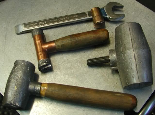

    • Copper tee is good start for a lead hammer. Use bolt in handle end for screwing a handle on.

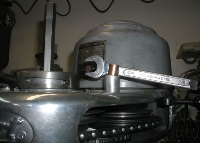

      Draw bar wrench has hunk of slotted copper pressed on wrench and aluminum socket bolted to mill head keeps wrench handy where needed. Draw bar has extra long hex which is nice for changing collets when quill down but main reason is points on the hex are used for a pickup for spindle speed tachometer.

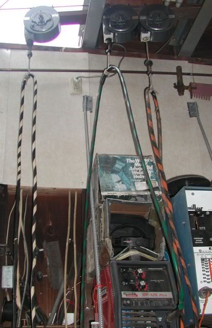

      Like John Stevenson, my shop has no floor so have to hang welders on wall. Having 3 different welding leads was confusing and easily tangled up. From junk yard was able to get some electrical cord reels that were broke. Put rope on reel and tie rope to center of welding lead. Can pull lead down for use and retract for storage.

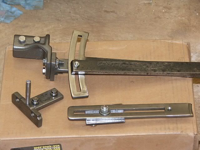

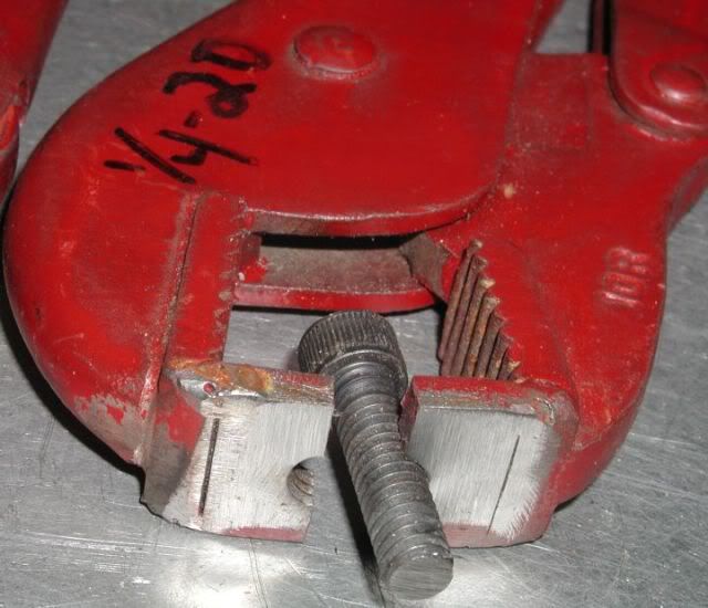

      • Holding onto screw threads sometimes can be a problem. Like the Vise-Grip ones best. Some day maybe add a adjustable stop back in the jaws so can shorten bunch of screws to the same length. They work good for removing studs all so.

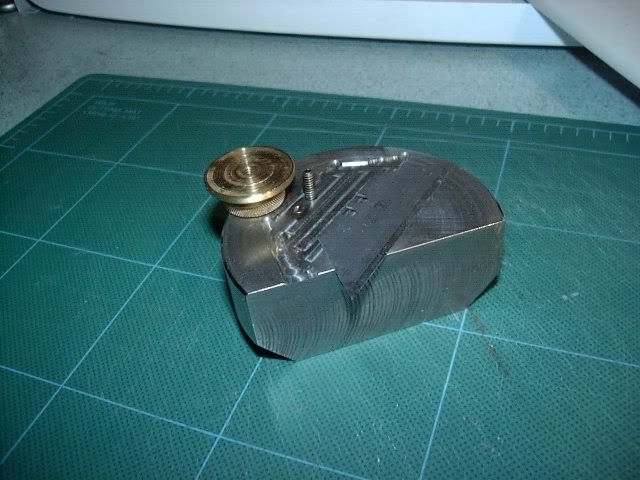

        Hows 'bout this for a hack job. Weld on dovetails for tool holder. No dovetail cutter required.

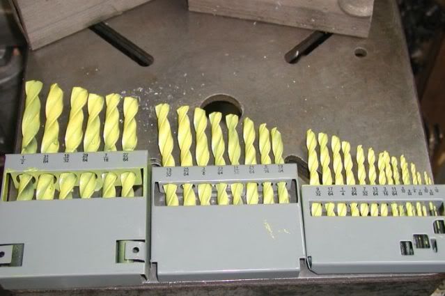

        Cheap ten dollar on sale at Horrible Freight drill bits, not good at drilling steel. At least the set I got wasn't very good steel or temper. They do good on brass. Grind or stone the sharp cutting edge for a negative rake for a non grabbing bit on brass and spray paint yellow for brass use only.

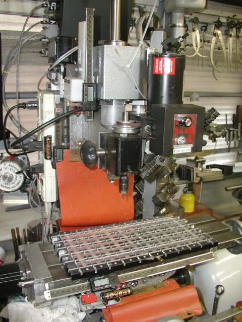

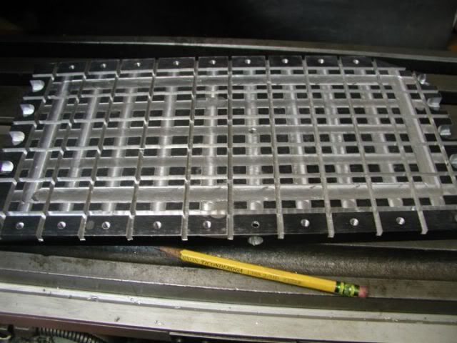

        • Small aluminum vacuum table. Seen example somewhere and looked at some web sites. The black areas are support for the work and milled out area is for vacuum. The milled out 1/8" wide grooves are for gasket material that will form a zone for the vacuum. Gaskets are put in grooves according to the size of the work. Used a horizontal mill cutter for the 1/8" grooves but if was to do it over would cut the grooves on the table saw.

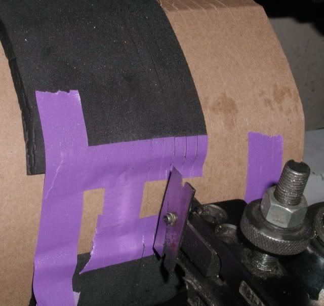

          Found some 1/8" thick closed cell foam and to cut them to correct width the lathe was used. Tool holder holds a razor blade. Hunk of pipe is chucked up and layer of cardboard taped on and atop the carboard the foam is taped.

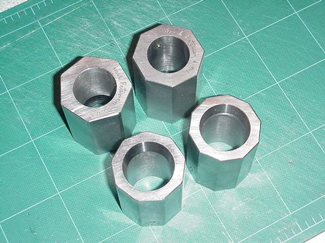

              Odd sided 5c Collet Blocks. They're in Tip Book #1

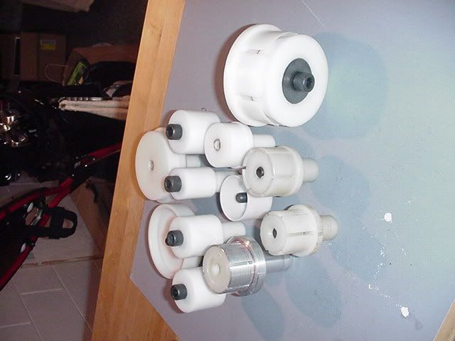

              Delrin Expansion Collets and Spigot Chucks

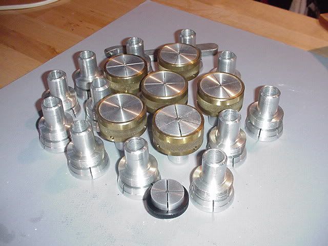

                Shopmade Emergency Collets and the commercial one that inspired them

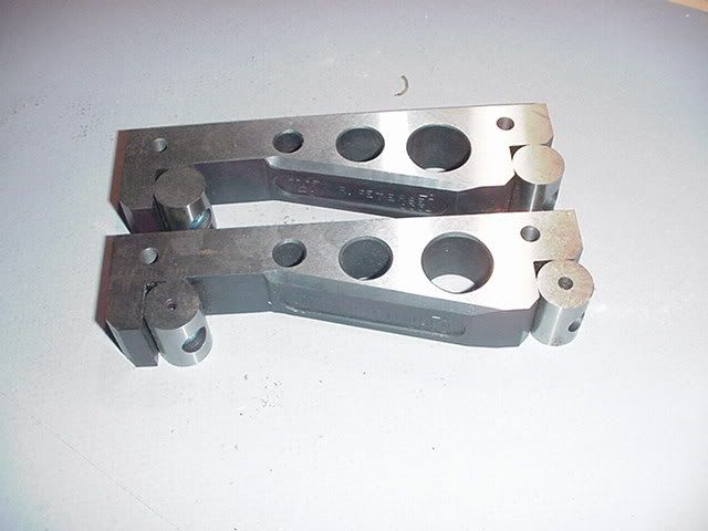

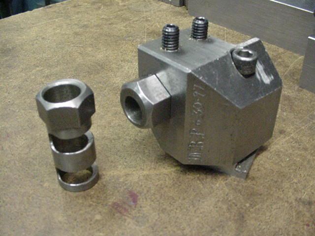

                Boring Bar Holder for a Hardinge HLV-H with excentric bushings

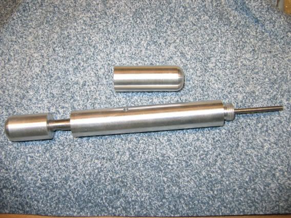

                          This tool removes the pins from a Souriau 23 pin circular connector

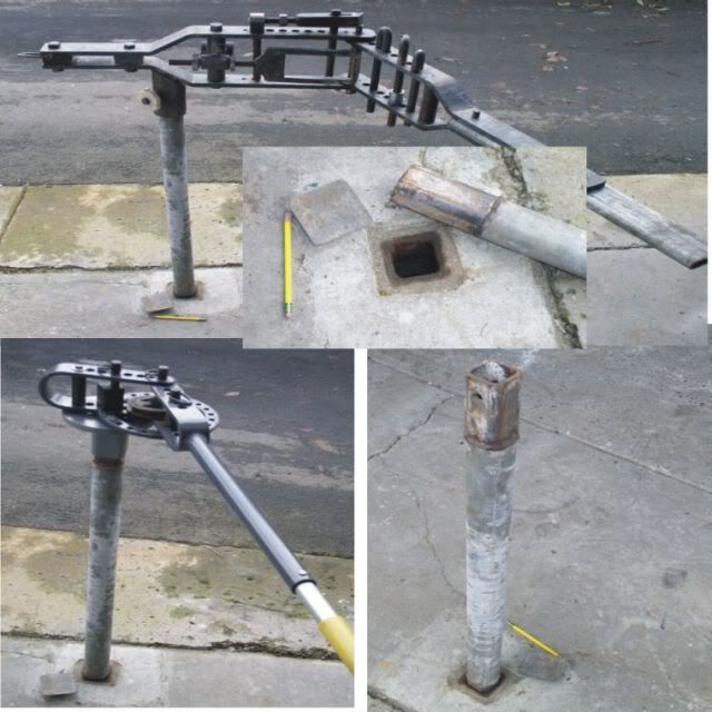

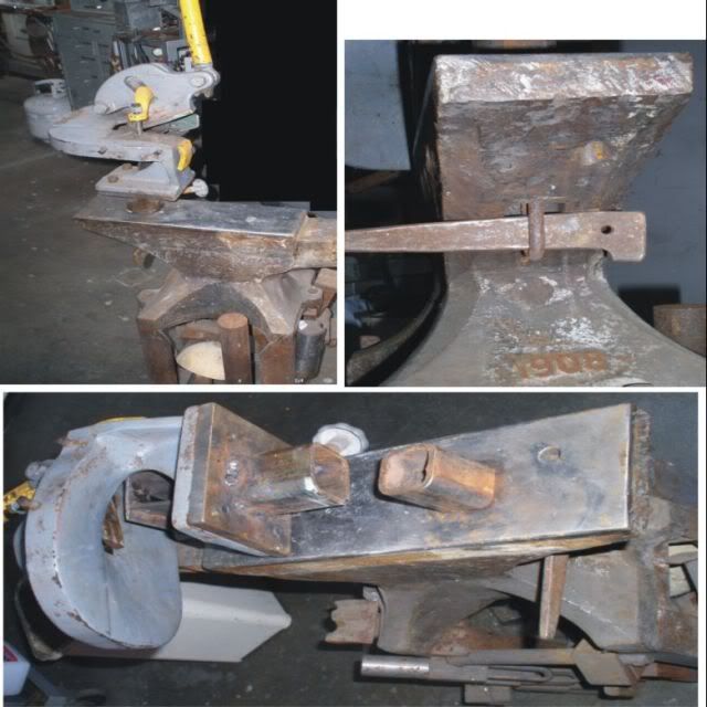

                          • Had made a copy of a Hossfeld bender. They take a fair amount of clear area to use. Too solve the problem a square hole in the driveway was made. Used section of trailer hitch receiver material and pipe welded onto that and cemented in. Too much torque on tube caused tube to twist in the ground and had to redo. Driving bunch of scrap iron at 45 degree angle in hole and allowing the new cement to tie welded on metal by the concrete. No more problem even when using 4 foot cheater bar.
                            Post made up that had square trailer hitch tube on both ends and benders, vise and more can be put atop post. Receiver attachments are tapped on one corner and one bolt with hand knob will tighten attachment securley.
                            Made adapter to fit anvil hardie hole so throatless shear can be used there and easly removed to have access to full anvil face.
