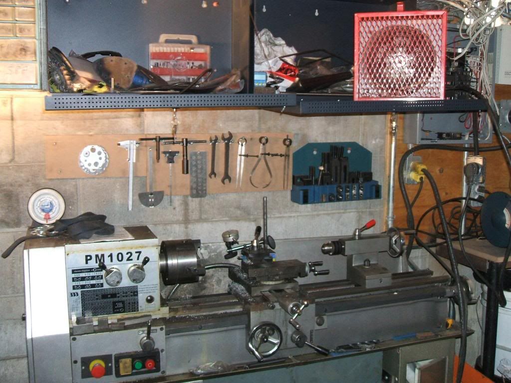

  • Stern, how do you attach a chuck to the spindle of your lathe? I tried Googling the model of your lathe to find info on it but got a bunch of unrelated junk (no offense meant). Can you provide a picture?
    Chuck

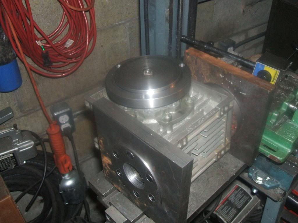

    • The chuck bolts onto a plate (part of the hollow spindle) using 3 bolts from the back
      Here is a pic of a "clone" of the plate I made for my indexer so I could use the lathe chucks on it.
      The tree holes are used to bolt into the chuck. Below is a pic of the lathe with the 4 jaw chuck on it (which has a second adaptor plate to change from 4 hole to 3 hole bolt pattern). I think the bore through the spindle is around 1 1/8"

      • Stern, is there any kind of taper in the spindle? You should be able to make a socket for R8 or MT2 or MT3 collets for your head stock. There are plans available for C5, and ER type collet chucks also. If you can copy your spindle nose/flange for your RT, you can make a collet chuck for the collet of your choice!

        • Going to take a closer look at it today, not sure if its tapered but have a feeling its a straight bore. Would be nice to make something up as I did just get an R8 ER-40 collet set for my mill (and I love it, makes things so easy). Going outside soon to check out the new vises I got for the mill (5" precision and a 5" sine vise) and will see exactly what that spindle is.
          Edit
          Well, checked it out and using an inside caliper it does seem to have a taper best I can tell, but the data on the lathe doesnt say anything other than a 1 1/16" spindle bore ? Going to have to take the chuck off for a better look, and if it does have a taper (looks that way) going to need to figure out what taper it is. Here are the lathe specs listed on a sales site

          • stern, There is a manual for your lathe here: http://www.busybeetools.com/pages/Manuals.html
            The lathe shown in the manual is a different color to yours, but I'm sure it's the same machine, just BusyBee's nomenclature on it.
            The manual states the headstock has a Morris Taper #4, and the Tailstock is a Morris Taper #2.
            You could turn both of these tapers on the lathe.

              Thanks for the link, checked out the manual for the one closest to mine, sure looks like they were made the same (at least related lol). Going to pull the chuck today if I get time and validate the bore, and if it is tapered figure out what it is (probably MT4 as the other manual states). I guess then all I would need to do is get a MT4 (if thats the size) "something" and turn it into a ER-40 collet holder (guess I need a draw bar too)

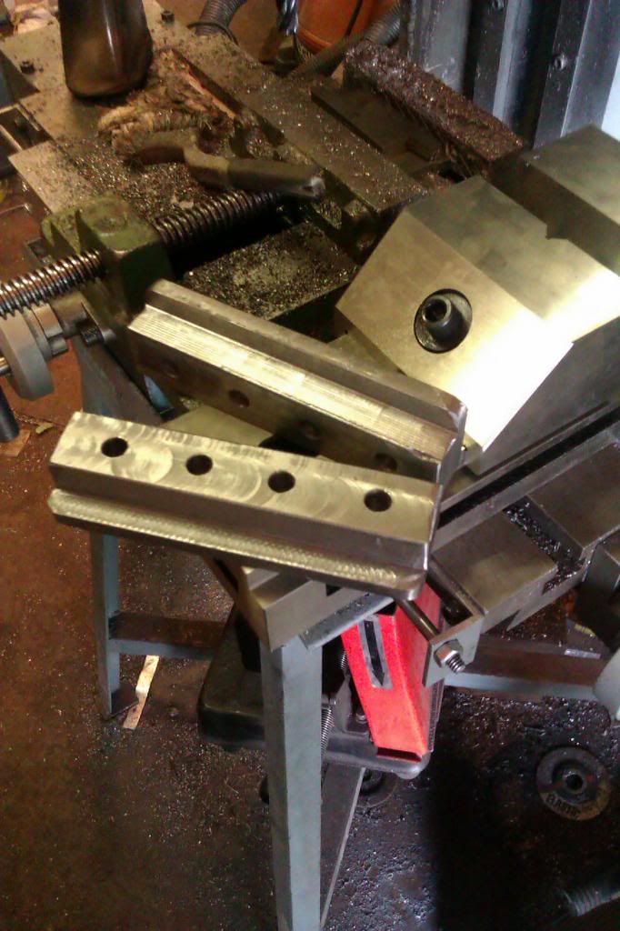

                      • I've got my CNC mill drill in a usable state and decided it's time to dive into learning new software. I decided a speed handle for my 5 inch vise would be a good starter project.
                        To make it more usable I'd either make the brass handle longer or allow it to freely rotate.
                        • Got some time to make some mounting brackets for the new vise. Grabbed some scrap 1" plate bits and milled them down (which was a bit of a pain as the crap vise I have now likes to lift the work when the jaws close). The new one may not be a big CNC vise, but hell its 5 times heavier than the one Im stuck using so defiantly and improvement.
                          Now I just have to make some T-nuts to fit the table, as the 1/2" set I have a re a bit too big.

                            • Harvey, I think I need one of those. Very much. <3
                              Thatcher, I agree with VPT. Done that a couple times myself. If I was worried about clamping force, I put a strip or two of a cut-up Coke can between, as spacers.
                              • thanks! i will totally do that for the next ones. iv been making a lot of aluminum shavings since i made the boring bar and cut off and am pretty much just learning as i go. should i drill and tap? or drill through so i can bolt them down to a plate?
