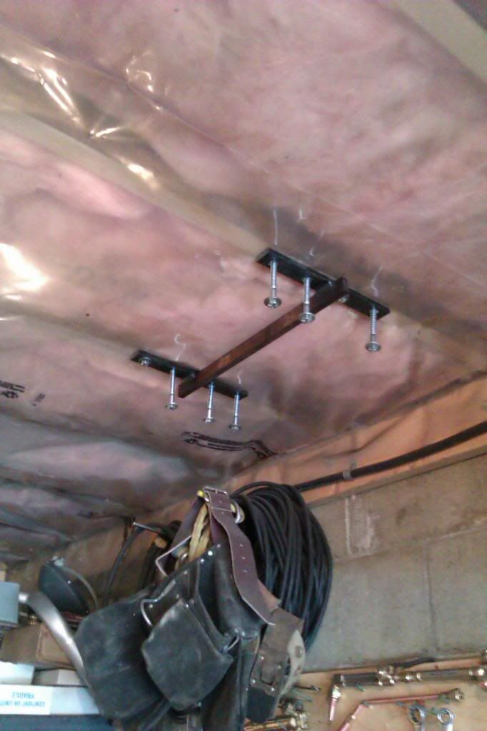

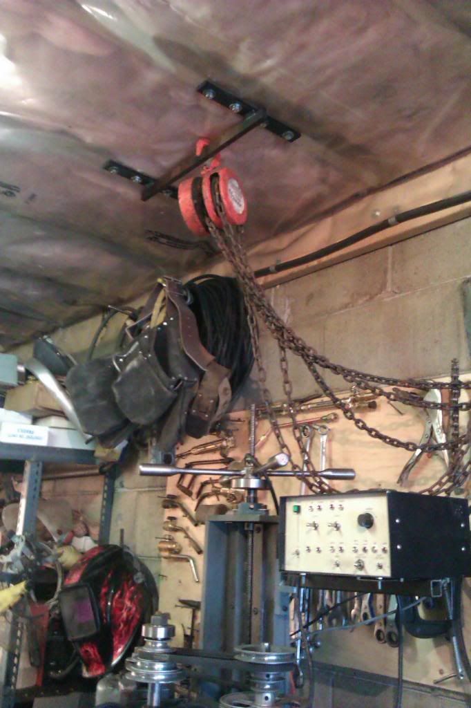

              • Not really a tool per say, but a project to make improvements on my mill. Since the garage floor is not what anyone would call flat, I decided to make adjustable feet. Had no problem making them from 5/8 bots and 3/4" plate, but getting them on was a different story. Things too heavy to lift or try tilting, so after failing with a jack I decided a hoist would be better.
                Hoped that the 3/8 x 4" lag bolts would hold well, as I wasnt worried about the 3/4" steel bar bending.
                Worked like a charm, allowing me to lift it enought to get the bolt feet on. Figured I will leave it in place for future times I may want to move/dissect the mill for improvements.
                Next, brace the bottom and put a shelf there to take all the flex out of the legs, then make a coolant tray for under the table.

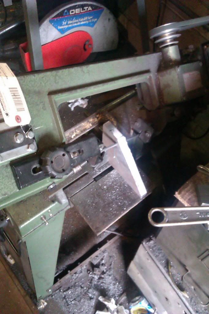

                    • Well, after being in the shop and getting bored, I looked at the pile of steel that was once a HF 3 in 1 bender/sheer/roller and decided it was time to make it work .... but not like it was before (was a piece of crap that wouldn't do anything with sheet metal thicker than tinfoil). So, I am going to make two units out of the bits, a bender and a sheer, both designed to fit in a hydraulic press. This means I need to make my press with an inside gap of 4 feet, so looks like its time to go shopping at the scrap yard for some channel and I beams.
                      The bits are beefy enough to bend 18 gauge and probably stainless, but the mechanism was a joke. This way both "bits" will use downward hydraulic pressure and eliminate the stupid swinging offset arm idea. I miss not having a bender and to a lesser extent a sheer, although I mostly use the plasma cutter now.

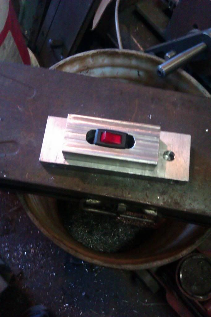

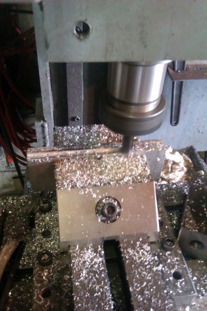

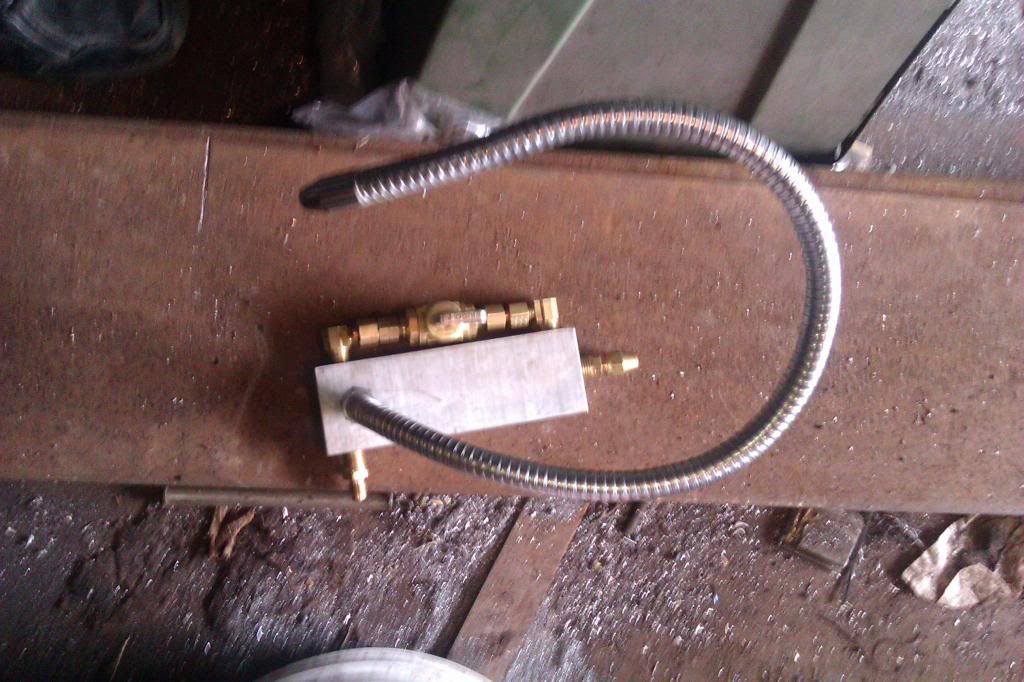

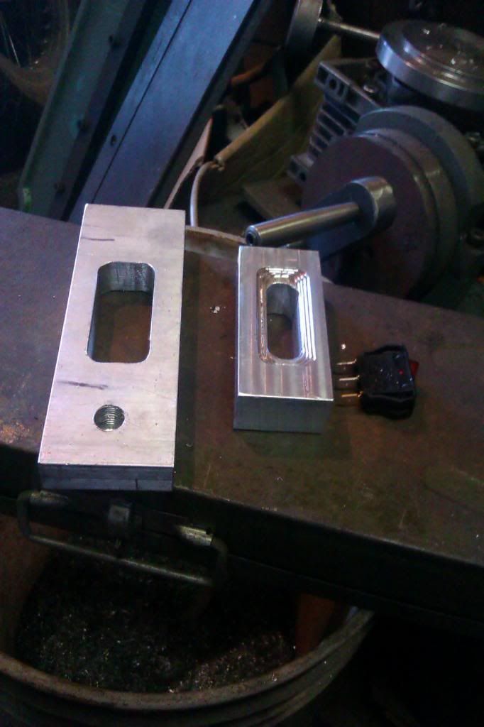

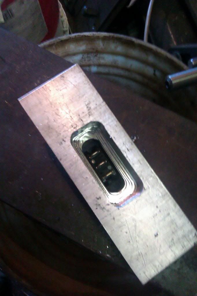

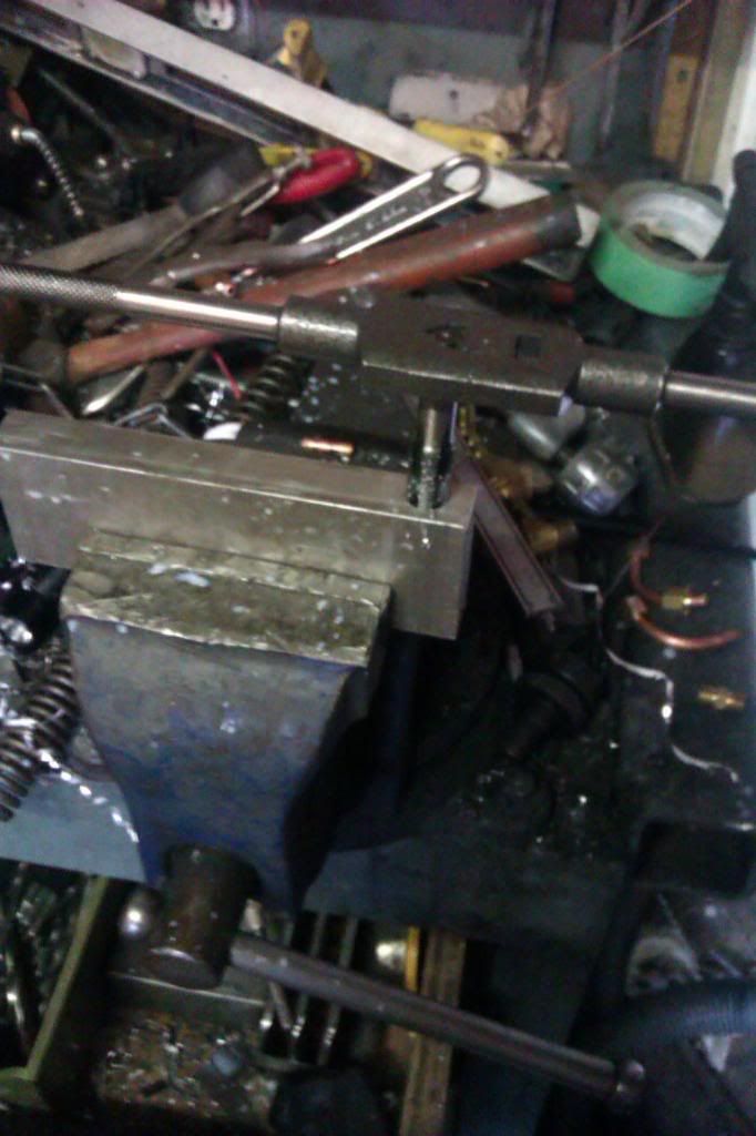

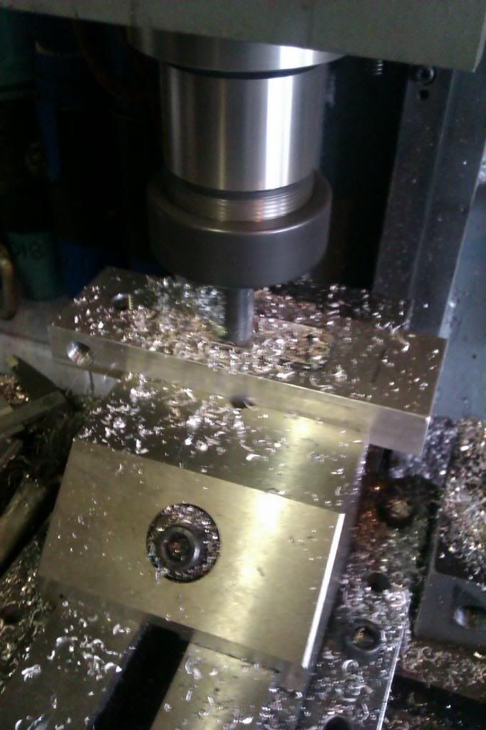

                            • Decided to start working on the coolant system for the mill since yesterday I went out and picked up a parts washer pump and nozzle to use. Needed to make a mount for the nozzle as well at connections for the supply and return lines. Since I had a couple of scrap bits of aluminum I figured why not use them.
                              Used a chunk of 3/4" aluminum and made it the size needed, I then drilled passages in the block for coolant flow and fittings for a control valve (to regulate the flow rate to the work). Tapped the holes for compression type 1/4" copper fittings (I have tons for work) and the coolant hose. Temp fit went well.
                              • Coolant enters on the right end and goes through the valve to the hose. A second tap is taken from the hose and returned to the coolant tray via a second valve. This allows me to change the flow rate and not strain the pump, as excess will just be returned to the reservoir (same way I did my lathe one).
                                Then channeled out the center for a recess to put the on/off switch (decided to use a rocker type). Since the plate isnt deep enough for the switch and wiring, I made a second smaller block (1" alluminum) to mount over the base plate and give me a reces deep enough to hold the switch.
                                The channel in the top block is sized to fit the switch (bottom is stepped open to stop wire rubbing) while the bottom block has more room to hold the wiring. I will mount the switch on a sheet of stainless and screw it to the top block.
