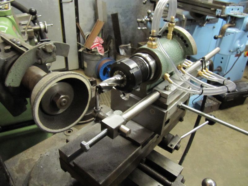

          I made this last winter for sharpening milling cutters, i posted a thread on here but thought it might serve better if i put it in the shop made tools, hopefully someone else will find it useful.
          it has a three position stop arrangement to give a horizontal set-up position, then a primary and secondary clearance, this is achieved by adjusting the bolts, (a bit like a wood working router) and has an indent ball/spring to lock in the desired position.
          there is a piece of drill rod inserted through the side of the pivoting plate, with a pocket cut to expose it so that it contacts the 3-position stop in a single plane, this is in a pocket on the underside to keep grinding dust out. as already mentioned it allows clearances to be indexed between without additional set-up, it also allows the head to be tilted away from the wheel between cuts, so there is no danger of slipping up whilst re-positioning the cutter on the next flute.
          horizontal setting
          secondary clearance angle.
          Yes the wheel needed dressing in the above pic
          i did a bit more work after that but haven't updated any pics etc, if you do a search for 'air spindex' you should be able to find the old threads.
          and here's a link to a video of it floating: http://s182.photobucket.com/user/cov...ring1.mp4.html

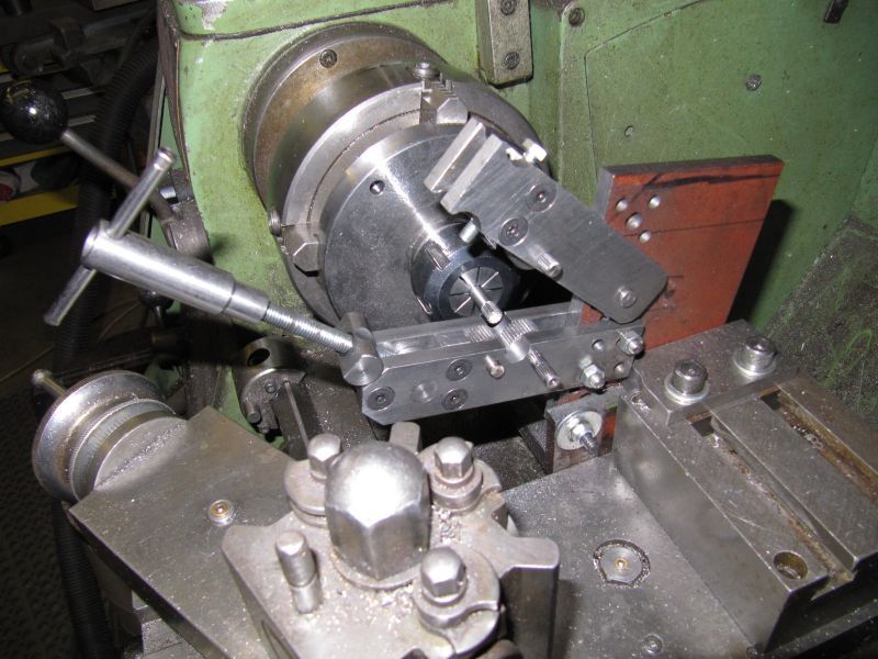

                • rear mounted Kurling tool for small diameter stock, been using it for straight / spline type knurls to create an interference on some hinge pins. beauty is it allows good access for repetitive work, i've done around 300 pins in the last week. it has three wheels to prevent bending the stock and is semi-floating so it self-centres.
                  it offers about 2:1 on the hand-force so no spanners are required, there is also has a depth stop to ensure repeatable depth of knurl. i don't use coolent, but have found using the air-line to give a continuous blast when knurling keeps and chips from trashing the job

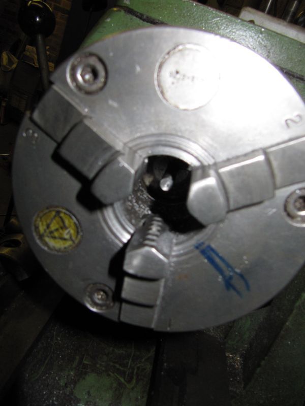

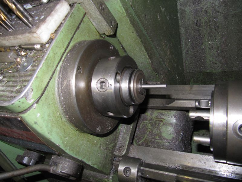

                              • I can't claim to have thought this up on my own, luckily when i bought my lathe it was quite well tooled up, the previous owner had made a spindle nose adaptor to accept 3C collets and a hollow tubular drawbar, i've never used these much - mainly because the drawbar needs repairing for propper workholding. None the less i had a load of pins to face to length and ideally a backstop of some sort to use in conjunction with a bed stop, (which i also have). Luckily to chap who made the 3C adapter made it so it would fit inside the chuck, so it was a small matter of putting in a suitable collet and a bit of bar stock.
                                not really a shop made tool, but saved me no end of time.
