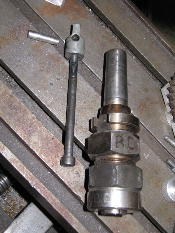

    • Here's a work-around for those who want to do some milling on a machine with a morse taper but no drawbar provision, in my case it is an arboga milling machine that normally uses special split washers and a collar, mine were missing so here is how i held a collet chuck for milling.
      I aquired a collet chuck and cut the end of it with an angle grinder, this exposed the soft core and i was then able to drill right down the shank. i then made a new tang section with a cross hole, a bit of care is need to ensure you can still drift it out, yet get the cross pin etc to line up and make sure the draw bolt (from the bottom up) still has a gap to maintain tension.
      Care is needed to ensure the cross pin is centred and not going to clatter the quill bore, you could reduce the diameter of the center to make sure this cannot shift in use, i never had any trouble though.

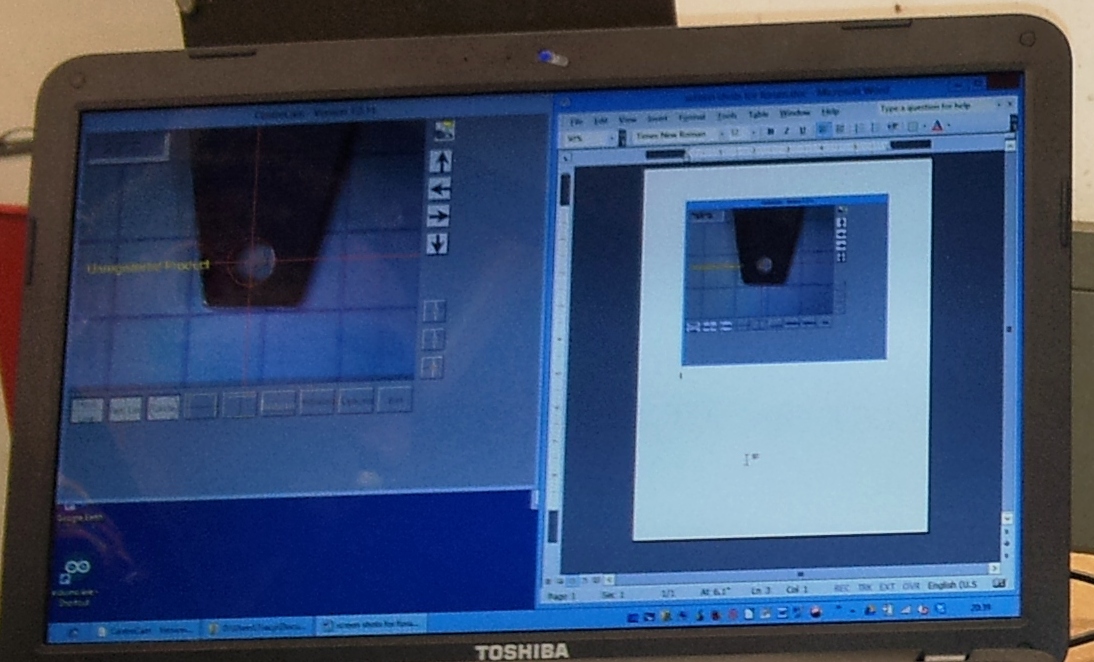

      • Voice-Activated Optical Inspection System
        This is a shop made tool the Shop Wench and I bodged up together when I had a part to reverse engineer. I made a holder to fit a usb microscope to the mill spindle. The microscope plugs into a laptop so you can see the image on the computer screen.
        Also, I found a program referenced in this post (and many more): http://bbs.homeshopmachinist.net/thr...te-on-a-webcam
        For anyone that wants to duplicate this project, this is the model we used: Celestron 44302 Deluxe Handheld Digital Microscope 2MP.
        To make the fixture, I cut a taper in some alum. bar stock to match the taper on the microscope and made an access hole for the button on top. The focus dial is below the alum. part. Here is a pic of the camera in the fixture.
        This is what the overall setup looks like.
        First I zeroed x and y on a hole, then took all my other measurements from there. The photo was taken at a bad angle, so the circle really is concentric with the hole, even though you can't tell.
        This being voice-activated, I'm sure you're all wondering how I got that to work. Well, here's how it goes: Shop Wench says "Number", and I tell her the reading. She says "Next," and I move to the next measurement point.

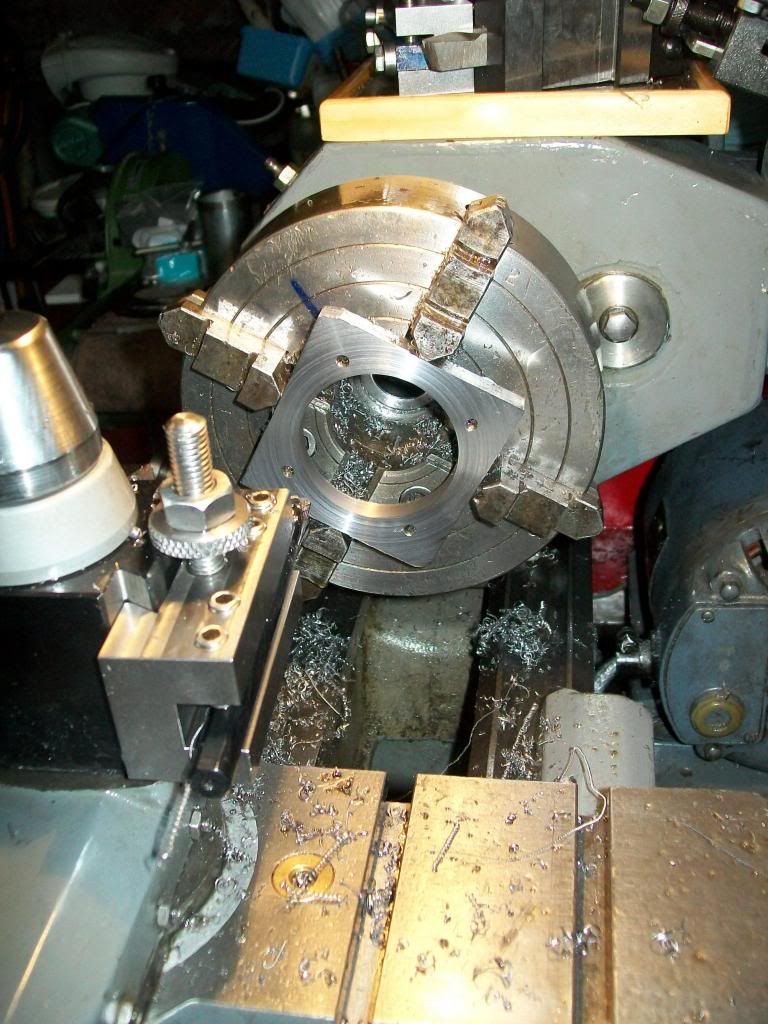

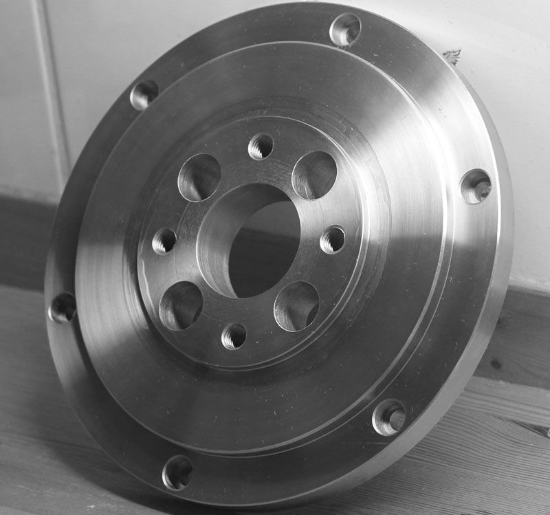

          • Chuck backplate
            Backplate for putting a 8" Bison chuck on a rotating table.
            Made out of Heat treated 4140 - The only material I had in a suitable size.

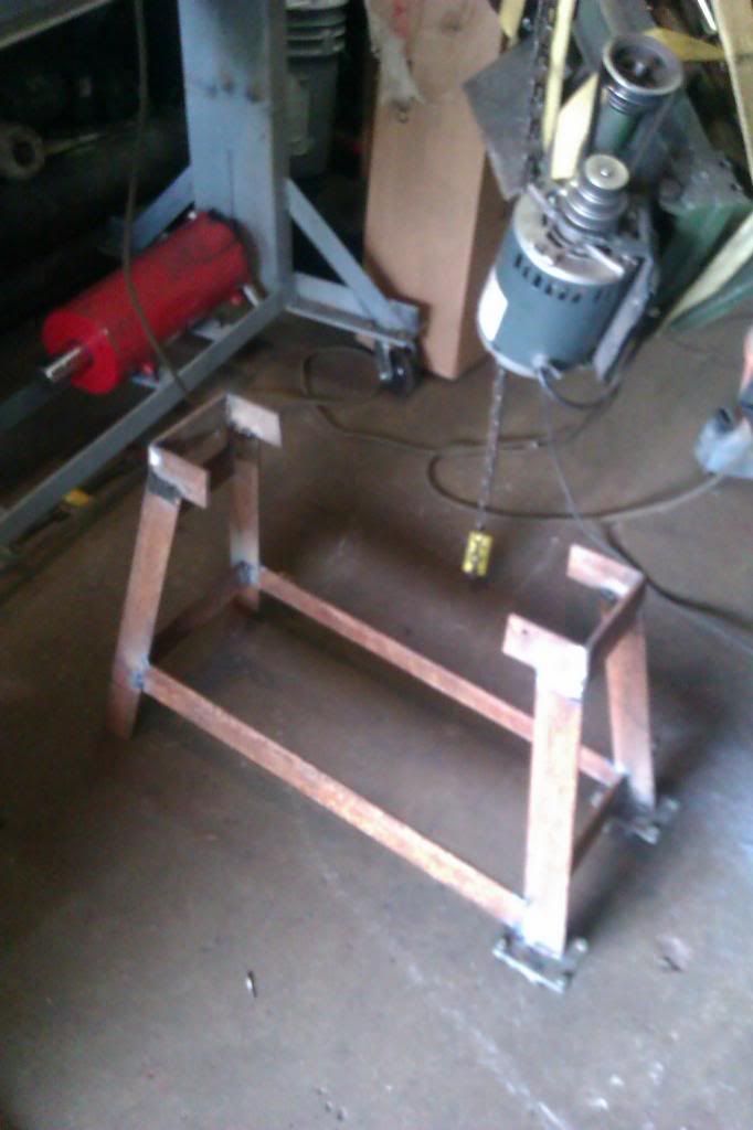

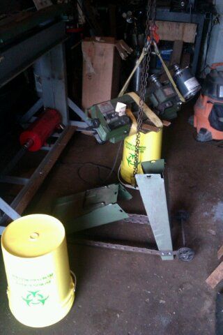

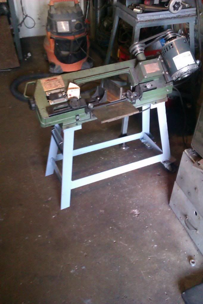

            • Got real tired of the crappy rickety base on the HF band saw, so decided to scrap it and put a real base on it. Glad I made a hoist for the press as it made it an easier job than having to manhandle the thing during fitting lol
              Decided to use some 3/8" flat bar I had (overkill, but it was cheap and I had it) and keep the same leg angles. Used the original mounting holes and decided to add casters to the back legs since I pull it out to use it. After a lot of cutting (angles on the flat bar) I pulled the old crap base off and fitted/welded the two top sections for mounting (threaded them for 1/4-20 cap head bolts). After welding the legs on and putting in the bottom braces (which will carry a tray for catching the filings for easy cleanup) I welded a small strip for the "pull out handle" at the front.
              It was easy putting it on the stand with the hoist, and even after a lot of welding the holes still lined up lol. At least now when I pull it out to use it the thing doesnt twist and shake all over the place. Once I get the press done I can bend up a tray for it (along with the coolant tray for the mill). Gave it a coat of my standard tremclad grey and it was done

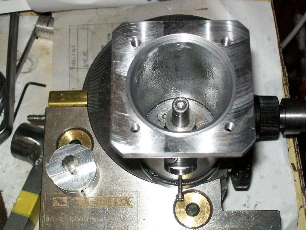

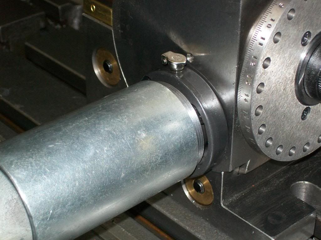

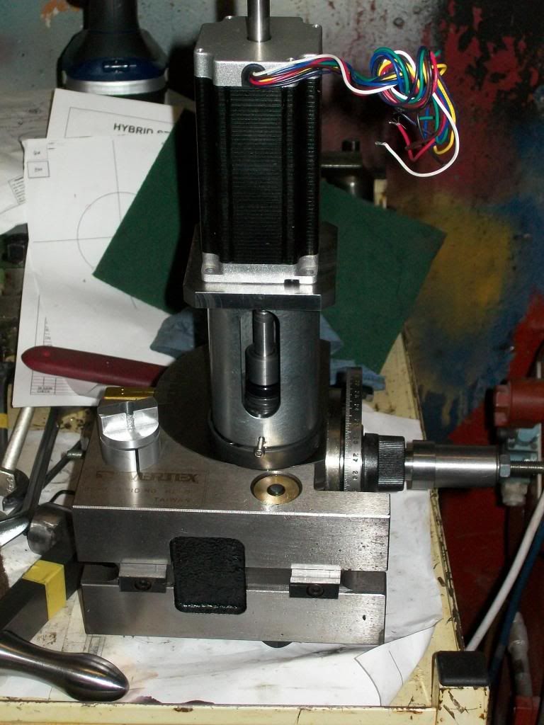

              • Started the conversion of my BS0 Dividing head to stepper operation:
                Shows the adaptor shaft which goes from the dividing head worm which has a 1/2" shaft with two flats to 10mm for the stepper coupling (not decided which type yet) and the stepper threaded mounting and tube.
                What it looks like fitted up temporary for measurement purposes.
                Showing threaded section

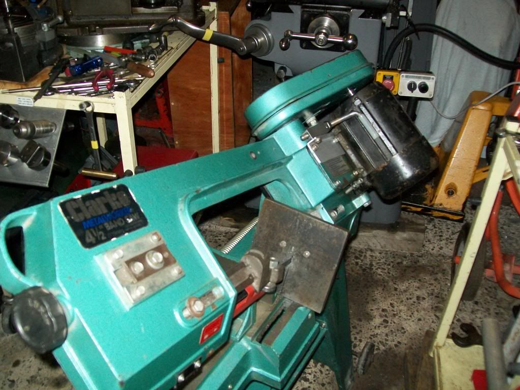

                  • Bandsaw belt tensioner, any one who has one of these probably already knows how crappy the drive belt tensioner is here is my simple but effective modification.
                    Also fitted an automotive drive belt in place of the Yak hair coated chewing gum item that was fitted.
                      Regards
                      Paul
                      I believe the chewing gum belt WITH yak hair was the heavy duty model.
                      • Originally posted by flutedchamber View Post
                        Nah, that was the super heavy duty model, without was heavy duty and the spit coated string was regular duty, I was told they also had a light duty model, but it seems no one can find any of them due to super duty magnifying glasses not being company issue.

                        • Bit more done on my dividing head conversion:
                          Paul

                            • Must be figgerin' on doing some mighty powerful dividin' there Paul... judging by the size of that there stepper motor!
                              Looking good! Is that a piece of galvanized pipe you attached the flange to? Looks like it's attached with threads? Good utilization of stuff on hand.
