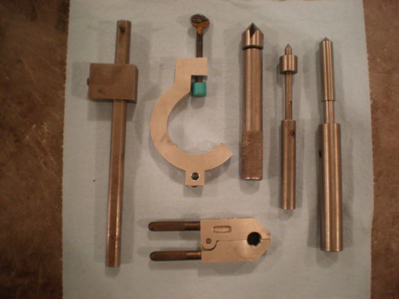

          These are some tools I made. The tool on the left is an adjustable scribe, the next is to hold an indicator on the quill nose, next is a handle for a deburring tool, the next two are for indicating work in a 4 jaw chuck, and everyone knows what the one at the bottom is.
          Top left is a spider for the left end of the lathe spindle, top right home made bull nose, bottom is a micrometer carriage stop.

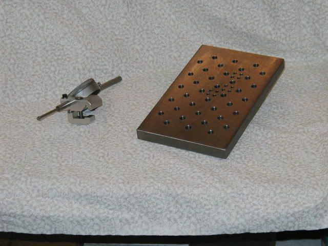

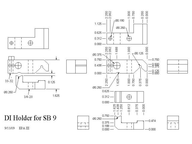

                • Here are two other accessories I made for my SB lathe: a DI holder and a milling table.
                  The DI holder that came with my SB was a really lousy design. The clamp piece had flats on both ends so it only worked correctly if it was perfectly matched to the ways. But it wasn't and no ammount of shimming seemed to help. It also had the DI mounting hole on the bottom, clamp piece instead of on the top piece that was aligned to the way. This allowed it to move about/rotate and easily loose it's zero. I made this one from Fortal. The DI mounts in the top piece and the clamp is desiged to have no influence on the position of the top or the DI. The clamp rotates about a 1/4" piece of drill rod that rests in round slots in both parts. It is fixed in the clamp's slot with super glue. The contact surface of the clamp is NOT flat, but instead has about a 2" radius (hand filed) that allows it to contact the bottom of the way along a single line so it can not misalign the top and the DI. The drawing is reduced and hard to read small details, but this radius would be visible on the side view at the surface that is 0.474" above the bottom of the clamp. I cut it from a single piece of Fortal and drilled and reamed the 1/4" hole to form the round slots on the saw line before separating the two parts. The relative positioning of these two parts before sawing them apart is shown in the left hand, side view. This technique ensuered perfect alignment of the two half round slots and was a lot easier than milling them. Here's my drawing:
                  Oh, the milling work on the DI holder was all done on the SB using the milling table which is also shown in the picture below.

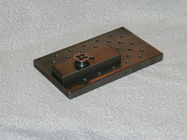

                  The milling table is just a piece of 3/4" 1018 steel. It had a fairly flat mill finish and I did very little to improve it. I did do about 100 or 200 strokes on abrasive paper on a glass plate to take off any bumps or burrs. There are a lot of 3/8" tapped holes for using a clamp set. This is a lot more verastile than the usual milling vise for a lathe.
                  Here you can see the bottom with the mounting button for the cross slide. It also has an optional 3/4" raising block on it which allows movement over the cross slide's crank for greater Y movements. Without the raising block I can mount bigger (taller) parts.
                  Here's a bottom picture of the milling table:
                  The button is mounted with 4 M5 SHCSs: I used that size because I have a large box of them on hand and I have to use them somewhere. Number 10 or 12 English size cap screws would also work just fine. In the top side photo, you can see that there are three positions where the button can be mounted for more versatility.

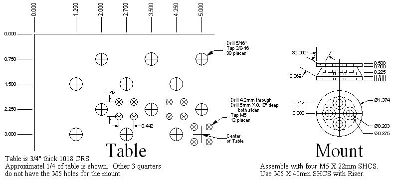

                  This combined drawing shows a bit over 1/4 of the table and the mounting button. The other three quarters are symetrical about the center, which is marked:

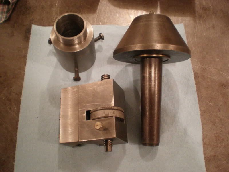

                        • Wow! It's nice to be involved with a group that does such fine and varied works.
                          Throwing in another project that followed a need from another project- this one is a horizontal spindle adapter for the mill. I needed something with which to cut fret slots in a guitar neck. After spending countless hours learning about scales, string bending, fret spacing, etc, I used a program to give me fret spacings for chosen string lengths, et al. When it came right down to it, I figured to use the mill to make the slots, hand cranking the x axis to precise locations for the milling operation. I don't recall the precise width of the slot required, but there was no way I was going to find an endmill in that size, so a sawblade was going to be the ticket. For that I needed to turn the vertical spindle into a horizontal one, and speed it up.
                          This is the result of that train of thought. The body of this device mounts to the quill, and requires a precise alignment for the spindle to be parallel to the x axis. There's an alignment mark on there somewhere, and one on the quill. The next picture shows a close up of how the thing is driven. The flat end of the spindle has a couple of slots in it, and the pin you see just above the gear goes into those slots when the adapter is mounted. There's the beginnings of an mt3 taper where the pin goes through, so that all nests into the end of the spindle nicely. That part drives the large gear which you can only see the back side of.
                          In this third picture you see the saw blade I made and silver soldered onto a 1/4 inch stub. The spindle is made from a grade 8 bolt, and is set up with a collet like a router to hold the tooling. The small gear on the spindle lets me get the spindle as close to the mill table as possible, so I can keep the diameter of the cutter down and therefore have it be more rigid. More depth of cut is another benefit of that. In the final picture, you can see how close the spindle is to the bottom of the housing. The gears are spiral bevel and came out of an angle grinder. Here I'm using them in reverse, with the large gear driving the smaller one.
                          I put the small gear on the back end of the spindle, which means I have to run the mill in reverse to get the correct rotation, but more importantly it gets the gear teeth in the same contact as when they were used in the angle grinder. There was not a lot of room for error when placing the gears to run the guietest, but I got it pretty good. The saw blade is made from a section of hss bandsaw blade, otherwise I might have made it round. No matter- less teeth to grind on it this way.
                          I built another version of this, but with a larger spindle and 1 to 1 gearing, and more robust. It mounts to the quill in roughly the same way, but the drive gear is not built in like this one. Instead, it's mounted to its own mt3 taper shank, held in with a drawbar. Those gears are about two inches in diameter, so figuring it out, that means that I can get a 1/2 inch (slightly less) depth of cut from a 3 inch diameter blade, and clear the bottom of the adapter, or get nearly an inch depth of cut if all I have to clear is the hex of the collet closer nut. I used a 3/4 inch grade 8 bolt for that spindle, and a 1/2 inch bolt for this one.

                            • darryl: Wow thats awsome, great idea for the source of the gears too. How did you make the gears teething adjustable?
                              • Basically, I set them up temporarily and rotated them by hand to get the dimensional relationship according to sound and feel. When I felt it was right, I took the measurements. I machined everything to those specs, leaving a way to slide the small gear on the spindle. The large gear slides onto a fixed post, so I was able to shim it with thin washers until it was right. The combination of sliding the small gear and raising or lowering the large gear got the relationship correct. The small gear is epoxied and backed up with a collar on the spindle shaft. I machined a spacer to the same thickness as the shim stack, and that brass spacer carries the big gear. The real problem was getting the recess in the housing to the correct depth for the morse taper to seat lightly but not bind when the housing was attached to the quill. I lightly pressed the gear with the taper body into the mill spindle, took a reading from the back of the gear to the flat on the spindle end, took another reading from the spindle end to the quill bottom, took another reading from the gear in the housing to the top edge of the housing, did the math, presto (not really ) got the dimension for the depth of the recess to cut in the housing. It did take a while to do.
                                Like so many shop projects, the setup time, and for squareness and accurate alignment takes way longer than doing the actual machining. In many cases, where I get stumped is when I have to machine a fit, but I can't test the fit without removing the piece from the lathe. No way I was going to remove the quill to see when it fit the housing being turned on the lathe- I find it a little frustrating when I have to make a test copy of a diameter so I can use that to test a fit, but sometimes you have to waste a piece of material to do that. Not really wasted I suppose- pieces can always be used to make something else from- but it's always after I have a setup to turn mounted in the chuck when I realize that I have to remove that and make a test plug
                                Through the making of all these things, I've learned a lot, not the least of which is to allow the parts to come to room temperature before the final measuring and skimming to size. I've been caught on that more than a few times.
