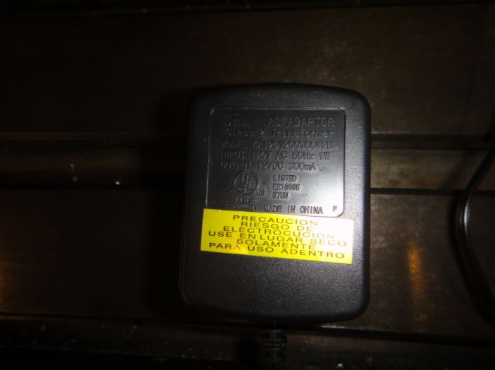

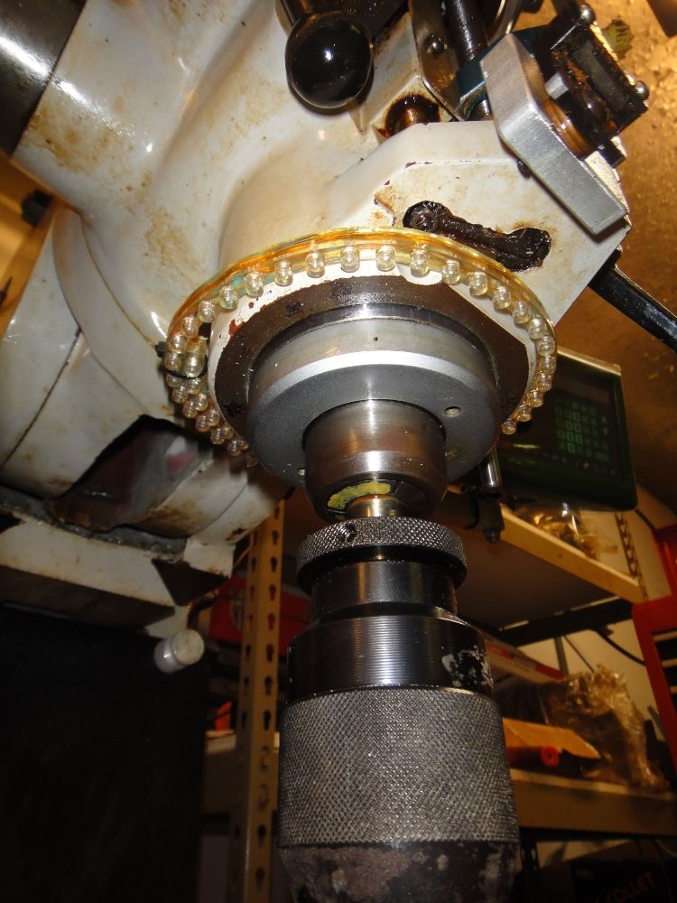

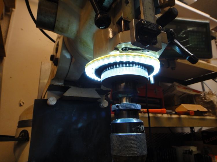

        • While technically not a tool, I needed a light for my mill. I was going to make a nice mount out of aluminum to fit around the quill column and add some LEDs. I happened to have a flexible LED strip left over from a boat project, so a couple of tyraps, a dab of RTV and a repurposed 12V (300ma) charger (from some long dead electronic device) and ten minutes later I had a workable solution. The flexible LED strip came from Ebay for $3 including shipping.
          Doug
          • That light is something that I have been wanting for sometime now. My old worn out eyes need all the help they can get. Macular degeneration does not help either. I have been studying on how to work with and build LED light all week long and this might be the push I needed to get me started. Thanks
            Oregon Coast
            • I have done a similar thing on my mill. lots of variables of leds at dealextreme.com.
              I need to revise mine a bit, I used a big hose clamp to hold them to the quill and they kind of squirted out from beneath it. . .
