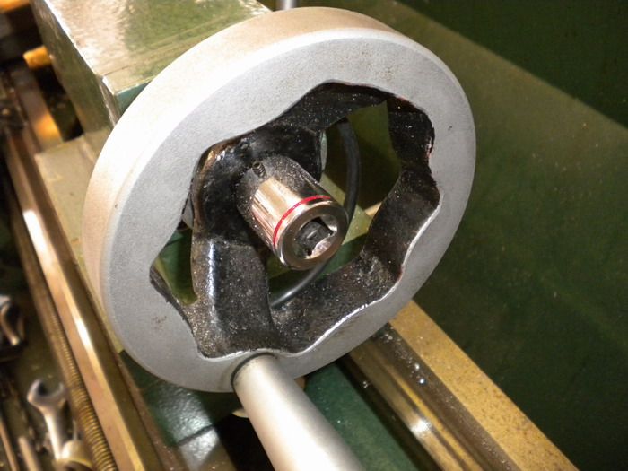

          • These are just some of my new ideas/gadgets that I decided to post. First is a quick means to drive the lathe tailstock.
            Tailstock Drive Socket
            Tailstock Drive Socket in Use
            The socket is drilled and tapped for a set screw that keeps it in place. Simple idea, but helpful.

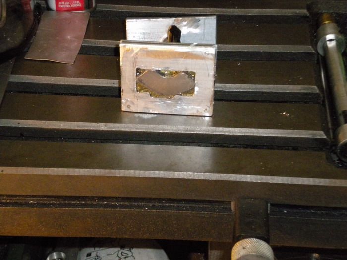

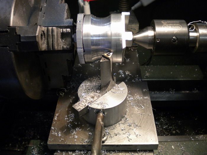

            • Concave Cutter
              This is a quick modification of Steve Bedair's excellent design for a ball cutter that enables me to make concave cuts as well. Using the original designed cutter mount, there was just enough material to cut a seat on the opposite side to mount the cutter for concave cuts.
              Concave Cutter
              It works very well.
              Fred Townroe

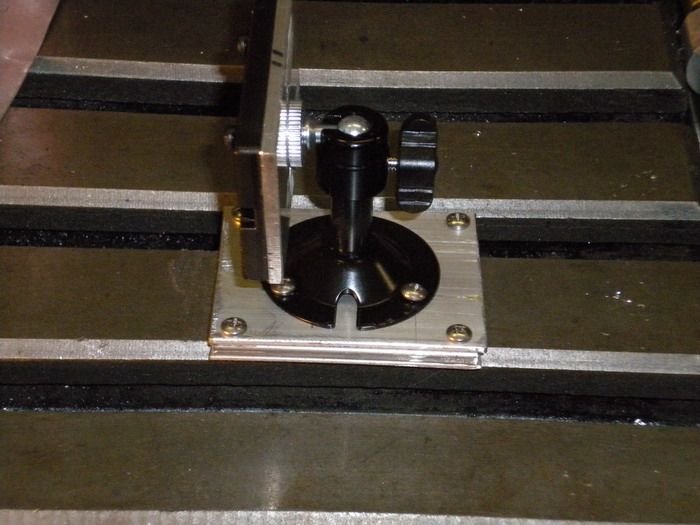

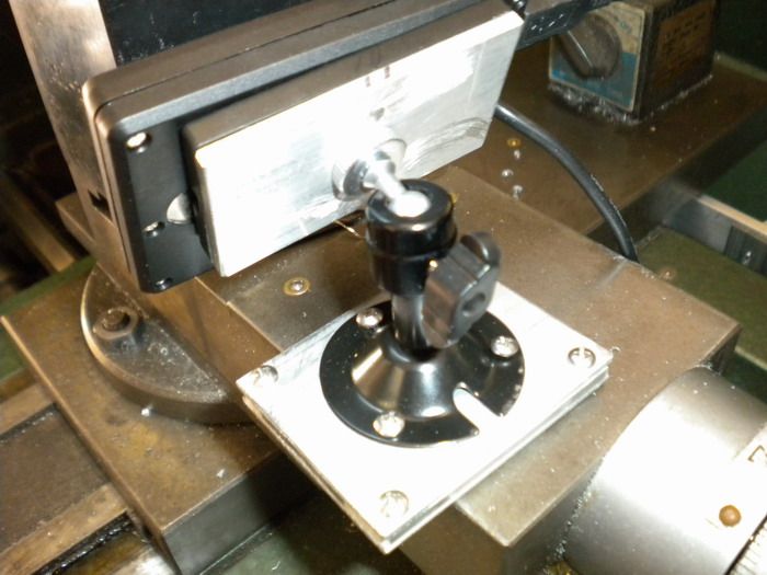

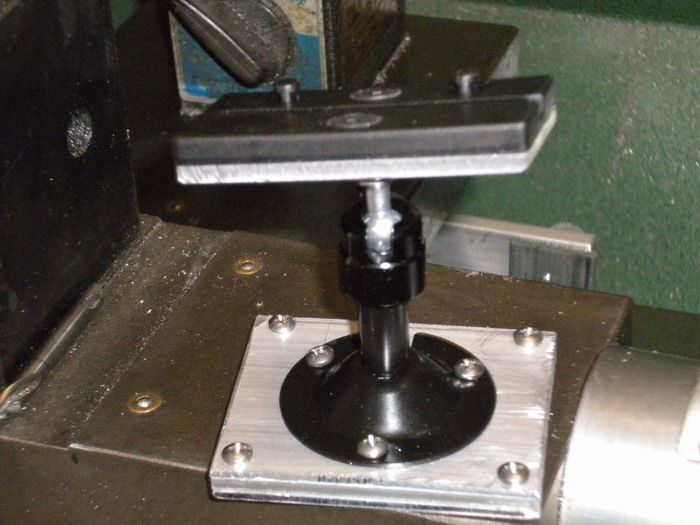

              • This is a small mount that I made to hold the I-gaging DRO readout. It is movable though many planes and allows you to view the display thought many angles. Store bought parts include a CCTV camera mount (widely available on E-bay) and an old computer hard drive magnet.
                DRO Readout mount side view
                DRO Readout mount bottom view
                DRO mount front view
                DRO mount back view
                Fred Townroe

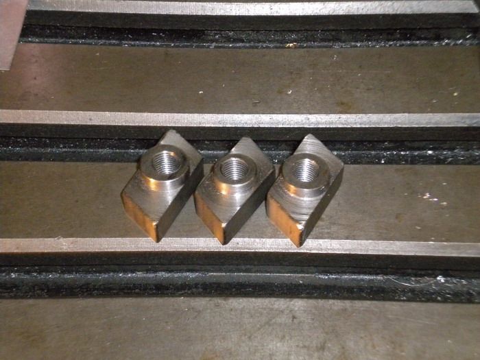

                • EZ T nuts
                  I call these EZ T nuts because they simplify the installation of the T nuts on the milling table. I always seem to collect junk in the pockets at the end of the table that has to be moved to slide the conventional T-nut into the slot. These are patterned after a set of hold downs that I bought that had a similar design but did not work because they would not rotate to lock after dropping into the slot. Also, I reversed the angle that the commercial ones had cut on the sides because I felt that they should engage when turned clockwise, not counter clockwise like the commercial product.
                  Machining T nut..I was somewhat sceptical that I could get a good enough grip on these to machine them, but the setup worked very well and was repeatable.
                  EZ T nuts Finished
                  Fred Townroe
                  • Nice work, Fred! I like it!
                    Chuck
                    • Interesting posting again,, thanks ,
