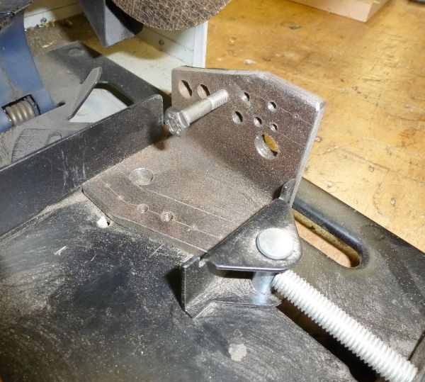

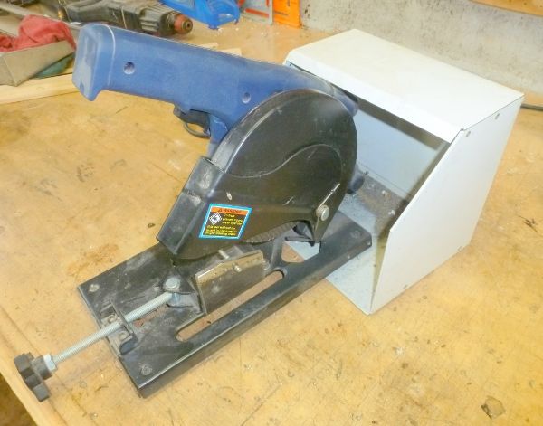

                            • Bolt shortening saw
                              This is a cheap Harbor Freight 6" cut-off saw I have set up as a dedicated bolt cutter. I cut a piece of 2 1/2" x 2 1/2" x 1/4" angle and drilled and tapped it for some common bolts, SAE on one side and metric on the other and mounted it in the saws vise. I also made a box to catch the sparks. It’s simple to use, just thread the bolt in, measure the amount to cut off and whack away. I use it so much it stays on my workbench full time and after a years use it's still on the original blade.
                              • Stu--good idea.
