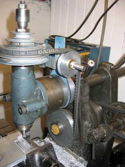

Hardly qualifies as a "tool", but it is useful anyhow....

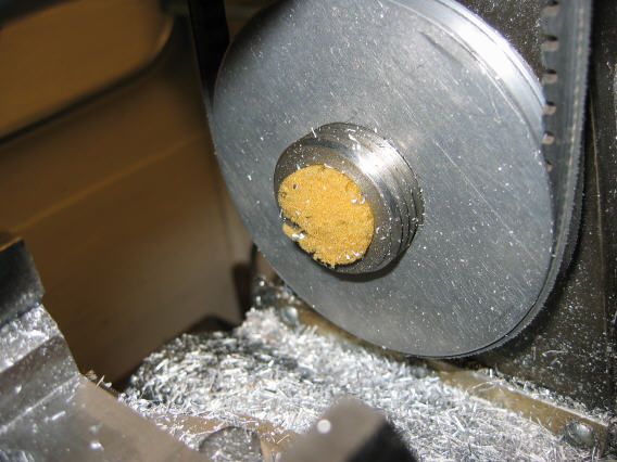

When you have any spindle tooling that does not go into the spindle taper, the taper tends to collect a bunch of swarf, and requires to be cleaned out before use for a center, or whatever. And, now that I put the vertical head back on the Lewis mill, I was getting swarf into that spindle also. Time to act.

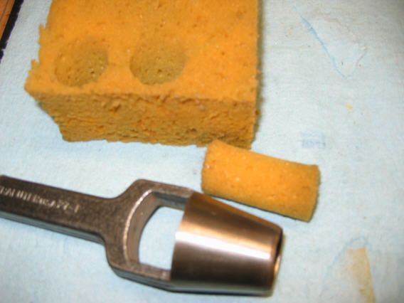

I thought of several things, a cork, a screw-on cap (probably the best idea, actually) etc., but finally just did this... a piece cut from a sponge, and pushed into the taper.
a 1" diameter works for an MT-3 taper, so I use a 1 inch "arch punch" to cut it, but a sharpened bit of tube will cut a nice round, or even just a square of sponge material cut out and pushed in will work.
The reason for it.... you can see the cutter is well placed to toss chips right into the horizontal spindle.
It works quite well to keep chips out of the lathe spindle as well, when boring something held in the chuck, for instance.
