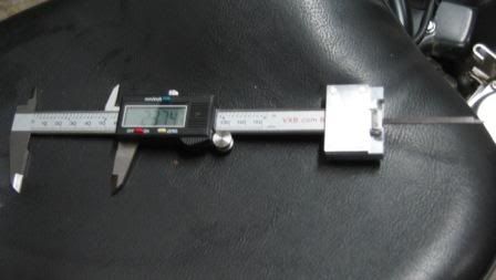

    • No photos here but I think you can visualize:
      Sharpen the tips on your dial caliper. Works great as a scriber, marking off from an edge. Mine is a cheap import that I've had for 20 years. I didn't realize how dependent I am on this particular caliper until I misplaced it recently.

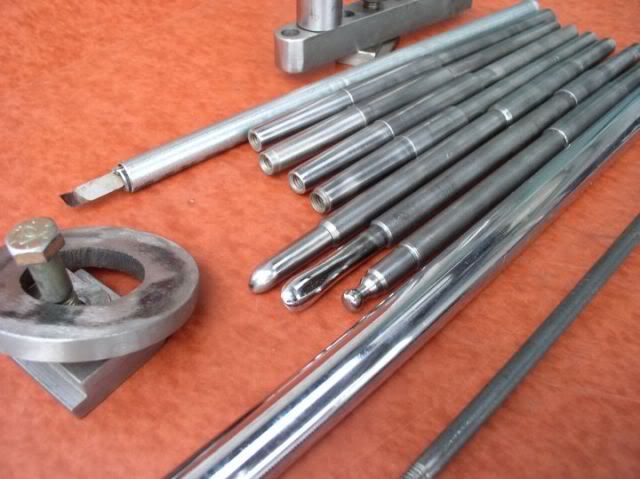

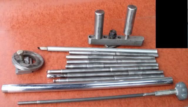

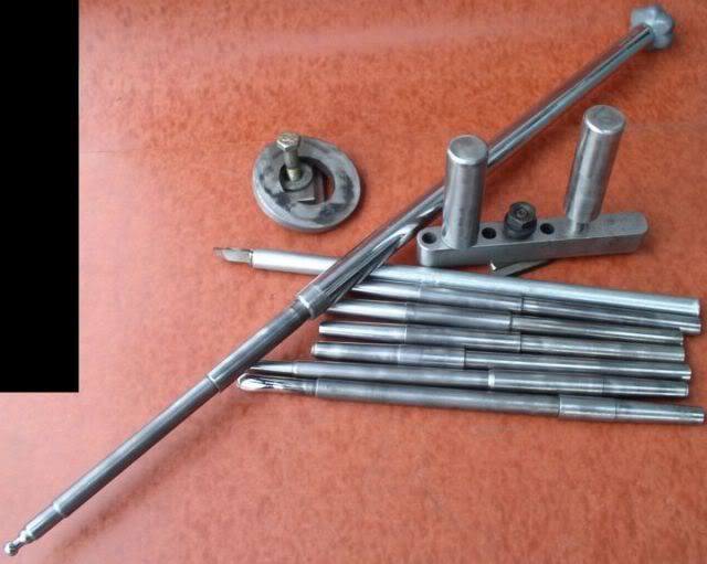

            • Some tools made for metal spinning. Didn't have room to store the long handled tools so made it in two parts. Handle has # 2 Morse taper socket and draw bar and tool ends have male part of the Morse taper. I don't know how to spin metal, but I try sometimes.

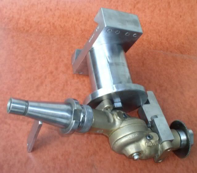

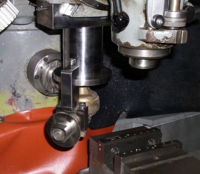

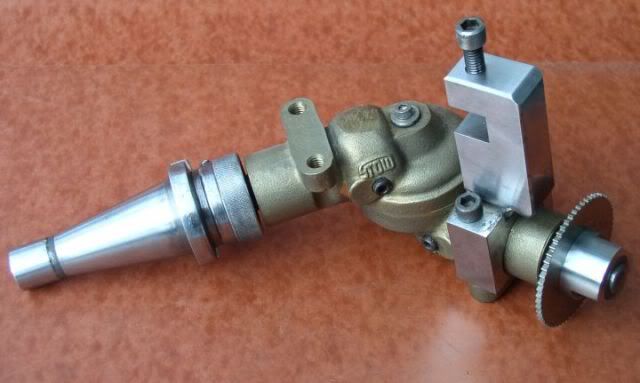

                • Wanted to make a Quorn T&C grinder once. This "requires" a column with a square groove of 1 turn per inch. Thought could do it in the mill. Do have horizontal spindle built in column of my vertical mill but don't have a universal table. So if can't turn table for the helix angle so why not turn the spindle. Had this neat universal joint think made for hard to get at valves on ships or something. So adapt horizontal to cutter using the universal joint.
                  Then had to make an support to ram dovetail.
                  Set up in the mill. Had the table hooked to the dividing head for cutting the helix. Darn, wish I would of take geometery in high school. It didn't cut a square groove but more like an acme thread with tapered sides.

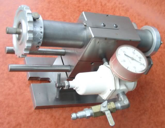

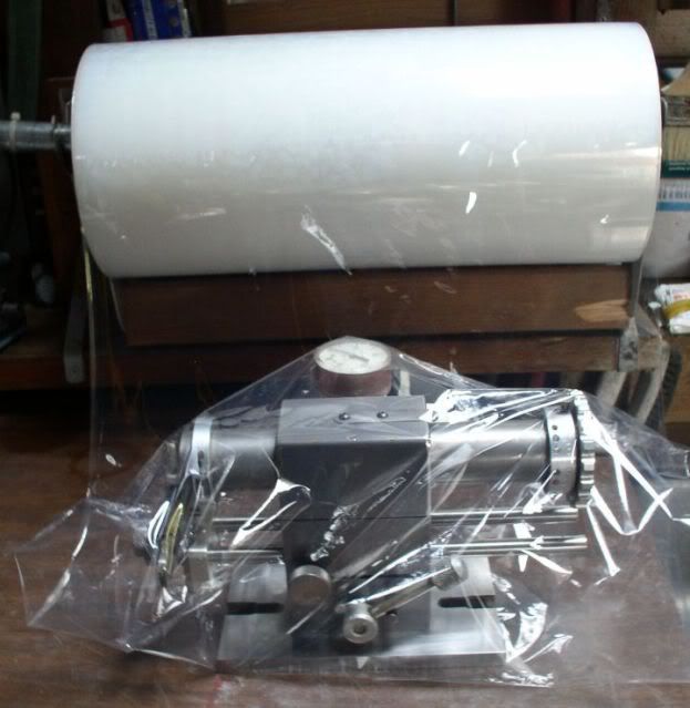

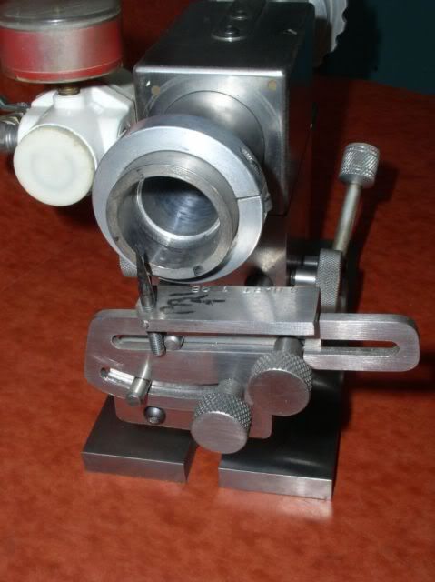

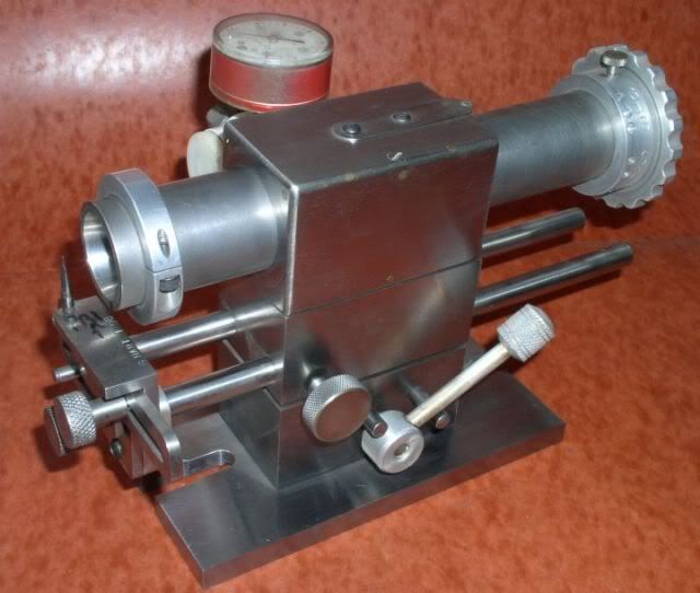

                  • Philip Duclos air spindle for sharpening end mills. Learned lot of my machining building his projects. Uses 5-C collets. Made a copy of Darex's tool rest which is nice as it has built in compensation for different diameter end mills.
                    Another neat tool for me is a roll of shrink wrap. Air spindle is stored in warm part of shop but still needs protection from dust. Should of built storage box.
                    For storing in the cold damp part of shop spray a little oil or something like that and then wrap up in the shrink wrap.
                    • Gary, nice work....what sort of clearance is there and where are the plans from; back issues or a projects book etc?
                      • Originally posted by Mcgyver
                        Mcgyver,the article by Philip Duclos was ""Floating" End Mill Sharpener" in HSM for Sept/Oct and Nov/Dec 1987 issues.
                        Difference between spindle and bore diameters is .002" but the not so easy part is no more taper then 2 tenths in spindle and bore. Had much frustration turning the spindle and bore without taper. Suggest starting with a ground and polished shaft to start with and finish bore by lapping.
