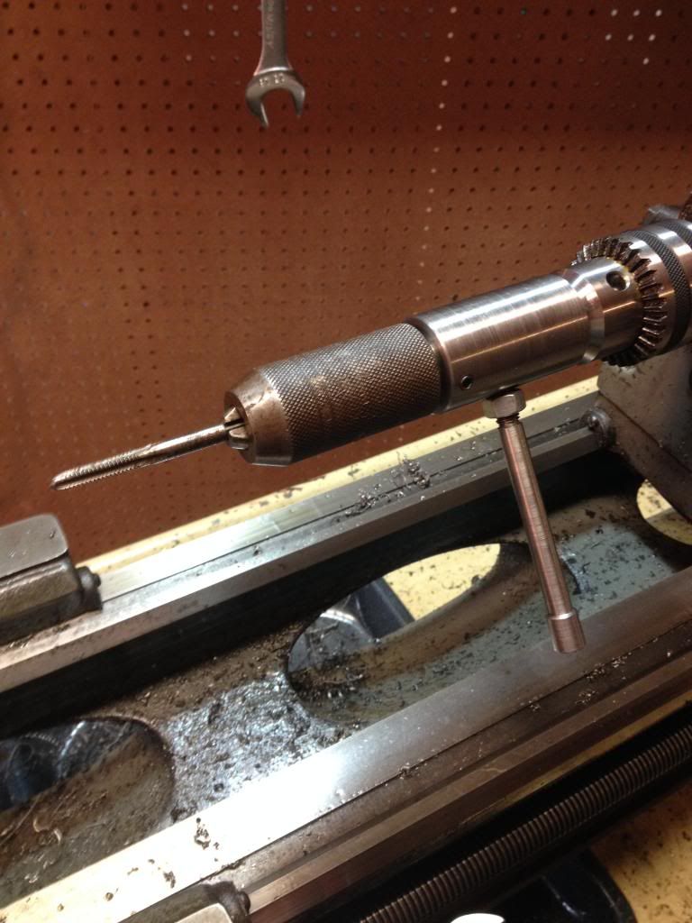

          • Originally posted by gdavis2265 View Post
            I modded the Glacern a bit by drilling and tapping the 1/2" bolt to accept a #10-32 - I
            Cool idea! Here's my version, made it decades ago...
            • Originally posted by Billy Hill View Post
              yes, very nice Bill - I must have seen that when you posted that photo. I actually think I copied mine from a tips and tricks metalworking book I have.

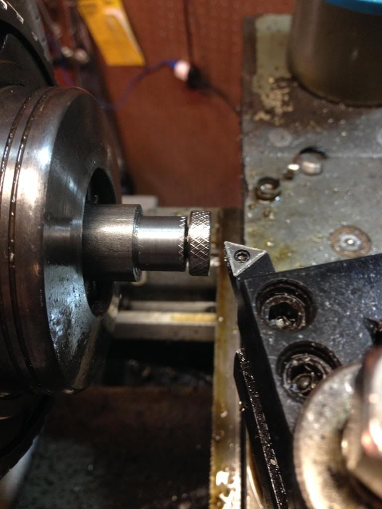

                        • I end up with bits and pieces that are too short to do much with so when I had enough of the same diameter I drilled and tapped each end a different thread and pitch. They are now screw holders to finish screws after parting off. I have one for 1/4, 3/8 etc and tap corse on one end and fine on the other.

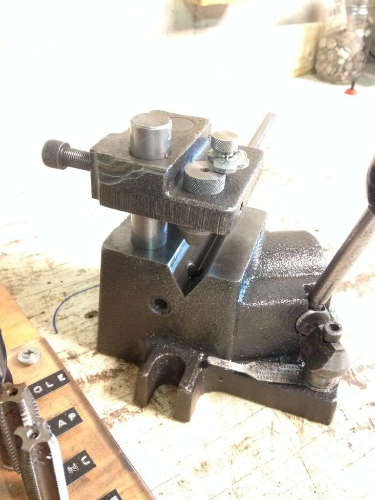

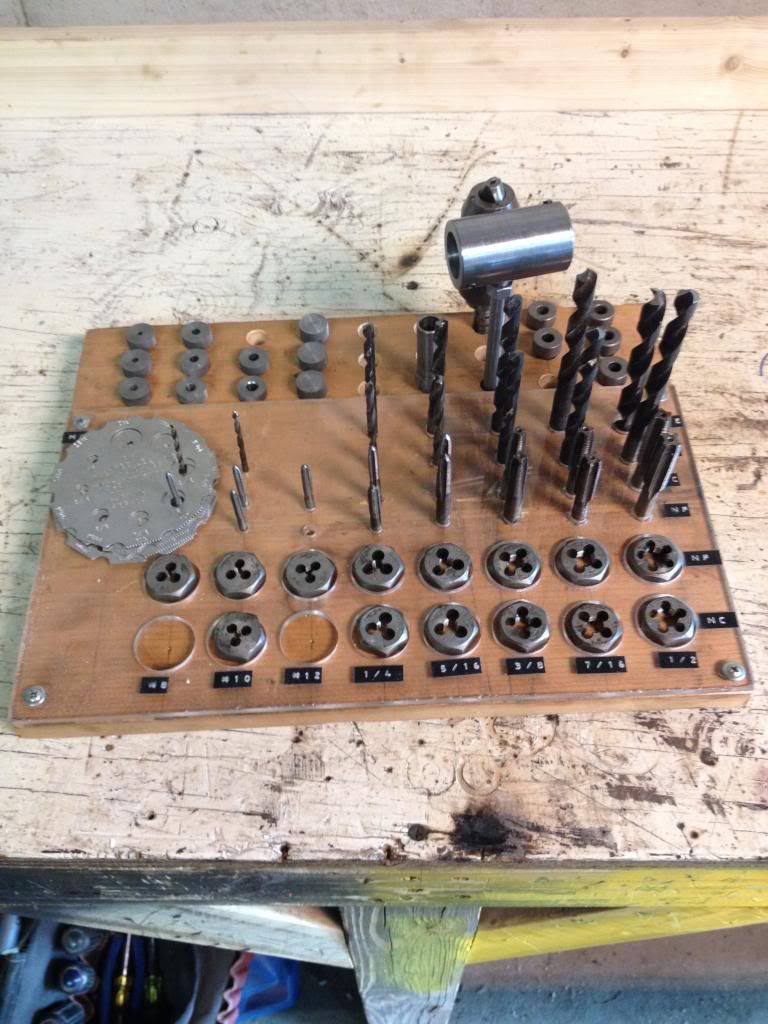

                          • I finally took the time to make something to hold the most used tapping and threading bits and pieces including drill bushings for my favorite EBay score. Heinrich center cross hole drilling jig. $27 + shipping.

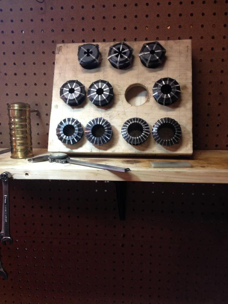

                            • Cheap but very convenient rubber collet holder

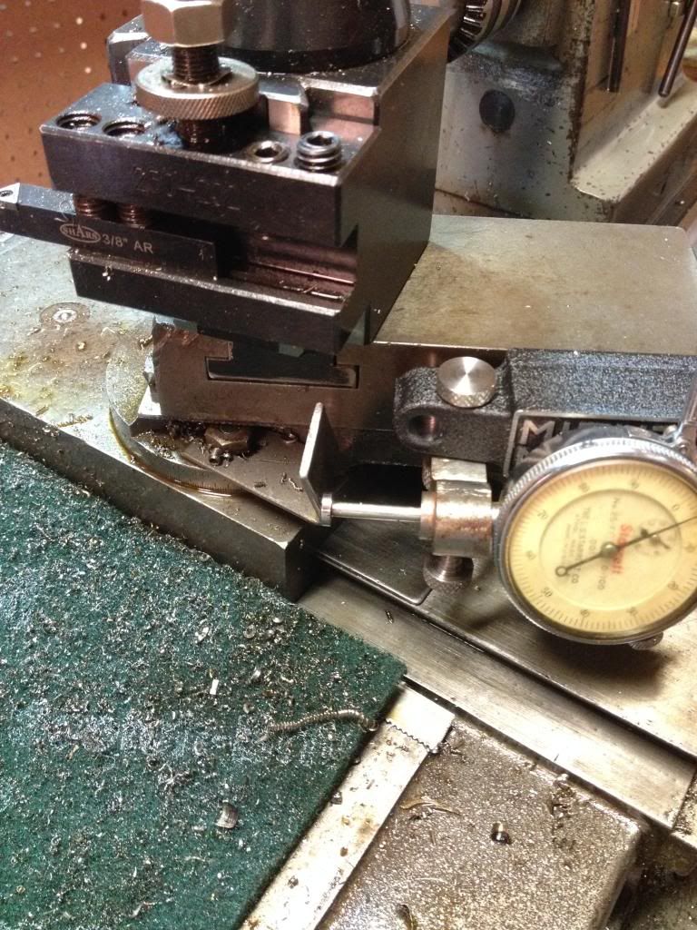

                              • Top slide dial indicator
