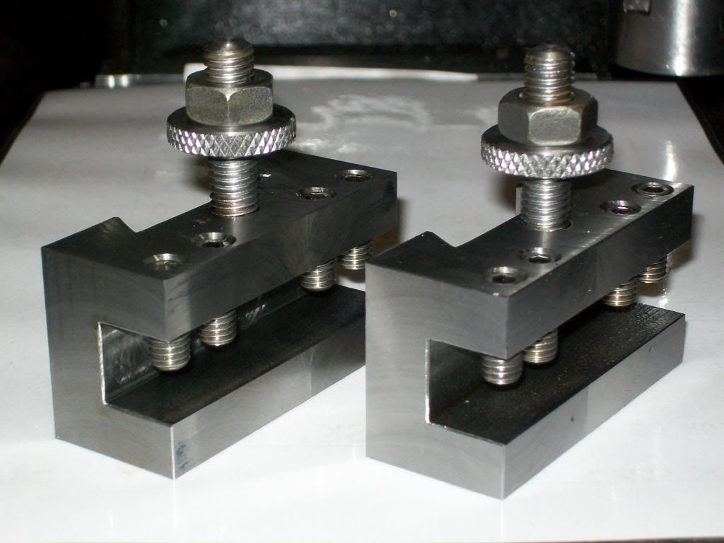

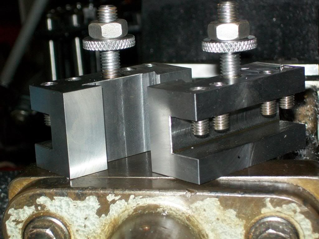

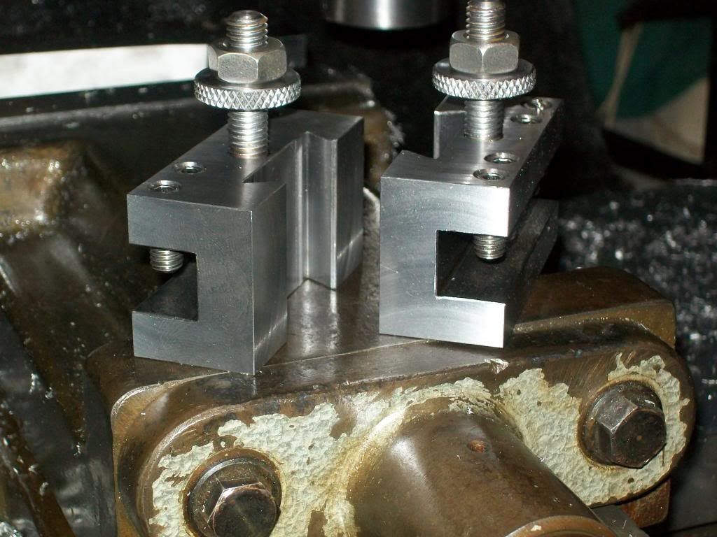

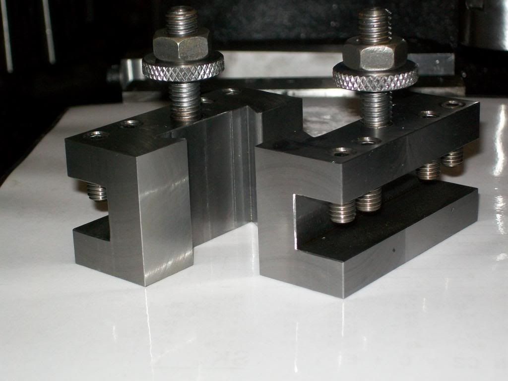

        • You can never have too many of these, so made a couple more
          Paul

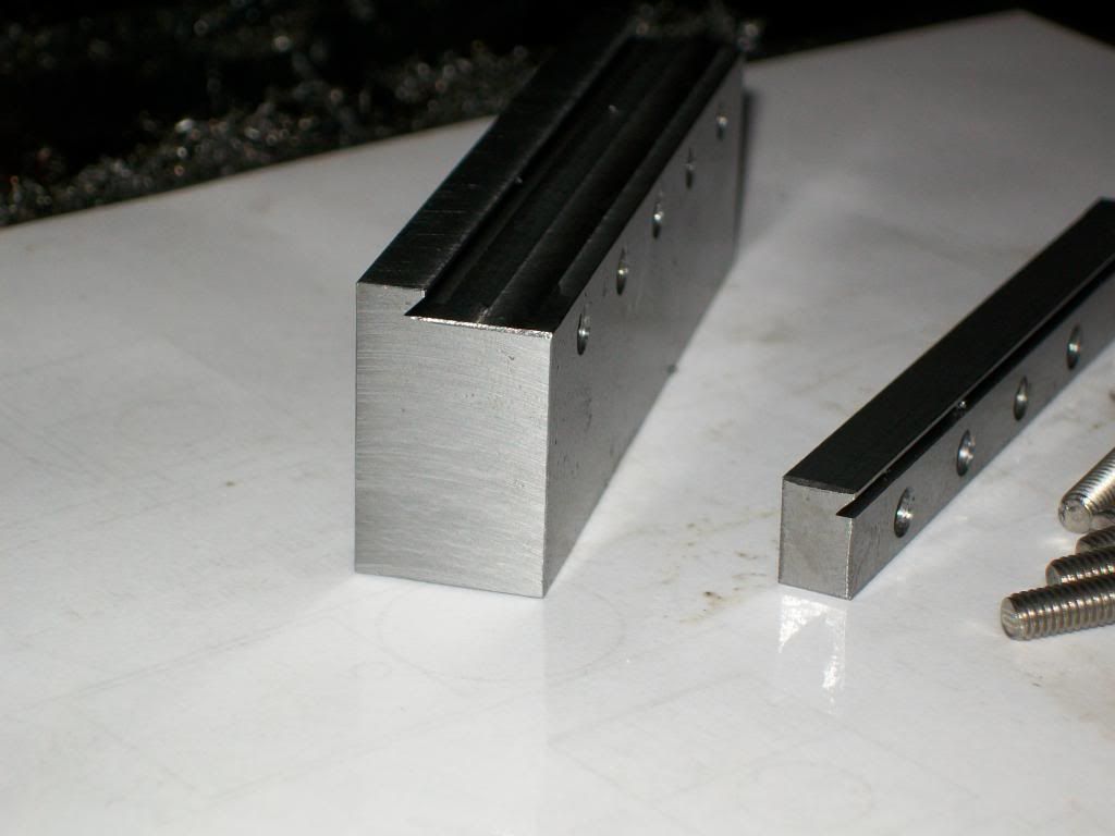

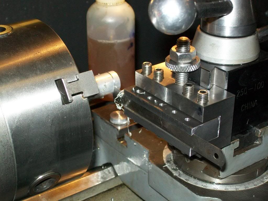

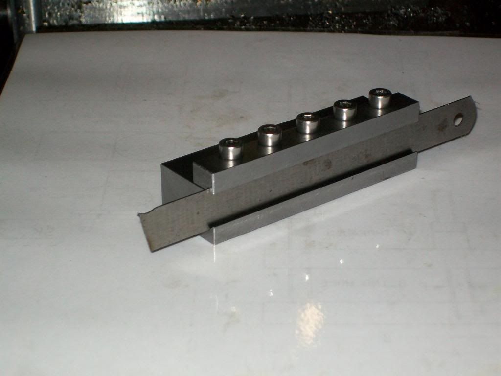

          • Made a new thin parting tool today:
            Paul
            • Very nice holders Paul. What thickness is that parting blade you show here? I need to make a holder also. Cheers, Bill
              • What thickness is that parting blade you show here?
                Looks like it might have been made from a hacksaw blade.
                Location: Long Island, N.Y.
                • Originally posted by RichR View Post
                  Good eye Rich ... I saw the hole and wondered. Bill
                  • Nice parting tool. Maybe good for lots of other uses, like snap-ring grooves, interrupting long knurls, ...
                    How far can it cantilever--how much unsupported blade--from the tool holder is possible, say, in aluminum or steel?
                    12" x 35" Logan 2557V lathe
                    Index "Super 55" mill
                    18" Vectrax vertical bandsaw
                    24" State disc sander
                    • Not a hacksaw blade no teeth or signs of them, it looks & behaves like HSS it came with an old parting tool holder and is about 25 thou by 1/2"
                      • Teeth not ground off? I make parting tools like that from all-hard HSS hacksaw blades, handsaw size, but leave traces of the teeth on the bottom . But they have become hard to find, my stock of broken blades is dwindling. The all-hard blades are handy for making many sorts of small specialized tools, though more for woodworking than metal. A 25 thou wide wood chisel has been useful on occasion.
                        • Looks like a piece of Starrett Feeler Stock
                          • How did you cut the vee? Did you use a dovetail or did you make a purpose made tool for this?
                            • It's shape would ideally suit shaper work and I do intend to make the next one using one of my shapers but this time I used a tiny 1/4" 45* dovetail cutter.
