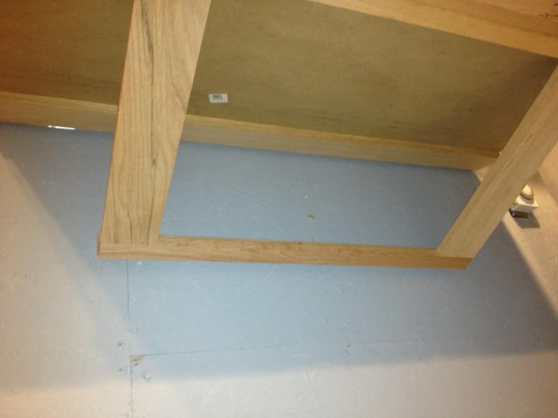

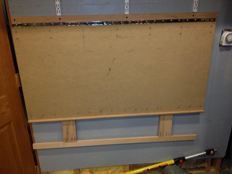

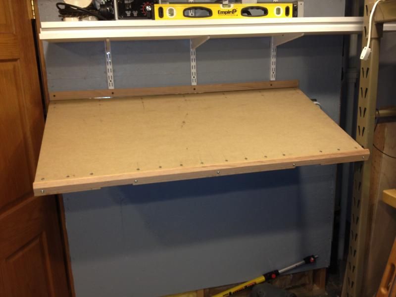

                            • Every shop needs a drawing board IMO. Ran one up last week. Folds down flat, well pretty flat to wall. 24 x 48 work surface
