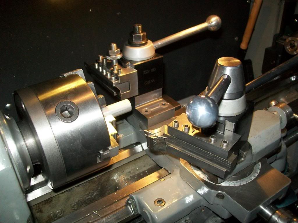

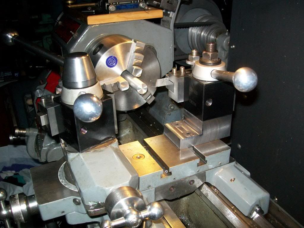

                Had a spare AXA QCTP hanging round for a while was going to punt it on Fleabay but got to thinking about uses for it and perhaps making a base for it to turn it into a rear QCTP this is the mark one version:
                Paul

                • Thanks for the kind words Mike,
                  All is not quite what it seems though... most of the lathe is a 1953 Model "A".....
                  The headstock, tailstock, rear drive, cabinet, gearbox, apron, leadscrew and feet are from the original 1953 Model "A"
                  however...
                  The current bed is from a 1980 TUD model.
                  Cross slide is I think a 1970's single slot item which I machined an extra "T" Slot in.
                  Saddle is from around the 1960's to which I added oil points, got the idea from "Paula's" South Bend 9" rebuild thread on PM. seems to work ok too as it flushes any grunge/swarf etc. out with the oil

                  • Very nice Paul. Lovely rebuild for a 60 year odd old lathe. Paula did some lovely work with Southbend stuff over on PM. Got any pics of the extra oil points? Is that toolpost the 100 or 200 series?

                    • Hi Mike,
                      Yes Paula's lathe is now a lovely piece of work a real credit to her I am quite envious.
                      I cant find any better pics of the oil points at the moment though I am sure I did take some will check the workshop camera tomorrow.
                      You can just see the button oilers in some of the pics, basically I bored four asymmetrical points directly above the apex of the saddles V ways to the depth of the oilers plus an allowance for the saddle chamfer, 1/8" holes drilled all the way through and then on the underside four tapering "oil distribution slots" leading away from each through hole cut freehand using a carbide burr in a Dremel.
                      Got some nice quality 6mm shoulderless brass oilers from Arceurotrade here in UK, saddle holes for same bored for a 0.001" (ish) interference fit I did pop a dot of "Hylomar" on each one before tapping them in to compensate for any clumsy machining on my part..
                      The toolpost/s are AXA 100 size, one set I remember buying from Tony Griffiths Lathe Site and the other came from a far eastern supplier on Ebay quite a difference in price but hard to tell apart when in your hands.

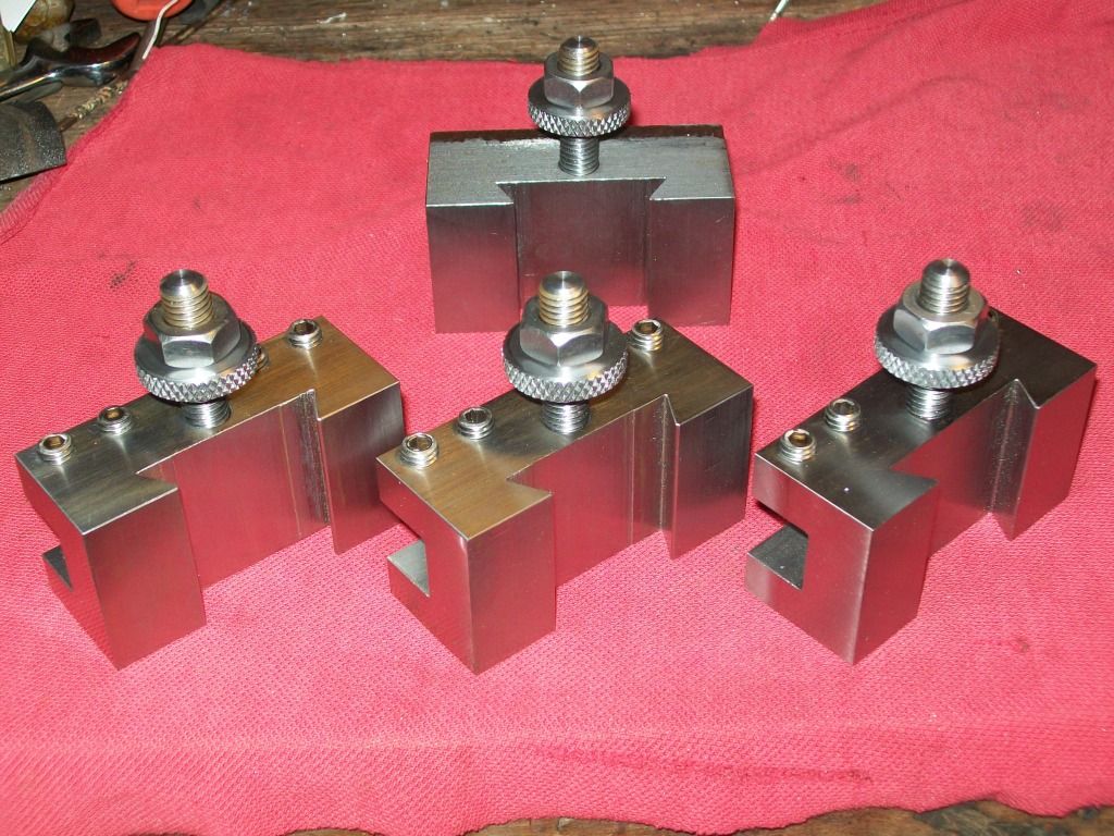

                      • Paul,
                        all very nice. I have the Polish Bison brand Dickson copy on my Boxford, and am in the process of starting to machine up a batch of 8-10 more toolholders. I want to do the whole lot of machining (bar sawing off) on my Boxford shaper. Some operations may be quicker on my Tom senior mill, but i still wish to do the whole lot on the shaper, especially as i don't want to buy t-slot milling cutters. They are an awkward shape, and much more complicated than the Aloris type you have. That is why i was contemplating purchasing just the Aloris copy toolpost and making my own tool holders. Probably at least twice quicker. The 100 series are more in keeping with the Boxford overall size.

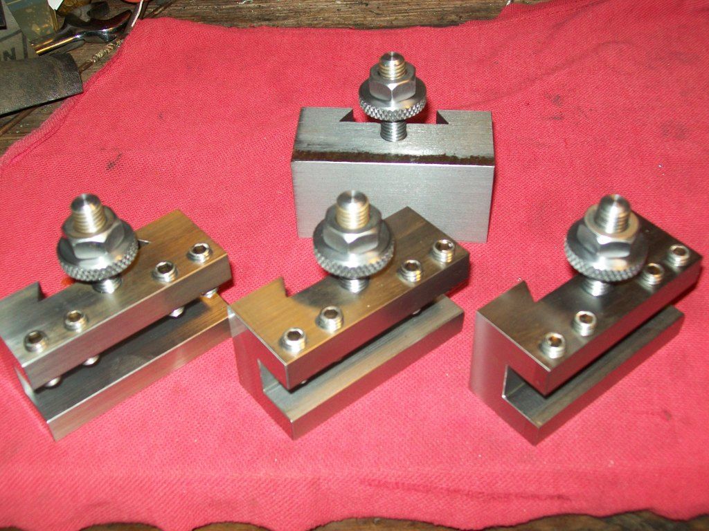

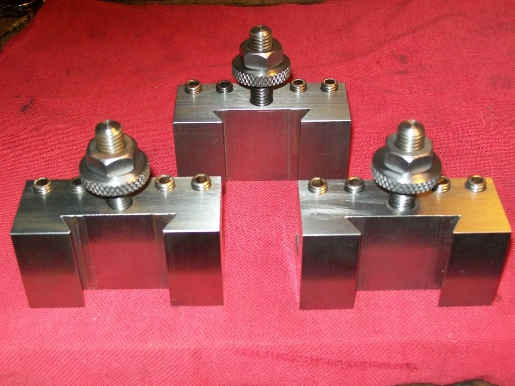

                        • Mike,
                          I have a Dickson clone on my ML7 the shape is quite complex which is one of the reasons I went for the Aloris type on the Boxford.
                          Cutting T slots on the shaper is something iv'e not tried yet but do intend to have a go at, making the tooling should be interesting with it's hinged piece, bit more research for me on that one.
                          I made these Aloris type holders almost wholly on an Elliott 10M:
                          The unfinished one was eventually made into a semi auto threading tool of the kind that John Moran (Bogstandard), John Stevenson and others designed.
                          Regards
                          Paul

                            • Paul,
                              using a shaper for those tool holders hence the lovely finish, which you just would not get with the mill. Yeah, as you say, complex is the word, Dickson vs Aloris type holders. The T slot tool for shapers is available to order from Cromwells etc as a butt welded HSS r/h or l/h wide grooving/cut off tool. Mine are all 5/8" square, with the shank thinned down to 7/16" to fit the Boxford.
                              • WoW and double WoW, nice to see some0ne's work who knows how to deep-knurl properly!
