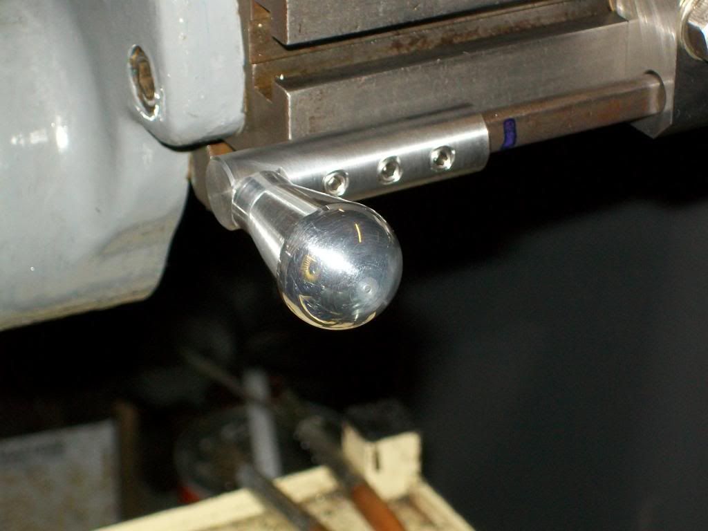

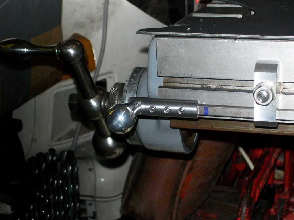

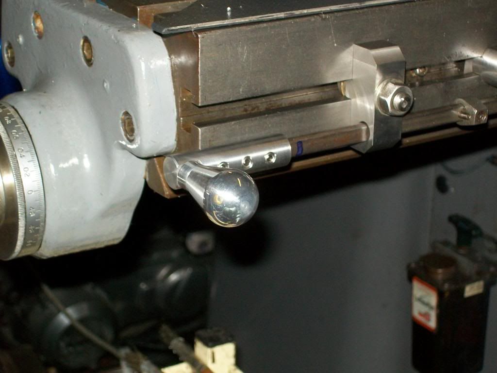

                          • I always seem to be at the wrong end of the Bridgeport's table when I need to stop the power feed, I have tried to grab the bare rod and manipulate that with varying results, so I made a second handle even tried to replicate the shape of the original handle.
                            Paul
